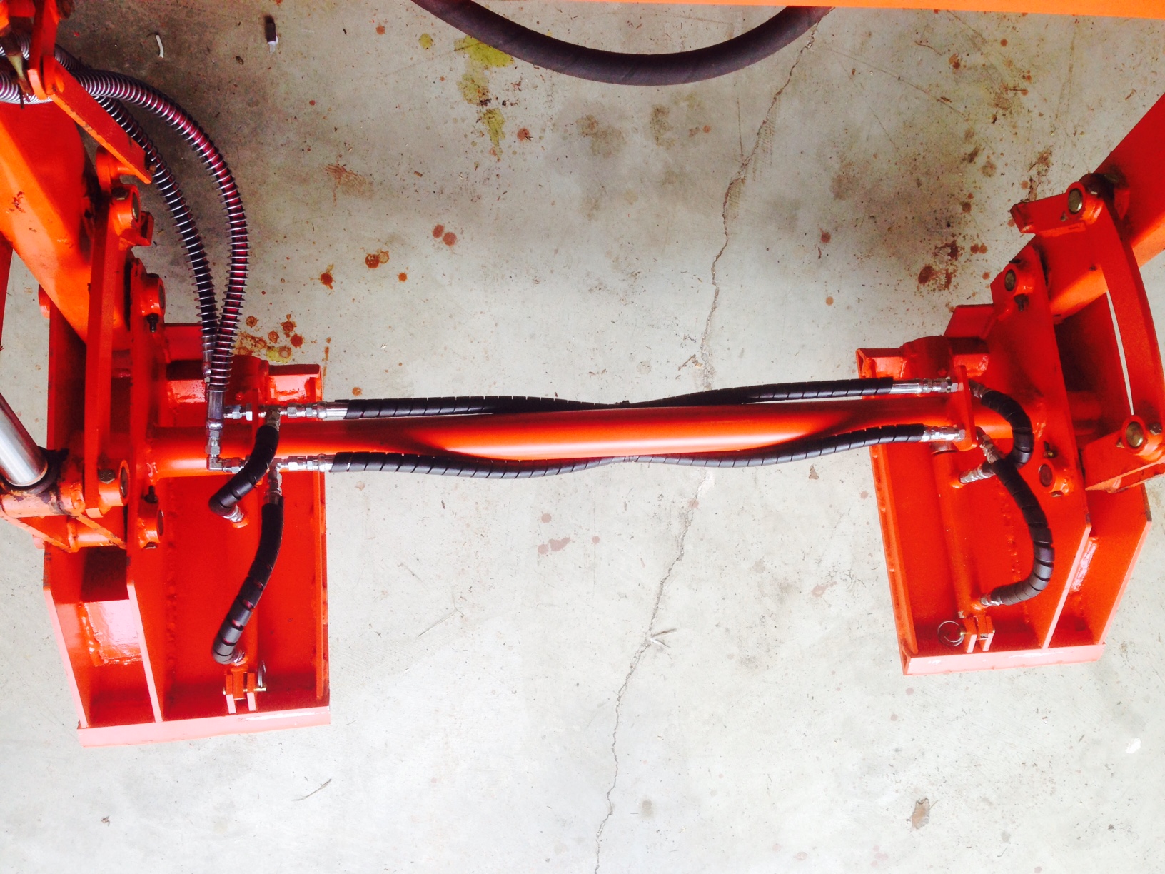

I made this quick attach for the B21 a few years ago. Hydraulic cylinders directly actuate the pins. It works fine but I wish I had thought of the indicators. Would have been easy to incorporate at the time but not easy at all to retrofit.
That's a pretty cool project. Great work! Very compact and light weight to not compromise lifting capacity too much. Everything stays out of the way and protected. Very nice!
/ Front Loader Quick Attach Automatic lock? #25
Thanks for the note. I had to build it from scratch and decided it was just as easy to go hydraulic as to figure out the rotating handles, over center springs, etc.

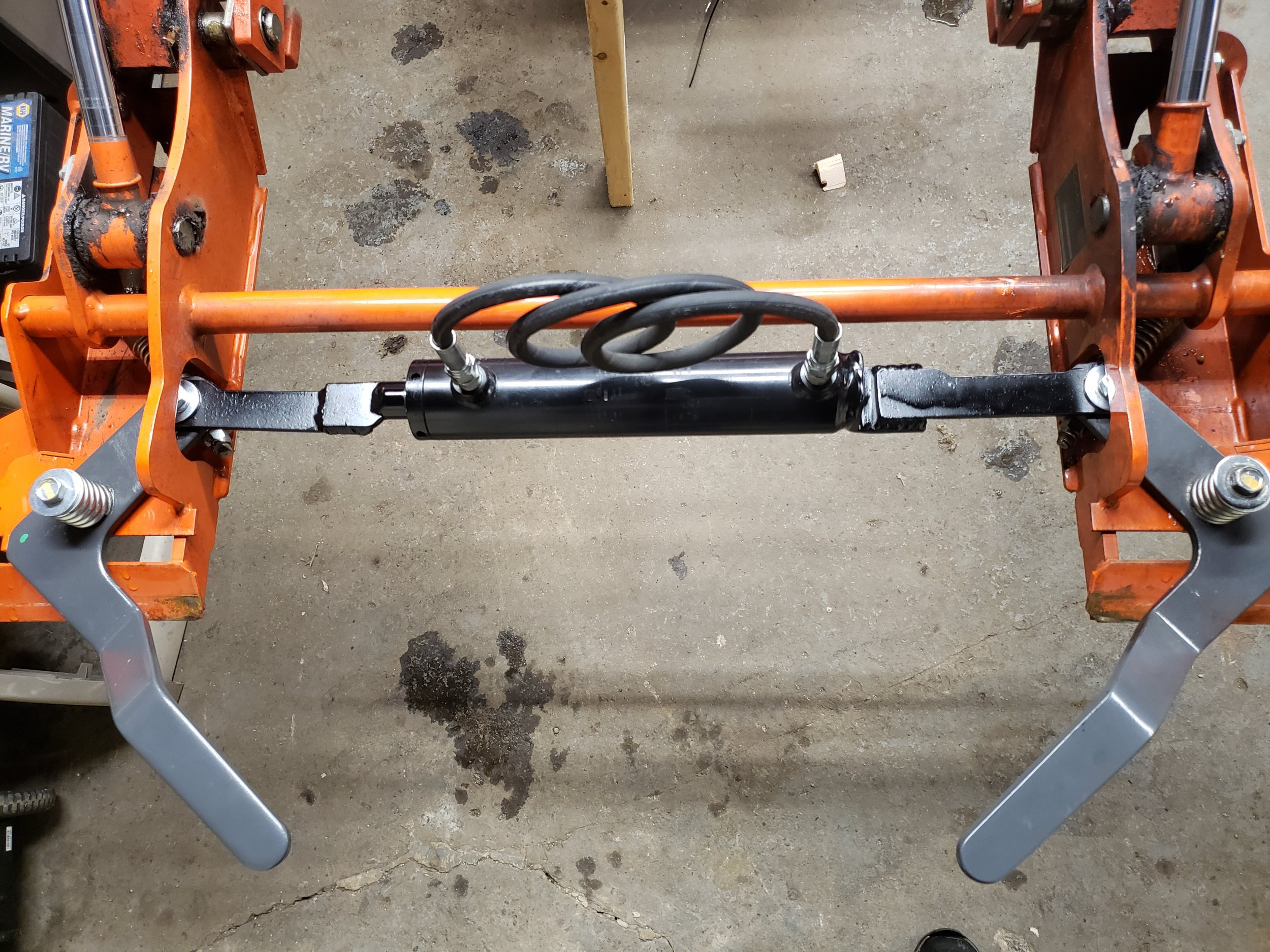

Looking forward to seeing Fallon's setup. It seems to me a floating cylinder between the two handles should be a great add on to any ssqa especially when the hydraulics are already on the loader.

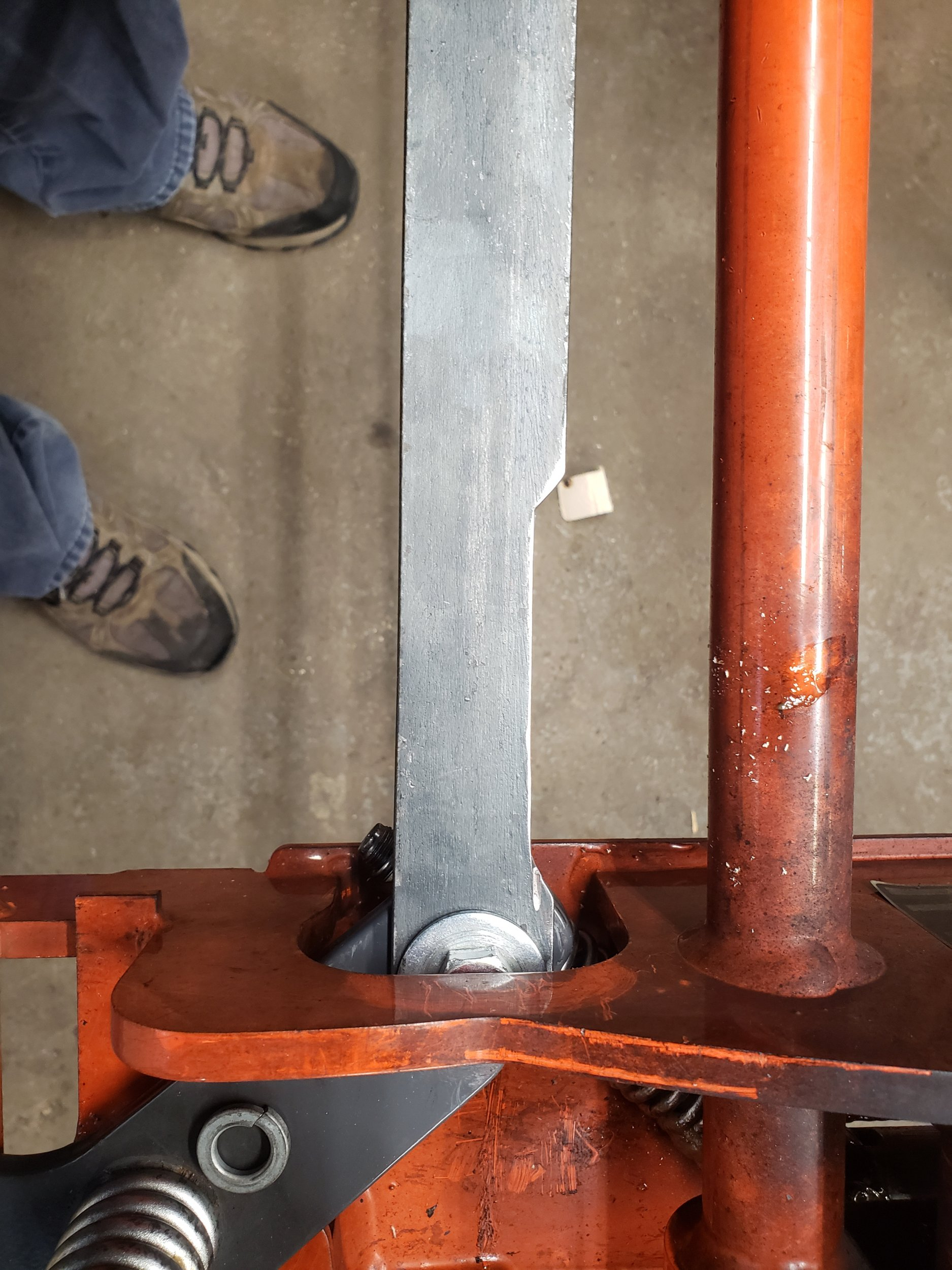

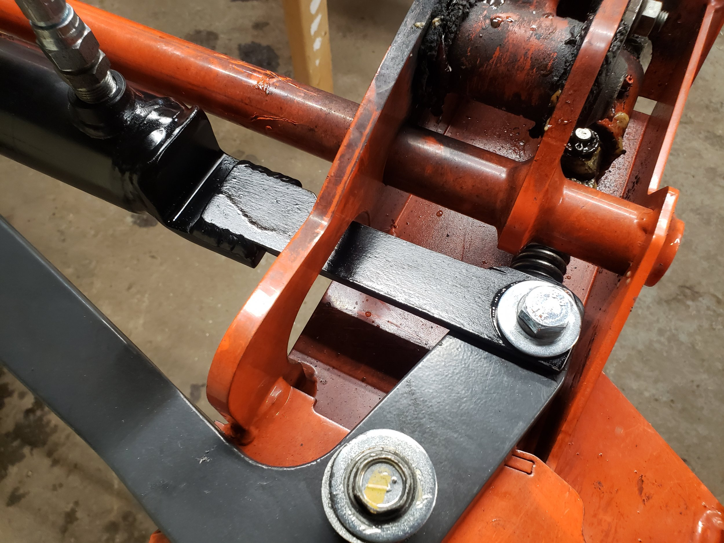

May be a little late on this but I just finished a hydraulic ssqa off my 3rd function on a B2601, here's a couple pics, video won't load sorry

Better late than never. :D
Looks good.
