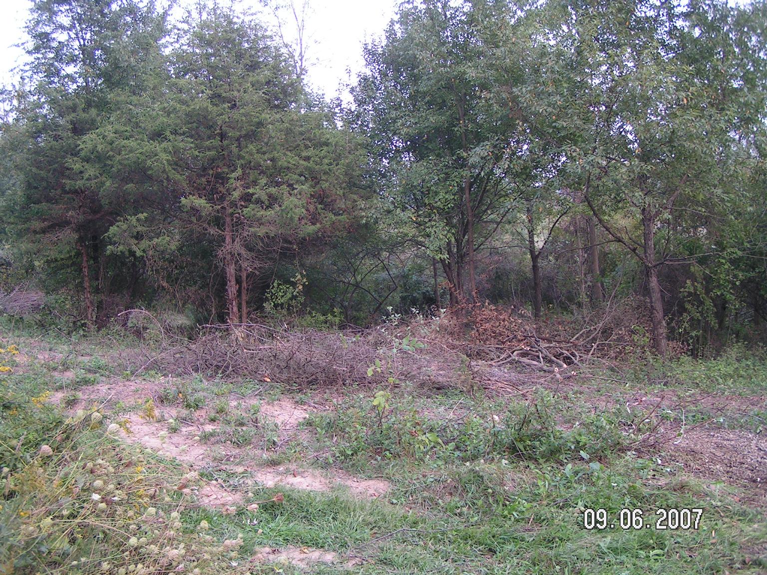

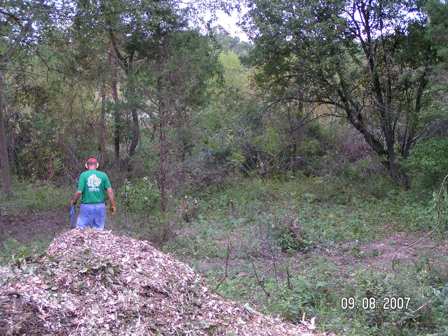

OK, we were able to get out there for a about 5 hours tonight. Got a bunch more chipping done and then decided we were beat so no time like the present to start stump busting.
The stumps actually came out easier than I thought they would. We were able to get a bunch pulled out and it was nice to see the ground actually cleared off. There are still the small stumps from the 1-2" trees, but not too bad I don't think.
Let me know if you think these are poison ivy.

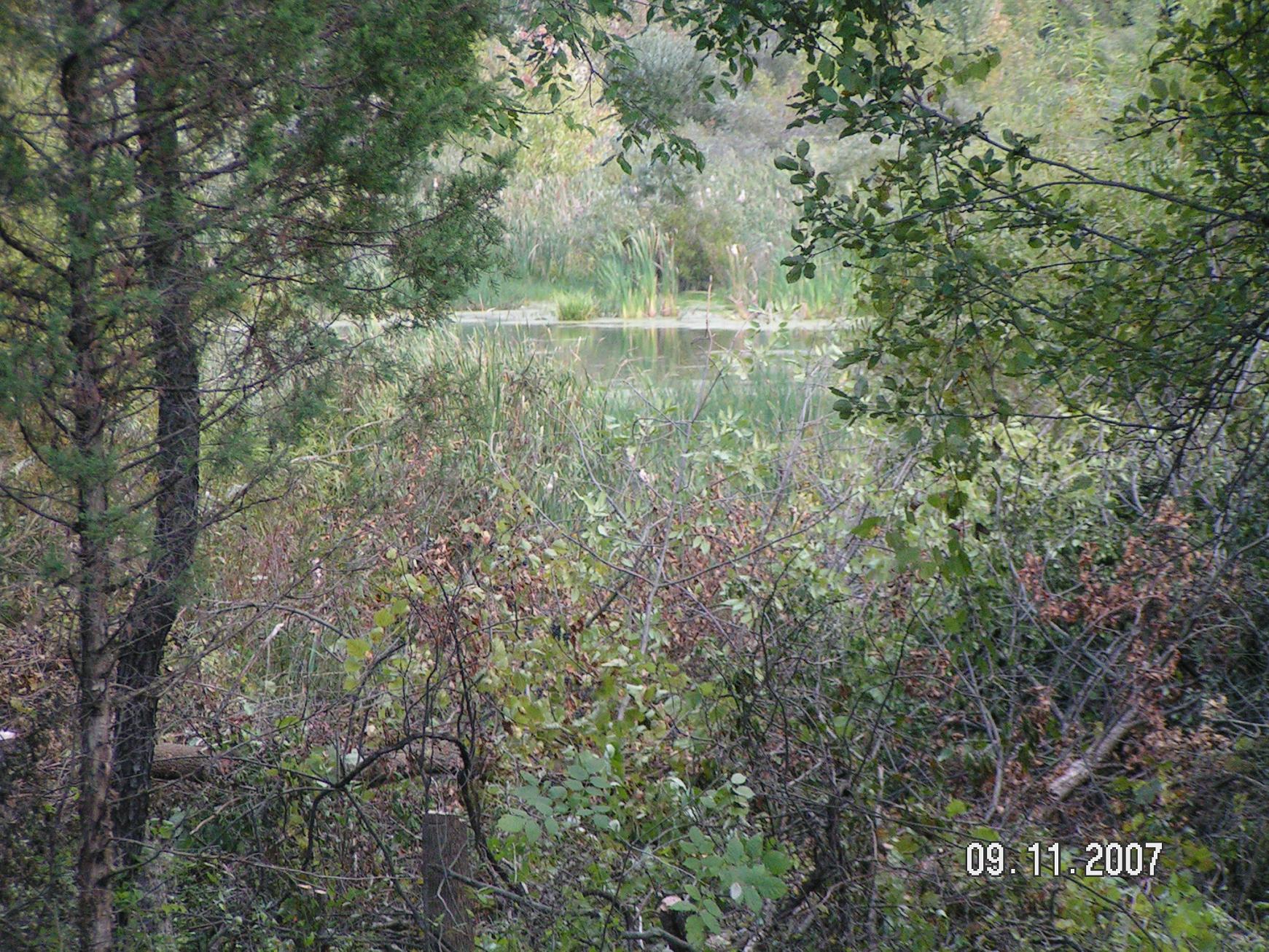

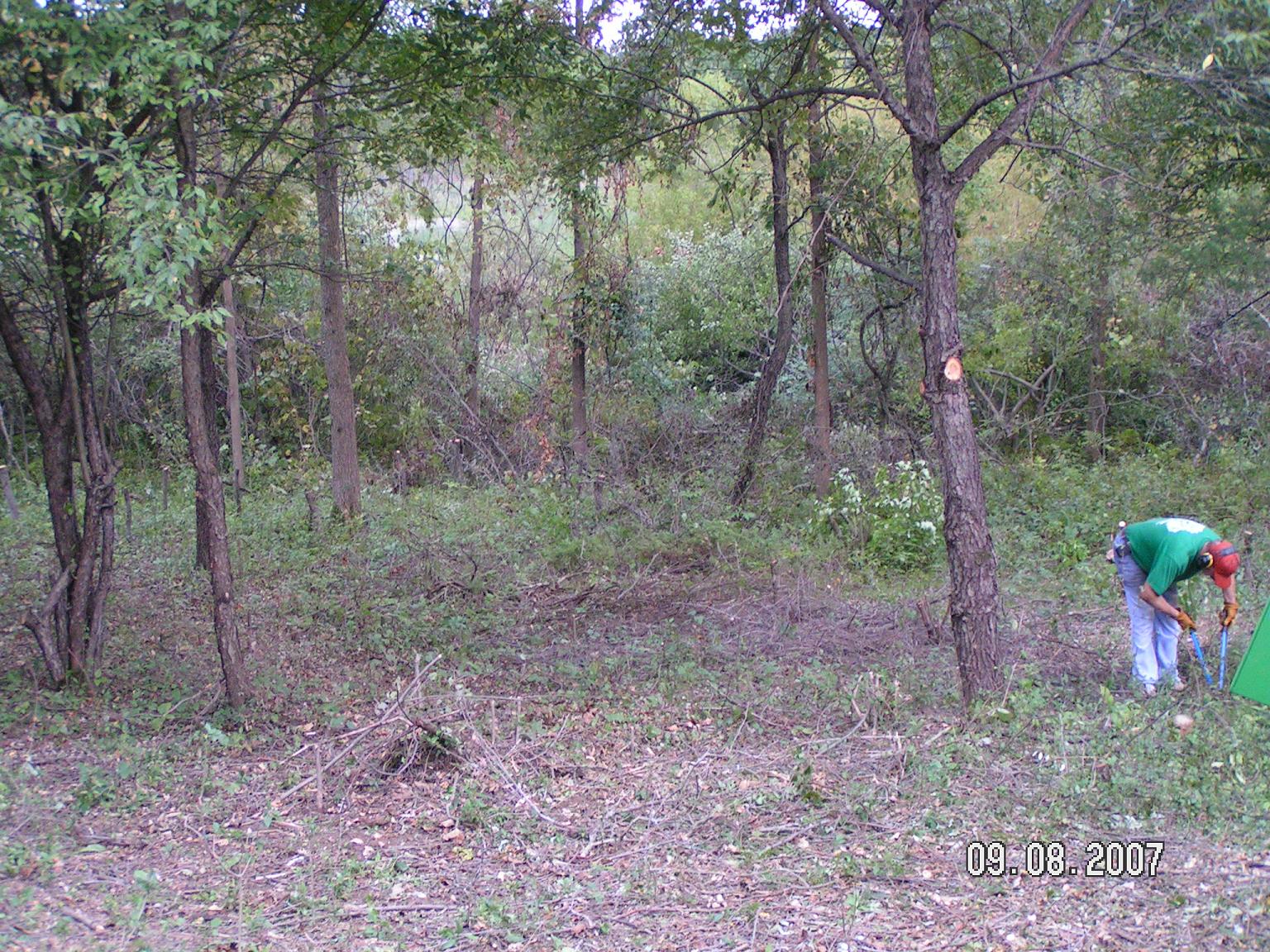

Got all the stumps out that we are going to this year out last night. Now we need to boxblade, disc, and plant.
Hoping to be done by early next week.
I will try to post pictures later today
/ From forest to food plot, suggestions?
#37

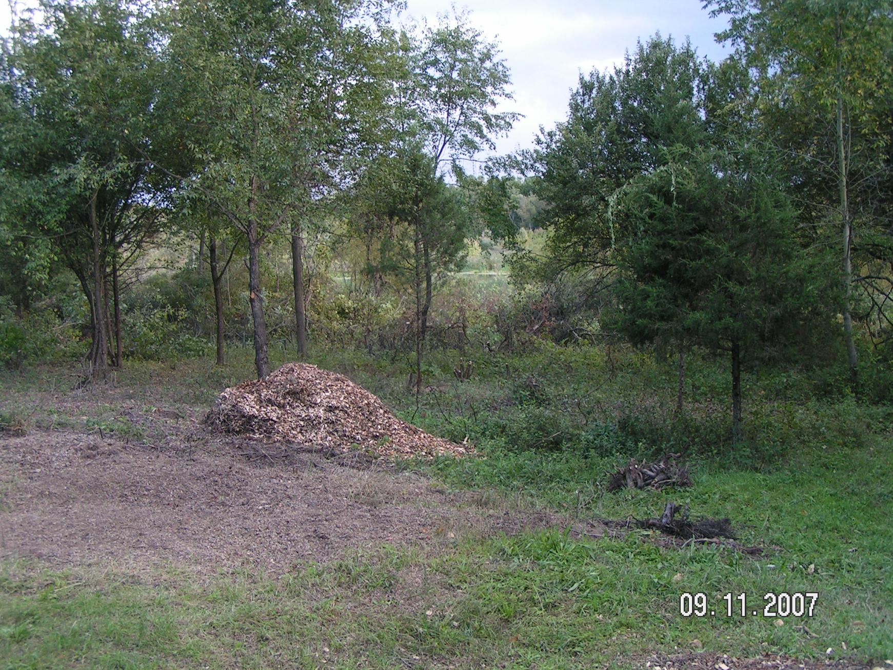

Here are some pictures from our most recent work. Have all the stumps out that we are going to for this year, need to clean it up with a brush hog/box blade and then disc and seed.
Eddie, you had asked about tree stands. The last couple pics are from one of the tree stands, you have to look through the brush in one of them, we will cut it down here quickly, and then we will move one more so that we can choose where we sit depending on wind.

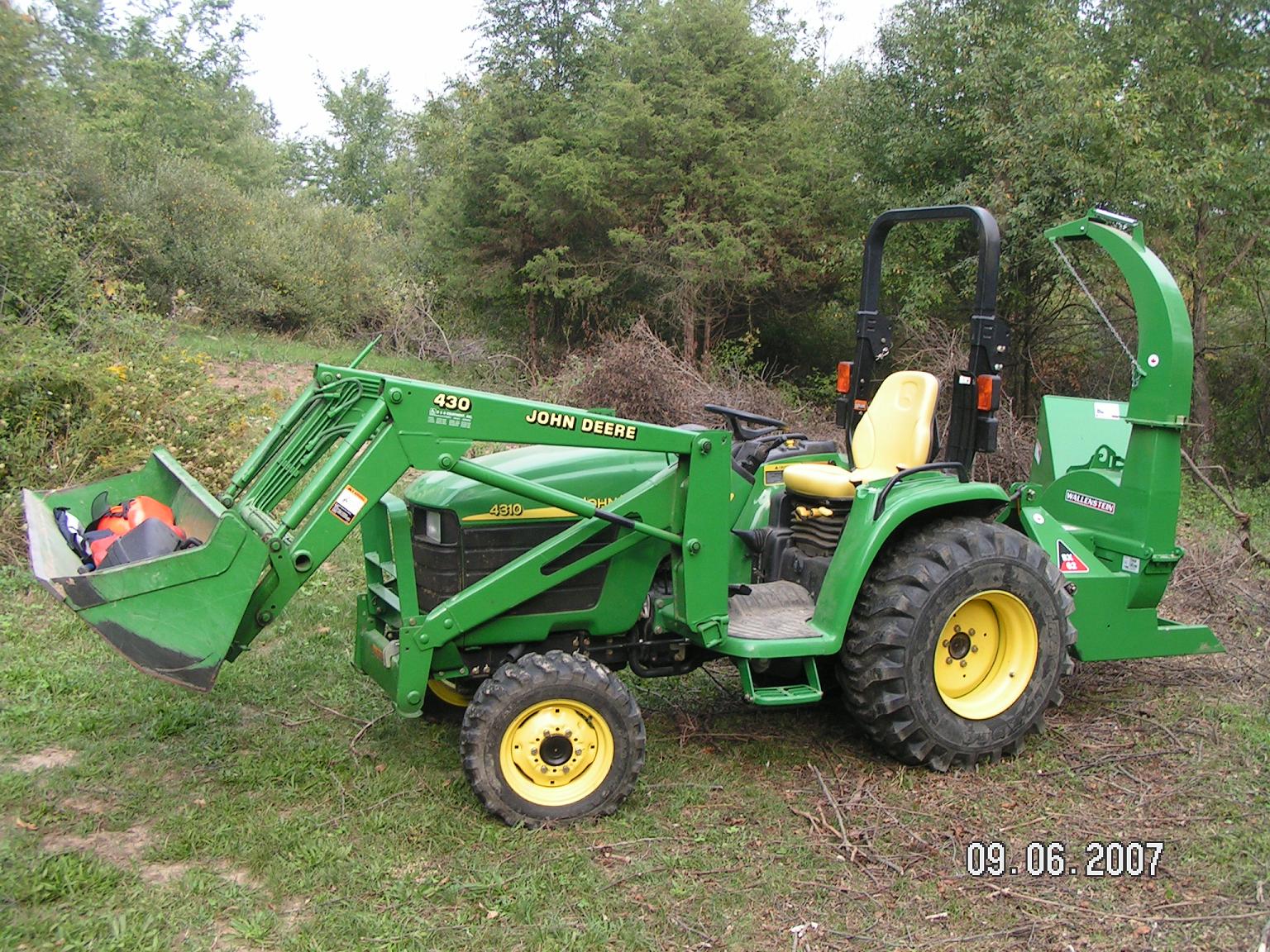

My dad is going to pick up a brush hog and boxblade this evening so we can star the next phase. Both International Machinery I believe. I won't be around this weekend, so
I am hoping he takes some pics for me to post.
