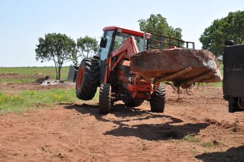

Many of the rocks were right at the max lift capability of my loader and several exceeded it. Note in one of the pictures that the tractor is on three wheels due to overload on FEL. I couldn't lift that rock any higher and had to leave it behind. I will get it today by putting it in first so I don't have to lift it so high. There are 5-6 or more rocks way bigger that I have to devise a plan to lift.

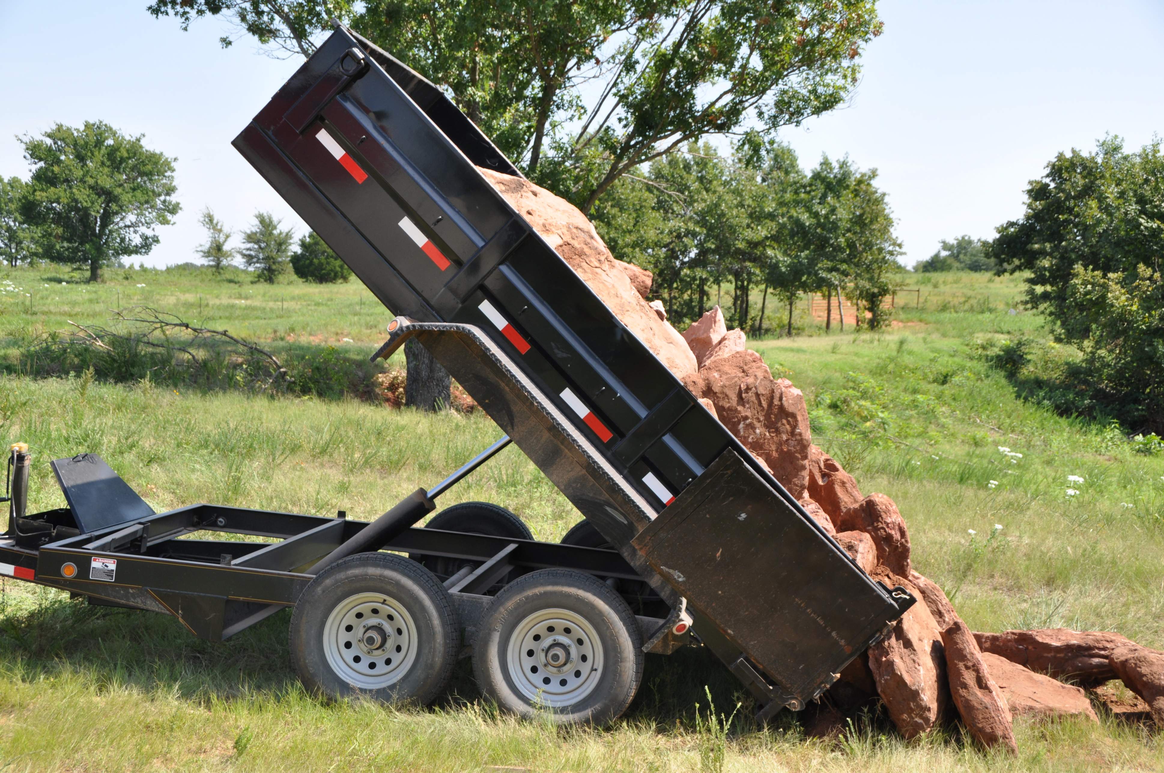

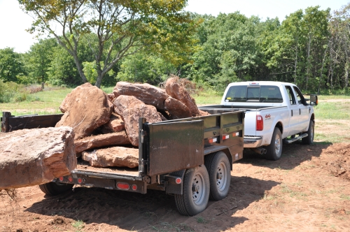

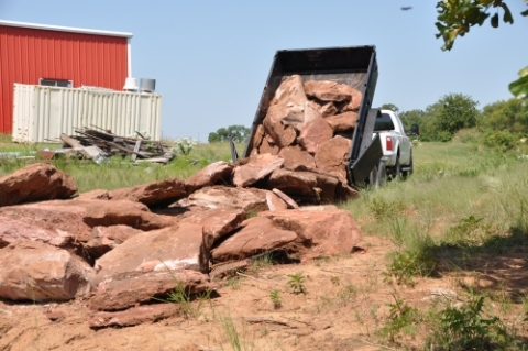

The other pix show the last load of the day and its being dumped near the first loads. A dump trailer is a wonderful tool. This one is only rated for 10,000 lbs and is easy to overload so you have to pay attention. The bhox is 7x12 and 2 feet high with stake pockets if you need sideboards to contain a larger load of lighter less dense material. The first 4 loads (got one load day before yesterday and 4 yesterday) averaged well over 1000 lbs per rock.

I'm open for suggestions on how to lift rocks weighing a ton or two to get them high enough to drive the trailer under them. I have a 12,000 lb winch and a snatch block to give me up tpo 24,000 lbs of pull. I can mame an A frame or whatever.

If you can tip the rocks then lift the box, tip a portion of the rock in, lower box some and try and lift/shove the stone a little more and so on.
#2
Dig [hole/build ramp] so you can shove rock into trailer box. Then find out the truck has traction problems pulling trailer from hole.
Invest in hammer drills, rock saw and wedges and feathers and reduce rocks to sizable portions. This may be the proper way; as, as soon as "She Who Must Be Obeyed" sees the ease with which you split rocks the landscaping projects will evolve to a whole new experience!:D:D
That one trailer load looks a little heavy!!:confused:

Egon (et al) I loaded the rock that had me on three wheels. I raised the dump bed a few feet to lower the rear of the trailer and put the ramps near the center on top of the bed. I couldn't get the rock over a foot in the air and totally stood the tractor on its nose a couple times trying to lift it. I got it over to the ramps and pushed it into the bed and lowered the bed. I then swapped the bucket for the pallet forks and proceeded to scoop up smaller rocks. Smaller as in no more than a few hundred pounds down to size of a football. Dumped that load and will go back this PM to get the tractor.
Egon it wasn't just that one trailer load that was a little heavy! They all were, all 6 loads.

All is left to do is to get the 6-8 remaining rocks that are too big by at least twice what I can pick up. They are significantly heavier than the one I loaded (put me on 2-3 wheels.) I'm guessing a timber A frame and winch to lift them into the air and back the trailer under them.

You got hydraulic jacks, start jacking up the rock slab and put some timber baulks underneath. When it's high enough back up the trailer and use some pieces of pipe for rollers.
That A frame sounds easy but what do you make it of and how do you figure out the capacity?:confused:
It's good to see the Dodge is still serving well.:D:D
If you had some type of three point attachment you might be able to lift one side to get blocks under the rock.:D
/ Free Sandstone Boulders #9
Chains to the three point, then lift it or skid it onto logs, then logs as a ramp to the trailer pulled on using the three point again --- slower but it works. You can also make a frame that goes on the three point and which you can chain the rock to -- you will be able to lift more that way than with the loader -- probably safer too:eek:

Love Pic#1 :D Coudnt tell from the picture, but i dont see any wax on your tractor:D

Egon, Studor, Scooby, et all... Thanks guys for the ideas. Using the 3pt because it is stronger is a good idea.
Regarding the A frame. There is a lot of timber on the property and the owner has flagged several trees (many are good straight oaks) to be removed and they are mine for the taking. Although as Egon suspects, I don't know enough to make close calcs as to strength of materials, I am no stranger to vector analysis and do know if I over engineer the scantlings sufficiently it will not be a problem.
I kind of like the A frame idea or even a tripod. Long logs lashed together at the top of the "A" or tripod with the winch cable passing through a sheave (snatch block) affixed to the top of the A or tri and then down to the rock. Reel in the winch line and SHAZAM! the rock goes up vertically, high enough to back the trailer underneath. It requires two people to be able to get both trucks on site and a second person to help when erecting the tripod would be handy.
Not that the 3pt isn't a good idea but my tractor is small and the rocks are really heavy as in several thousand pounds (a couple tons at least) and some are larger. If I could lift one side, put cord wood under, lift the other side and put cord wood under, lather rinse repeat... until rock is higher than trailer bed and then back up the trailer till the rock overlaps the trailer bed a little and then...??? Try to push the rock onto the trailer? Use winch to try to winch the rock onto the trailer? This may be as good or better than the A frame or tripod, just not as nifty looking in the inevitable photo documentation.

Logs equals levers plus downward push with a loaded bucket gives more options.:D:D
/ Free Sandstone Boulders #13
When I recently had to move rocks that were located too close to the barn I rediscovered the old principle of "easier to drag than lift .. ". If you can find something to use as a ramp you will be amazed at how easily those rocks will slide into the trailer --:) JMHO
