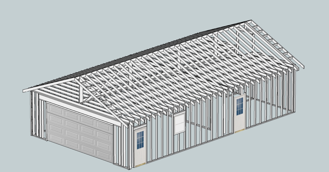

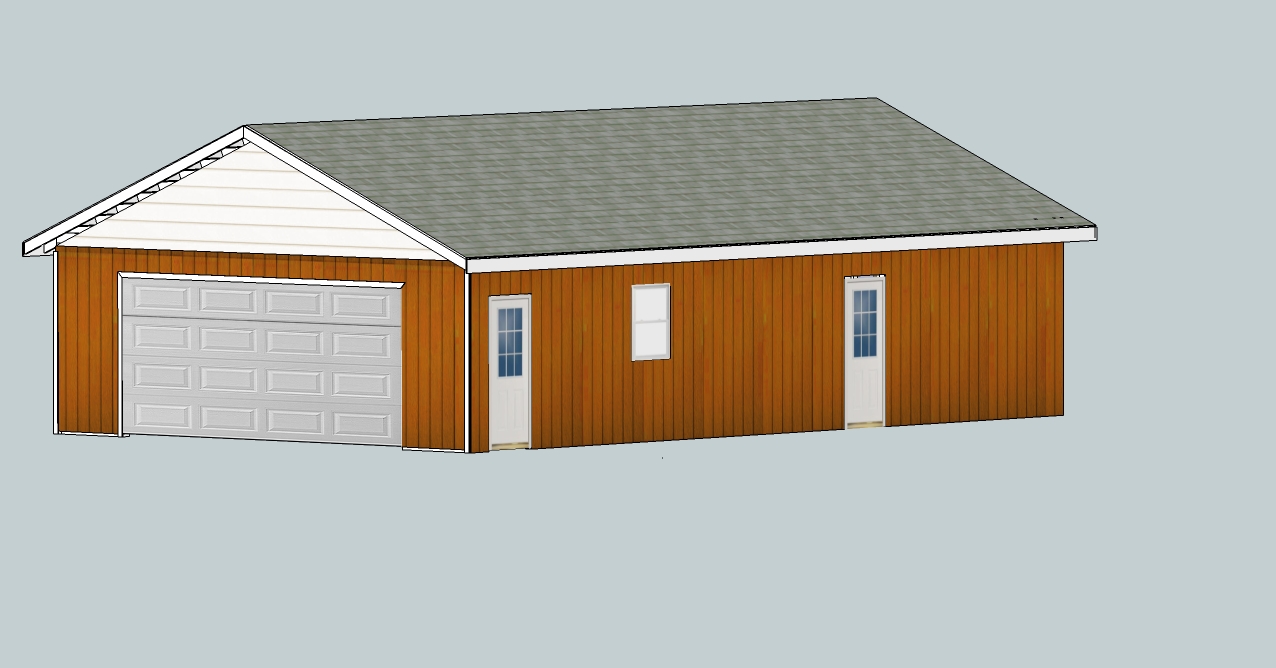

Another vote for Google 'SketchUp". If you do want to try it, please first follow the tutorials and within a couple of hours you'll be amazed at what you can do. Attached are a couple of .jpgs of a garage/workshop I'm building, as you can see framing is easy and you can also add text and dimensioning, which is absent in my drawings, but I wanted to post before you made a choice.
Ray
raykos,
That is amazing to me! I've tried Sketchup and took the time to go through the tutorials, but never could figure out how to build stud walls, repeating on center, etc.
your drwaing is exactly what I was trying to accomplish. Is there an area of Sketchup that is easier to use for studs, rafters, or general framing? Maybe it's improved since I tried it.
Thanks.

I used the 'HelpCenter' and looked up 'Array', which is about the 'Move/Copy' tool. But, if you want to, send me a PM and I can explain it a little bit more.
Ray
/ Framing - DIY Software #29
Thanks Raykos. I looked at a few of the tutorials and noticed they are much better than when I first tried this years ago. Or it could be that I am more familiar with the basics so it is sinking in this time. Between the Components, Array, and Move/Copy functions, I think I can accomplish what I was hoping to do.
