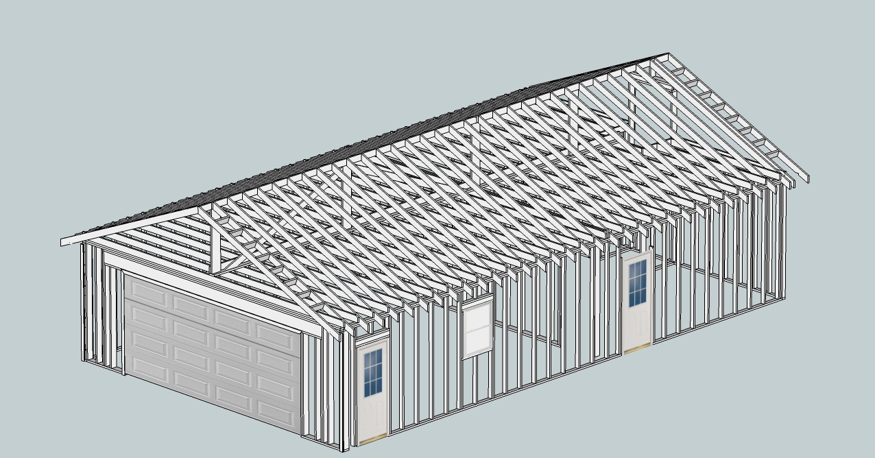

Another vote for Google 'SketchUp". If you do want to try it, please first follow the tutorials and within a couple of hours you'll be amazed at what you can do. Attached are a couple of .jpgs of a garage/workshop I'm building, as you can see framing is easy and you can also add text and dimensioning, which is absent in my drawings, but I wanted to post before you made a choice.
Ray

raykos how did you save your sketchup as a jpg? I have a few I sketched up of the room addition that we added on. 500 sq ft and the county permit office excepted them without question once they looked at the print, all done in sketch up for free, granted there is a learning curve but its a fun program to mess around with.
/ Framing - DIY Software #20
raykos how did you save your sketchup as a jpg? .
Go up to, File->Export->2D Graphic->Export type(.jpg)->click on Export; this will save whatever view you have of your project on screen as a .jpg.
Yep, "SketchUp" is neat, & the best part, it's free. Another good Cad type program is "TurboFloorPlan 3D Home & Landscape Pro"; www.CadCourse.com, for around $70. It has a little steeper learning curve, but it's great for showing what the end result should look like because it has a more realistic feel than the free version of SketchUp. However, SketchUp is great for showing front, back, left, right, dimensions,etc. in order to obtain buiding/zoning permits...allowing you to build something bigger & better for your tractor(and stuff)!
