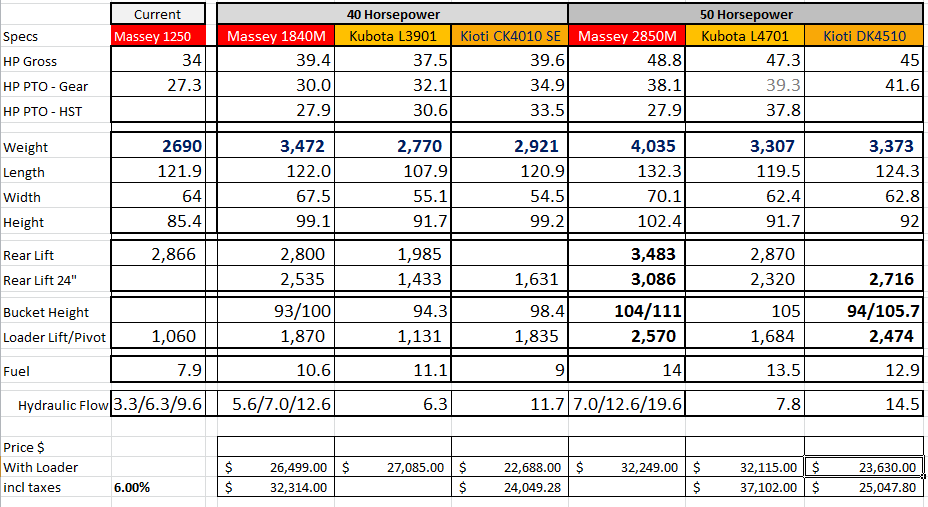

I created a spread sheet with the most critical specs and prices. I started out with more manufacturers and models but removed some as I whittled them down. Had pretty much settled on Massey until a neighbor suggested that I look at Kioti. After researching, much of it on this forum, I decided on the DK4510. Not shown are the John Deere offerings as well as other Kubotas and NH as they were eliminated.

When considering a tractor purchase bare tractor weight first, tractor horsepower second, rear axle width third, rear wheel/tire ballast fourth.
Depends on the use. For example PTO power is often under rated as a screening criteria, even by folks who think a primary use for the machine will be brush hogging. The spreadsheet above gives a great example with the heaviest tractor giving (potentially) the lowest PTO output compared even to smaller engine HP units. I wish people thought more about that when considering HST/gear options but it's rarely used as a consideration.
I think FEL capacity is also over and under rated as a screening criteria. Also a good example above with on tractor advertising a FEL with a capacity that is more than 3/4 of the bare tractor weight, hardly a good idea. On the other hand the 1,000# FEL capacity is kind of a threshold a lot of folks view as what you need to handle round bales, sure it might lift a 7-800# bale but do you really want to be carrying around 80% of your capacity for the majority of the time you use it? Probably not, I like to keep the loads below 50% if I can just to be easy on all the pins.
I like to think about ballast as a stability bonus not necessarily as a tractor weight bonus (as it applies to lifting things, for ground engaging use it's absolutely a great way to get more capabilities but so few folks seem to do real ground engaging work with the smaller tractors).
A clear exposition. Others would less often trade in 100 engine hour tractors for replacement tractors more in line with their needs if they went to the trouble of spreadsheeting.

Thanks, Jeff. Not mentioned in original post, cost was also a factor. I really wanted to keep total cost ~$32K including add-ons. I was amazed at what I was able to get for my money once I selected the Kioti. I was able to add third function, a grapple, dual rear remotes and many other upgrades like floor mat, arm rests, telescoping links, and still pay for a Land Pride RCD1884 dual spindle cutter for less that the "tractor only" prices of my original top 2 choices. The goal of the spread sheet was to weigh "must haves" with "nice to haves" and I was actually able to get both. This forum was an excellent resource to help form these decisions, thanks to all that contribute.

That's one way of doing it. I had a 34 HP MF tractor that I had for 27 years and wanted a newer one. In the 27 years of operating that smaller tractor it became obvious that I should have bought a bigger tractor. While deciding what to get, I was bouncing back and forth between brochures and web pages comparing. The spread sheet was to make it easier to compare side by side. I don't know about you, but $32K is a lot of money and this is probably my last tractor purchase. I wanted to put a little thought into it. Over thinking? Maybe, but this forum provided many things to "overthink" about before committing to a large purchase. I am grateful to those that contribute valuable knowledge.
