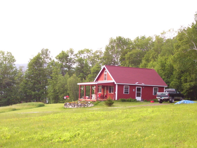

Your about 100 miles north of me so I could see where you need to go 5ft deep. When we put our front porch up I dug four post holes just over 4 ft deep for the sonotube. I was told frost could possibly go 4ft deep here. That was a few years ago and havent had any movement yet ! :)

And a fine looking porch it is. Curious as to the size of your house. The plans I'm hoping to build are a 24' x 24' "high post" cape. All I have is are the timberframing plans so looking for ideas as far as room layout. You would think with all the plans available online I would be able to find something with the same dimensions but it is surprisingly hard.
