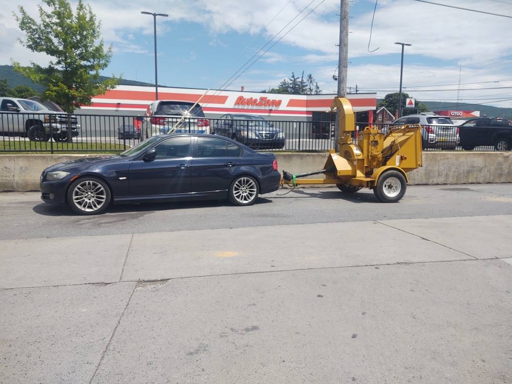

Last week I found a BC906 listed in central PA. I was already going to upstate NY for a friends birthday party so the 3 hour detour worked perfectly. He was the original owner and was retiring from a landscaping business. He gave me all the manuals, spare blade set, and even a VHS safety tape haha.
The only oddball part is he had the dealer mount it on a trailer so he could just pin it to the draw bar instead. It worked perfectly for me picking it up though as I just bolted a 2" coupler onto the channel mount and it saved dragging an empty trailer on the way out. I'll get it cut off this week and turned back into a 3pt unit.
Just in case there's any towing safety police here, the hitch on the car is the factory euro hitch rated for 4klbs, car has helper bags in the rear coils, it's a tuned diesel that makes 600lb/ft at the tires, has larger brakes than a pickup truck, safety chains were hooked up, and magnetic lights were installed on chipper. Averaged 21mpg at 70mph with the cruise set on the freeway. Was comfortable as can be.

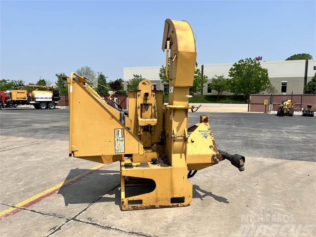

Here's what the 906 normally looks like without the trailer option.

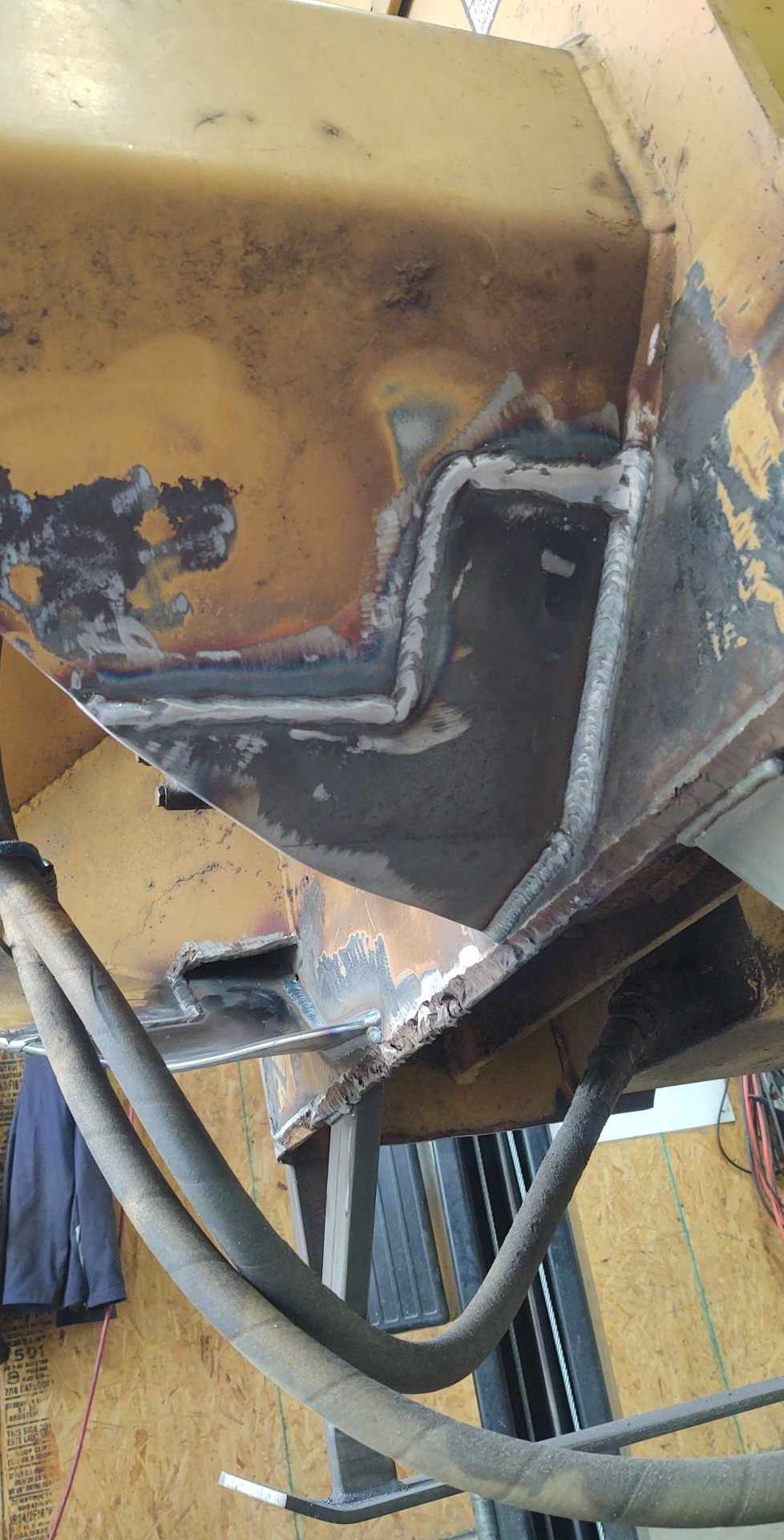

I got a ton of progress done today! The plasma cutter made quick work of the crappy stick welds and it was free of the trailer in about 15 minutes. Before I started making anything, I did hook up the tractor and make sure it would actually lift it. At idle it will pick it 80% of max 3pt height, rev it up to 1500rpm and it'll go to the top. I proceeded to make the new feet and clean up other areas. Templates are made for the pieces to fix what was cut out on the 3 point mount structure and that's tomorrow morning's project. Should be done in the afternoon!

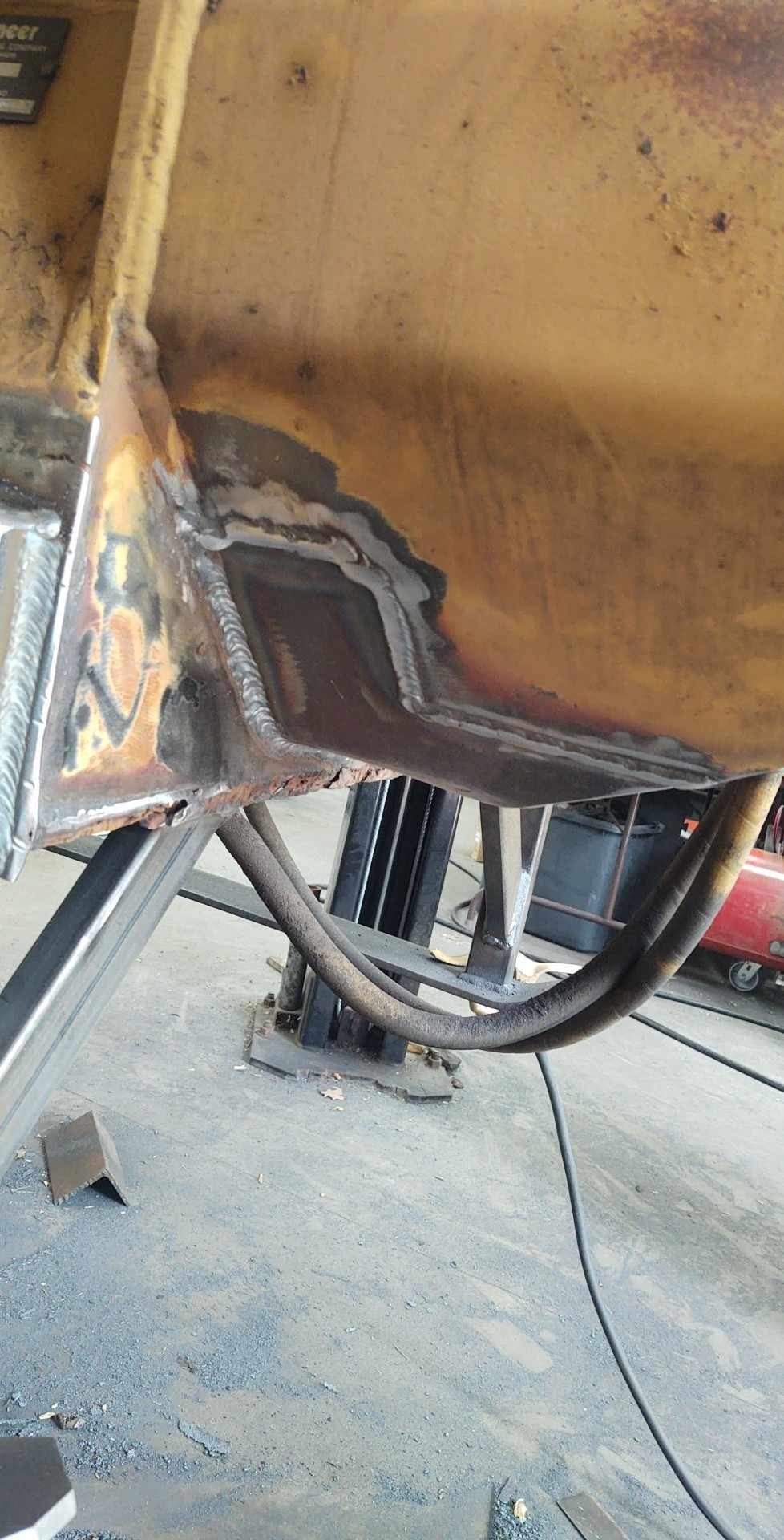

Got the last pieces welded in today at the bottom of the hitch structure and 2 coats of cat yellow put on. As much as I wanted to repaint the whole thing, that'll have to be a winter project when I don't need it in a couple days. I've got a dead oak that needs to come down so I'll give it a proper test this week :).
