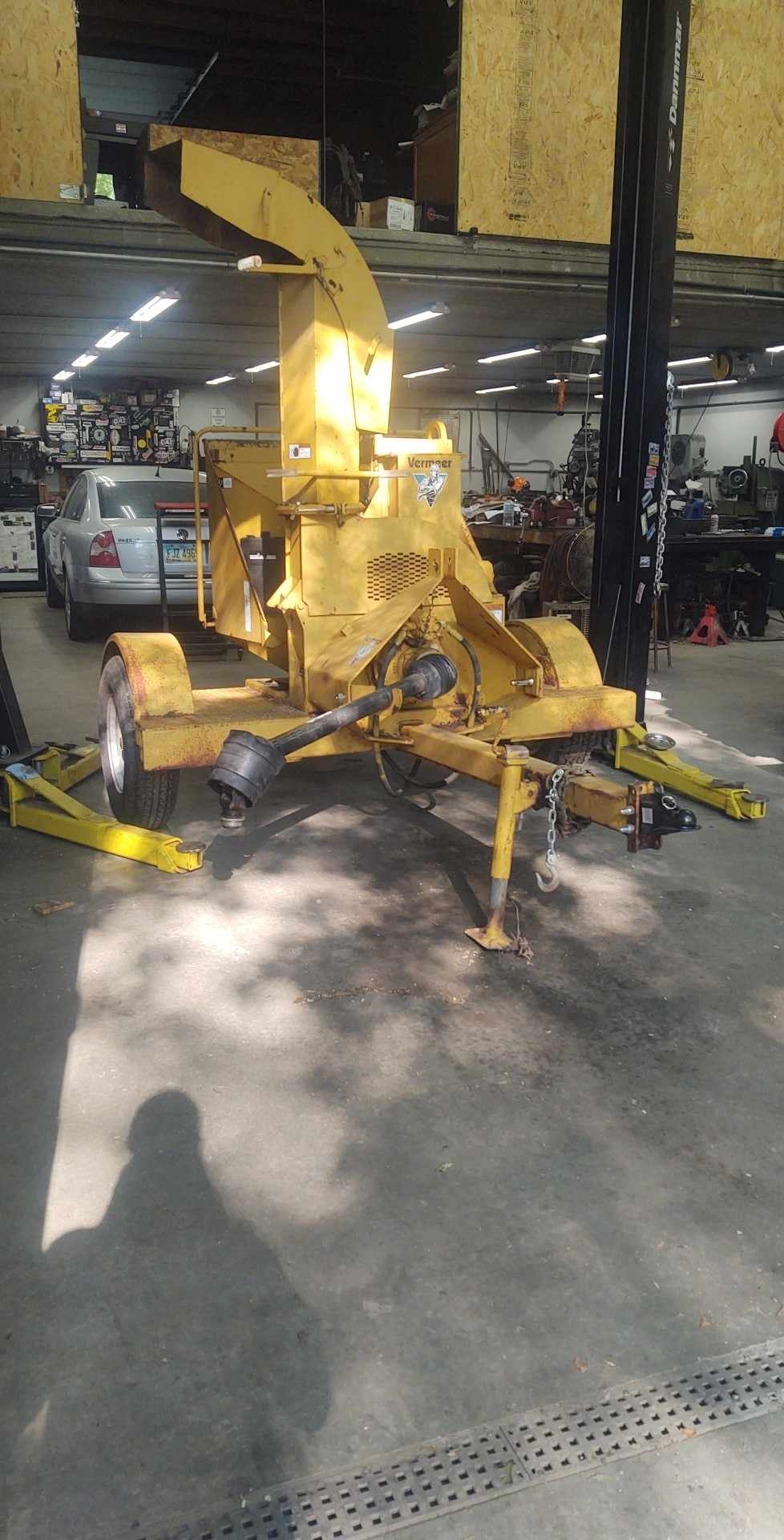

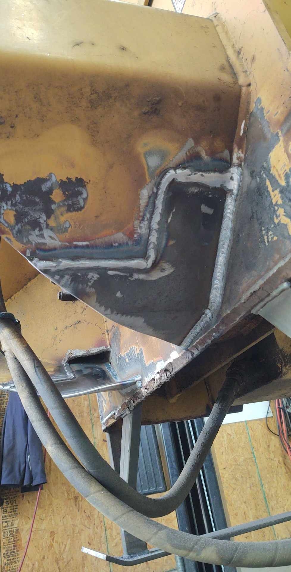

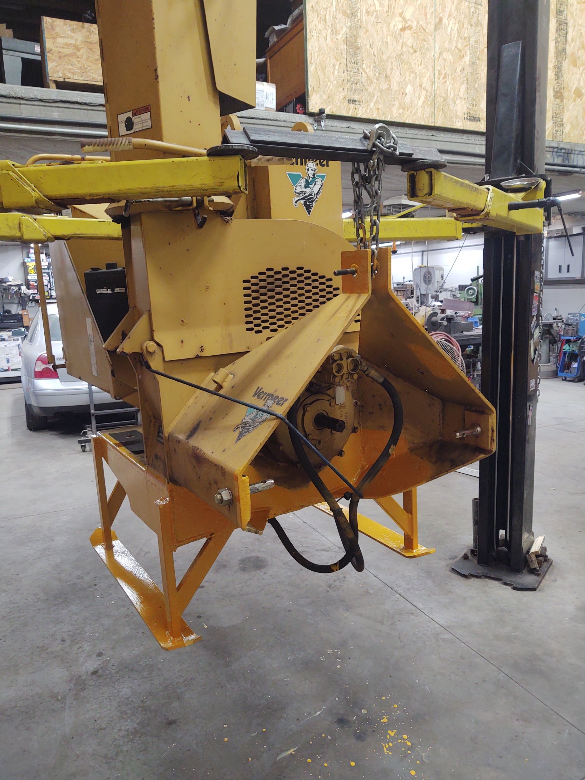

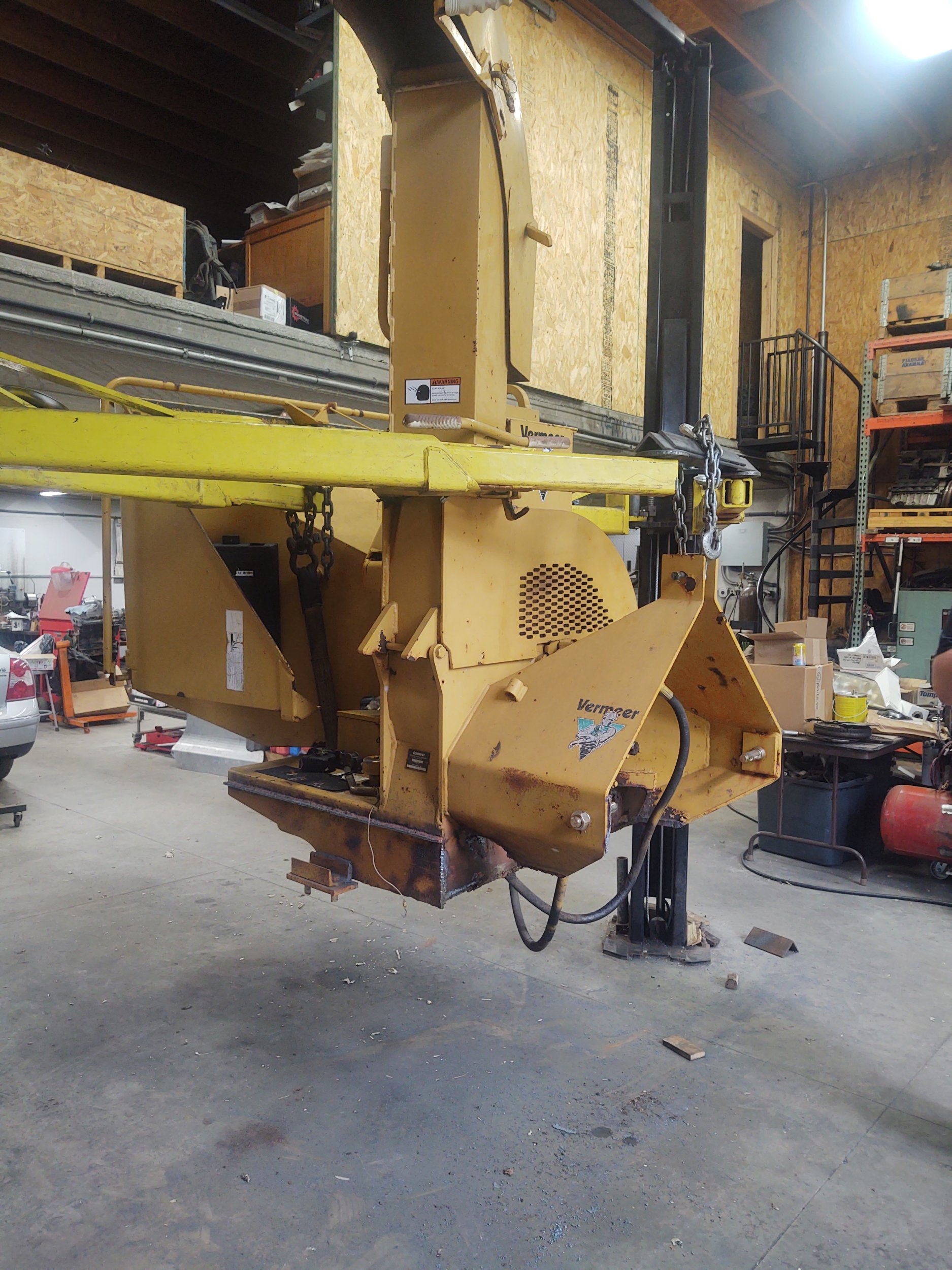

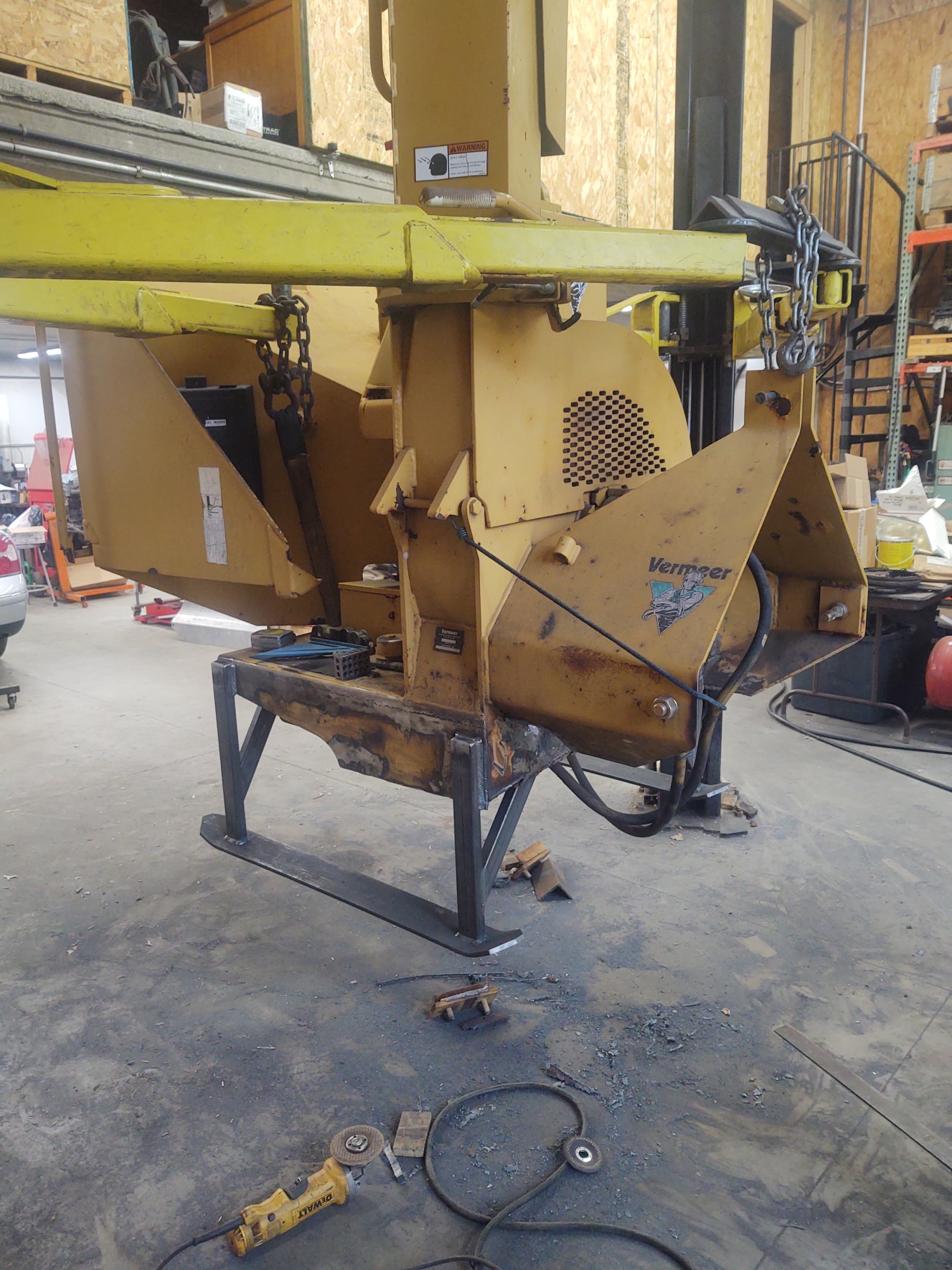

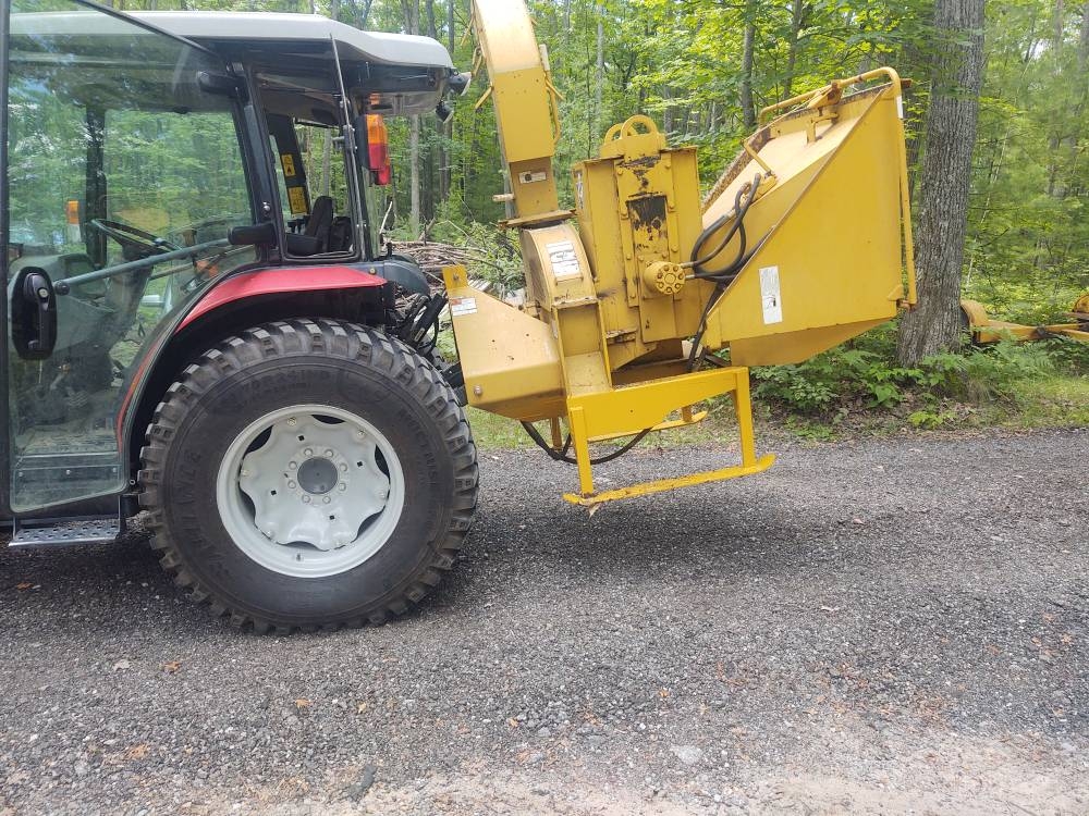

I got a ton of progress done today! The plasma cutter made quick work of the crappy stick welds and it was free of the trailer in about 15 minutes. Before I started making anything, I did hook up the tractor and make sure it would actually lift it. At idle it will pick it 80% of max 3pt height, rev it up to 1500rpm and it'll go to the top. I proceeded to make the new feet and clean up other areas. Templates are made for the pieces to fix what was cut out on the 3 point mount structure and that's tomorrow morning's project. Should be done in the afternoon!

Got the last pieces welded in today at the bottom of the hitch structure and 2 coats of cat yellow put on. As much as I wanted to repaint the whole thing, that'll have to be a winter project when I don't need it in a couple days. I've got a dead oak that needs to come down so I'll give it a proper test this week :).

I just gave it a proper test and I'm thoroughly impressed! I took down two ~12" dead oaks and chipped all the brush up. I ran the feed as slow as it would go while still having power to pull stuff in and left it there.
Even being ~15hp under the recommended minimum, the only time it pulled the tractor off max rpm was on a 5" at the butt limb about 15' long. It dropped to 1900-2000 rpm and chewed right through it. Being used to my woodmaxx, i couldn't believe how it folded gnarly/twisted limbs and pulled them in. I didn't trim a single thing after cutting it off the trunk. I'm 110% happy and can't wait to see how it runs with ~50 pto hp after the tractor mods!

By the way, is that max 3-pt lift height in your pic? Hope it doesn't scrape too bad when you try to drive on/off your gooseneck.
That was max lift height at the moment of the picture. The 3 point lift links that run down to the lower arms were at their longest possible setting. I moved them to their shortest possible setting after taking the chipper off, so it should go substantially higher now :).

Took advantage of a 20° cooler day than yesterday to get rid of some poplars in odd places. This was 5-6" at the butt and feed set as slow as it goes, ran it much faster when doing the brush.
With the 3 point lift rods moved it does pickup substantially higher also.
