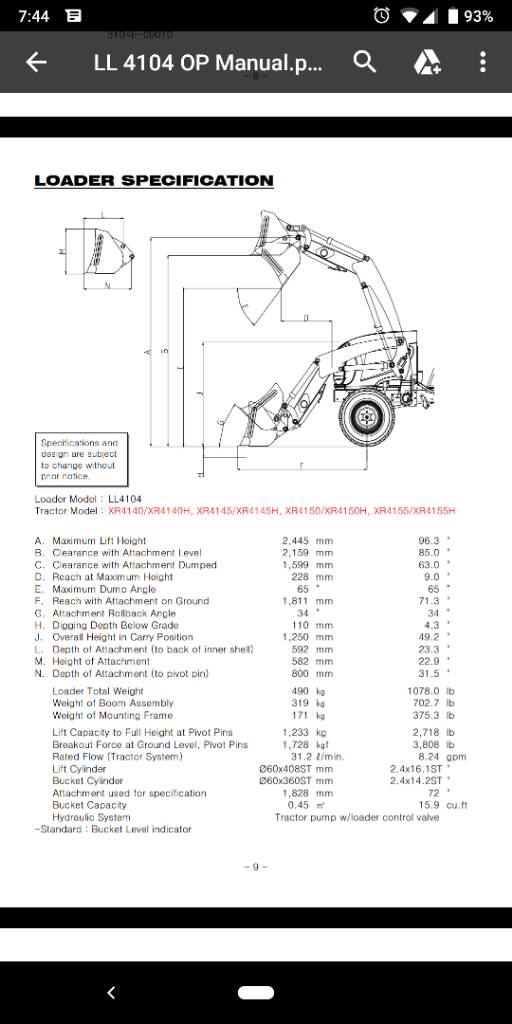

So just my observation, but when it comes to loaders I'd say the size/width/capacity of the manufacturer's standard bucket (as sold with the FEL) speaks volumes about the practical lifting capacity of the tractor/loader combination. From my own experience the (ROPS version) L3560 equipped with a L805 loader, the standard square back 72" bucket, and a 600-700lb box blade on the back for ballast will handle heaped buckets of crusher run without a problem. A cabbed version should do even better given the additional weight provided by the cab.
As far as power concerns, it's probably going to come down to the PTO usage as I've usually run out of traction before running out of power when pushing/pulling on things (the few times that wasn't the situation was due to operator error). So depending where you are in NY and what type of snow you're dealing with (as far as moisture content) the PTO output *might* be a concern (haven't used my L3560 for snow removal). Of course, I'm also of the opinion that if snow gets wet enough, and deep enough then snowblowers become inefficient and utterly useless anyway -- so at that point loader lift height, and reach become more of an asset. (just as a quick aside: while I now live in Alabama, I grew up in rural central Minnesota so I'm more than a little familiar with snow removal, and dealing with with everything from light powdery snow to near-slush falling from the sky.)
Having said all that, I'd also concur with the comments that the parts and service quality should be a serious consideration as all complex machines break down sooner or later (no matter what color they were originally painted).

One other thing to consider on the PTO power is the width of implement required to cover the tractor's width.
For example, the way my L3560 is set up 6ft implements cover the width of the tractor (with about an inch to spare on either side) which means I have roughly 28hp to cover 70"-72" of needed working width (which equates to 4.67HP/ft available from the PTO..or ~2.5 inches for every 1 PTO horsepower). A larger/wider tractor many have more raw horsepower, but it could also require a wider implement to cover the width and as a result the tractor actually ends up with less hp/foot available for PTO implements.
On the other hand draft-style implements are more dependent on tractor weight as all the HP in the world doesn't mean much if the tractor doesn't have the weight/traction to effectively transmit the power to the ground -- and while it's ideal to have both power and weight it often seems like utility tractors (to include compact, and sub-compact ones) are optimized for one or the other in order to keep the overall prices down.
So personally I'm of the opinion that selecting a tractor comes down to understanding the tasks that need to be performed (along with the associated implement/application requirements and their various tradeoffs), the speed/ease at which those tasks want/need to be performed, the price and the logistic/parts/service considerations (with those factors being in no set order).

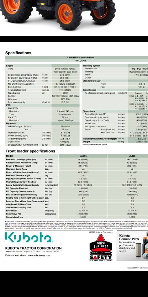

I guess my thought is, why step up to the L4060 and pay and extra $10k, instead of just getting an LS or TYM.
It seems most of the comments here are heavily skewed towards Kubota, probably with good reason. However, it takes a reasonably high degree of mental gymanstics for me to justify moving up to a larger tractor, and paying upwards of $40k, when a $30k LS or $26k TYM accomplishes the same thing.
Is a Kubota really worth paying 50%+ more?!?!?
The MSRP difference between an L3560 with the lighter loader and L4060 with the better loader is 4K. So you get better power for the weight and a much better loader. And higher resale.

I'm looking at an L3560 and the L4060 is $6,000 more when configured the same on the Kubota site. That is for both with the cab and both configured with the same 805 loader. Just don't think the 5 hp is worth that for my purposes. Granted the 4060 is a bit bigger also. But that is a negative for me. Waiting for a 3560 to get in at my dealer. I am at sea level so no altitude penalty and no snow or hills either.

Remember, the quote I got is on the L3560 limited edition, which is about $2.5k less than the straight L3560. That makes stepping up to an L4060 about $42k'ish, as compared to the $31.5k for the comparable LS.
Resale is not much of a consideration for me. I have no plans to ever sell the tractor I purchase.
