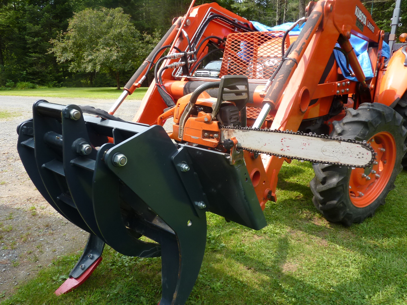

Here is another thing that I think would be good to consider if you have a grapple on a QA FEL that you use on brush or slash. Find a way to lock down your QA levers/handles. I learned the hard way. I like to stack slash and brush in hollows and holes and then crush it down with the grapple with enough pressure to lift the front of the tractor. One time a branch sticking up from the brush pile pushed up a QA lever and released the grapple on that side. A bad thing !! So I made some clamps that go thru two existing holes that were in the FEL arms. They hold the levers securely closed. There are lots of ways to do it like chains and hooks. Things bend pretty easy when one side comes off. You might consider this over kill but it depends on how you use your grapple. To me it is good insurance.

Thanks for the reminder, Gordon. I think you've show those QA FEL lever locks before. I need to figure out something similar for my tractor. I don't think I have the extra holes there, so I'll have to figure out another mount. I haven't knocked the levers yet, but I'm sure it's coming some day.
I also need to add a grill guard on the front. I never had in issue with brush poking holes in the front grill when using the bucket to clear, but it's a different story with the grapple on. I finally mangled up that front screen earlier this fall. Fortunately, the only thing damage was the scree on the front. It didn;t get ot the battery or radiator.

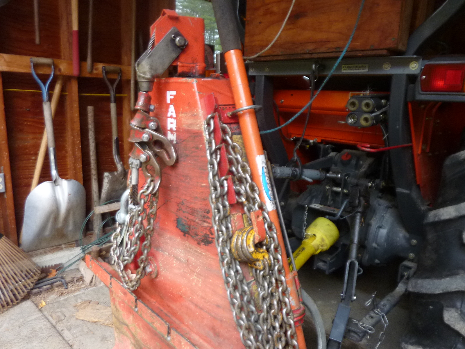

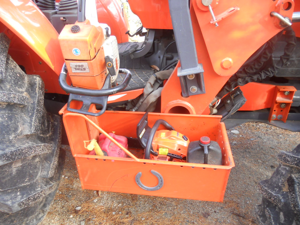

I built a skid pan from front to back with side guarding for the filters and hyd loader valve. There's a bumper/chain storage/grill guard in there along with some "sweeps" or limb risers going to a heavy steel roof. Most of these pics have been on TBN or even this thread, but it's been over 5 years. Im showing them in no particular order other than what they show up in my "file upload manager" on tbn, I have 20 pages to go through so yes, it's kinda random as these were separate builds over a few years.
The first few that showed up are the grill guard. It supports the front of the sweeps and has a "bumper" that's made of a 4x6 tube that's my chain and ball peen hammer storage.
The next was part of the skid plate project. I had the opportunity to build a nice sized box for saws & fuel/oil and whatever as part of the framework that supports the actual pan.
I'll keep working on posting a few more mods that I did and are handy in the woods.

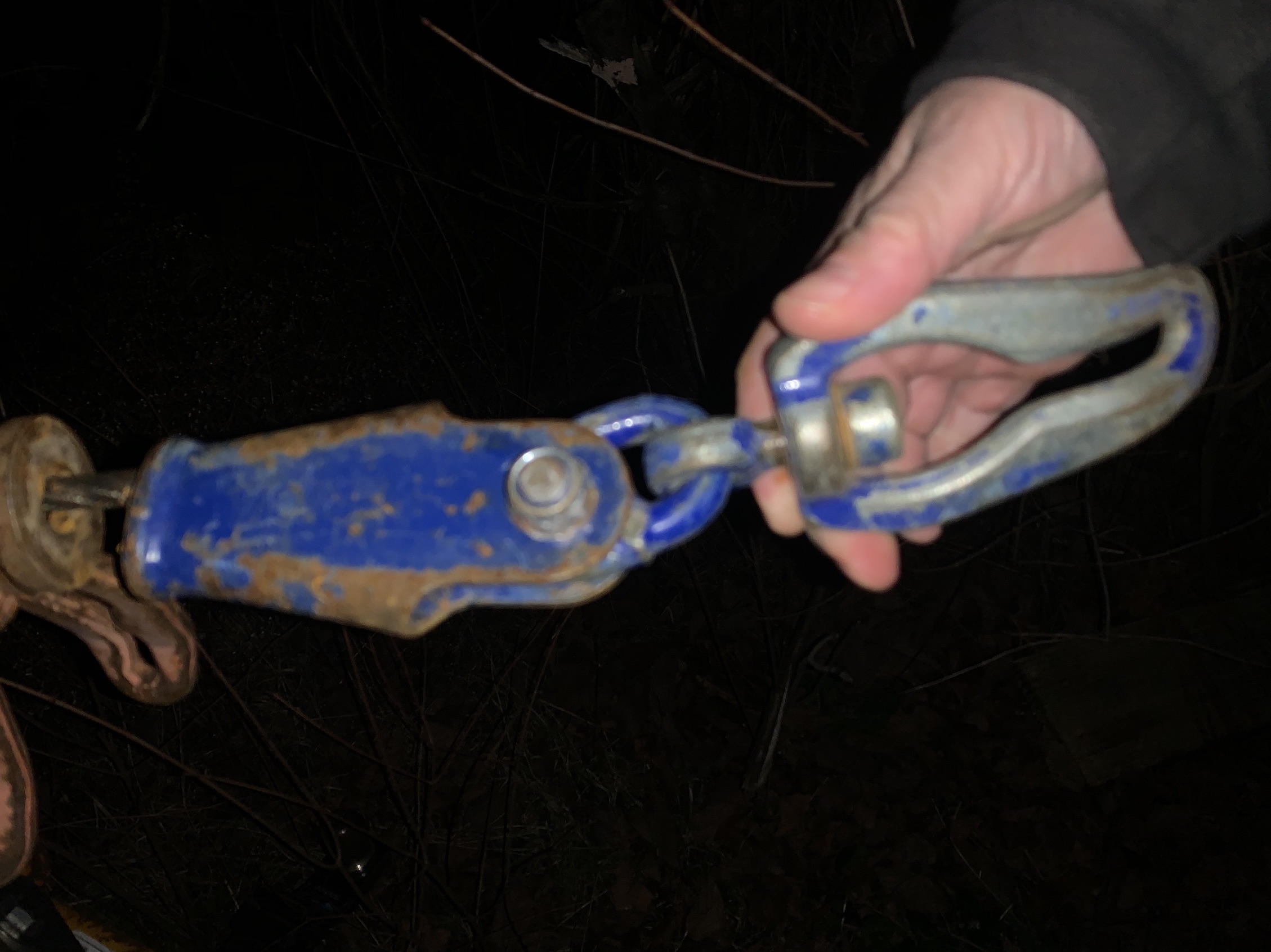

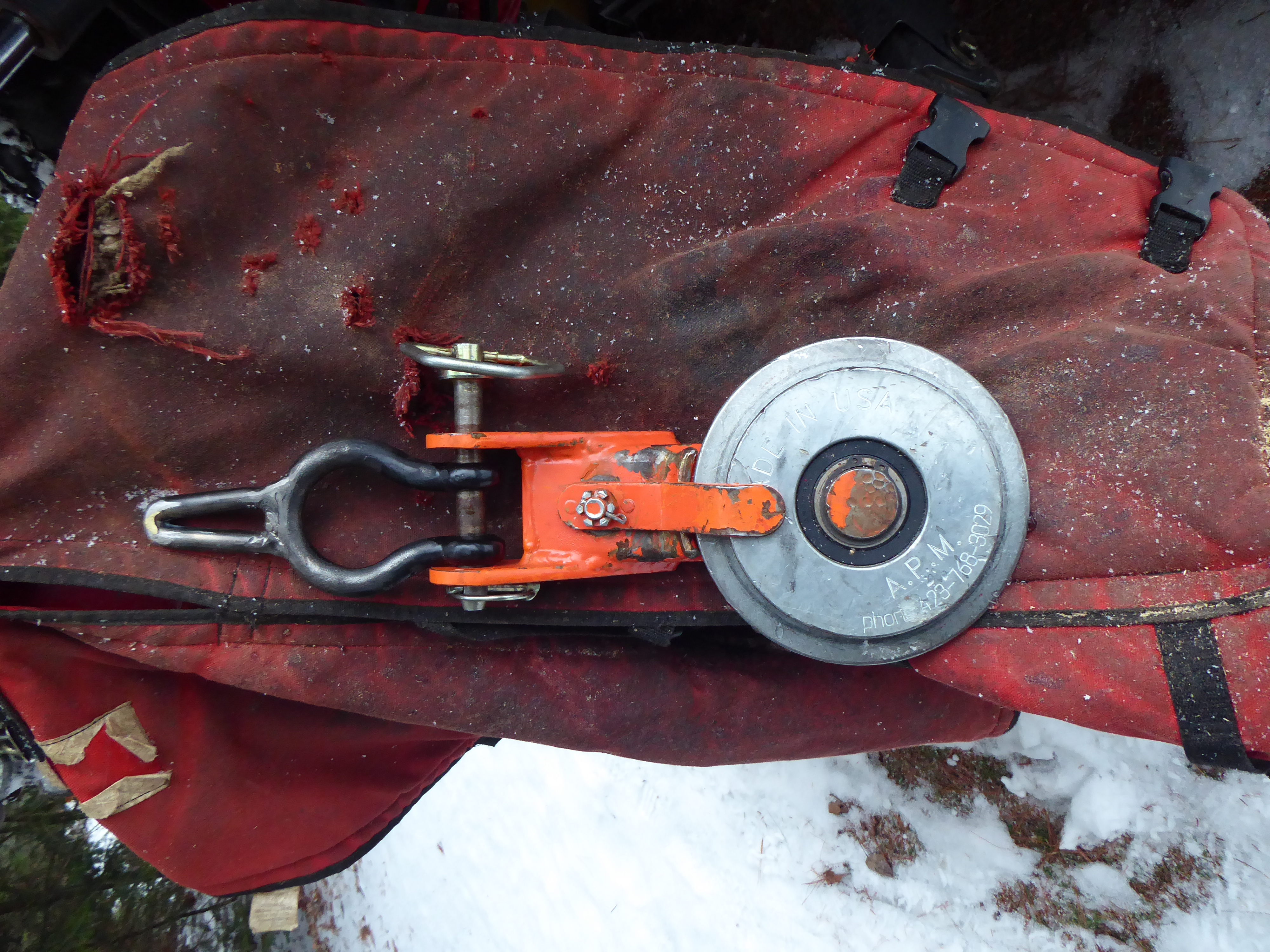

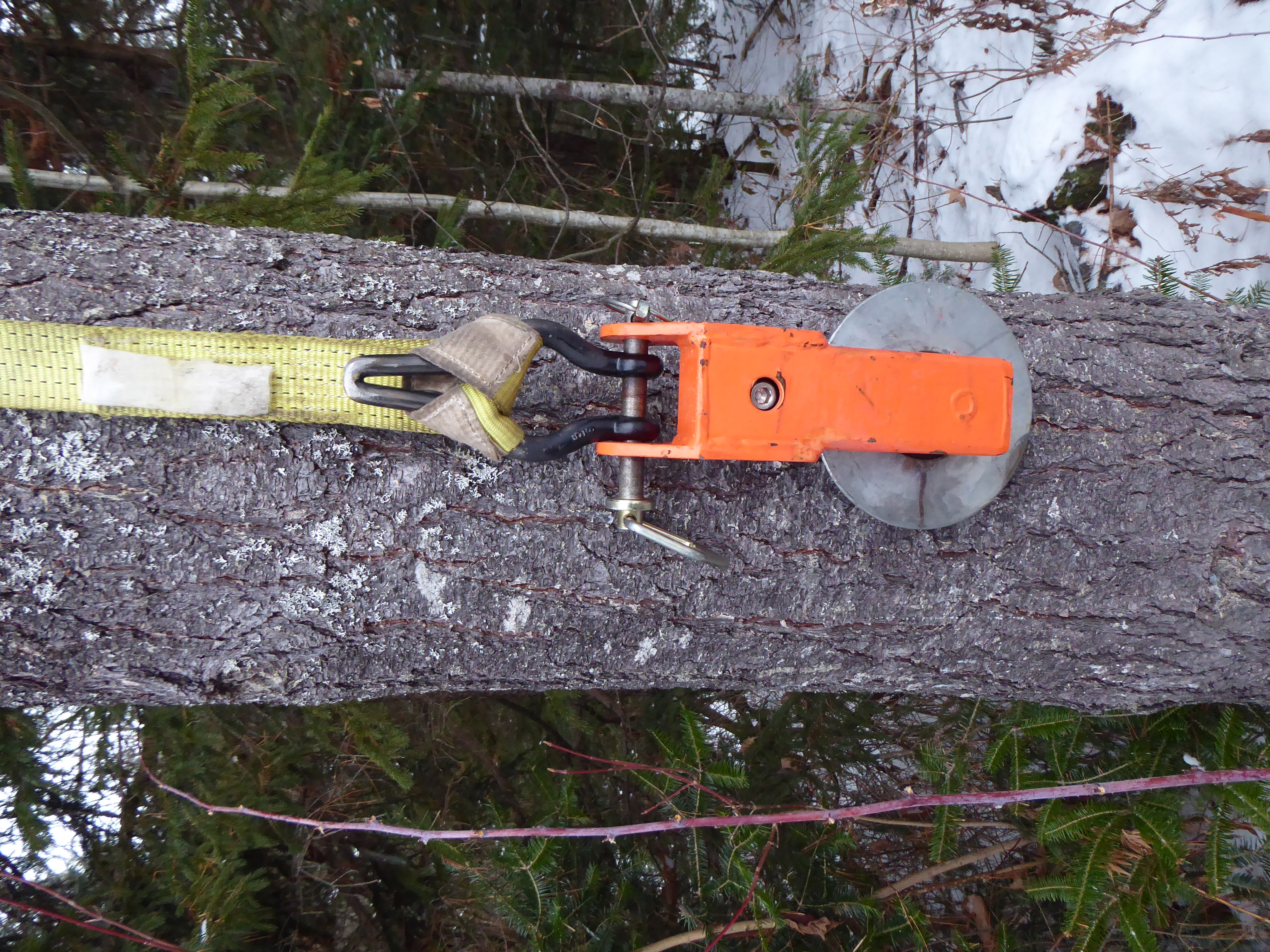

A short while ago there was a thread on Igland Self Release Snatch Blocks and Agvg, our friend from Norway, Posted some pictures of his Snatch Block. This was among them
Wow - that makes an easy hook-up ! So I added a Pinocchio nose to the shackle I use on my Snatch Block. I have used it a couple times this week and it definitely makes life much easier. The Snatch Block weighs 12 lbs so being able to set the strap on the tree how you want it and then simply hook on the snatch block w/o opening the shackle makes it so easy especially in the snow. I have a 4, a 6, and a 8 foot strap andd use the one that works best. Thank you Agvg for posting that picture.
gg
/ Forestry mods
#31
I see you have one of the APM snatch blocks. They were a fantastic deal, while it lasted. I bought one from him for my second self-releasing snatch block. I probably would not own two, were it not for the great price at which he was selling them for a time.
I don't often need two, but occasionally it's handy on a longer pull, or when I have both a dogleg in my pull and want to either re-direct the line coming in to the rear of my tractor, or turn the logs coming out to the trail to align them with the side of the trail. Getting the logs parallel to - and along the side of - the trail makes for an easy pickup when I come by with the forwarding trailer, or makes less hand carrying if I'm cutting the logs to firewood lengths. since everything is right out on the trail.
I also see that you did the modification to prevent the cable from dropping down behind the pulley. I still haven't gotten around to doing mine, despite the fact that that minor design flaw in the APM block cost me a cable on my winch a few years ago.

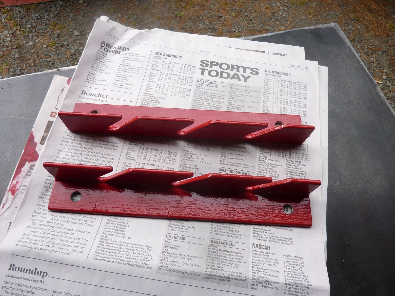

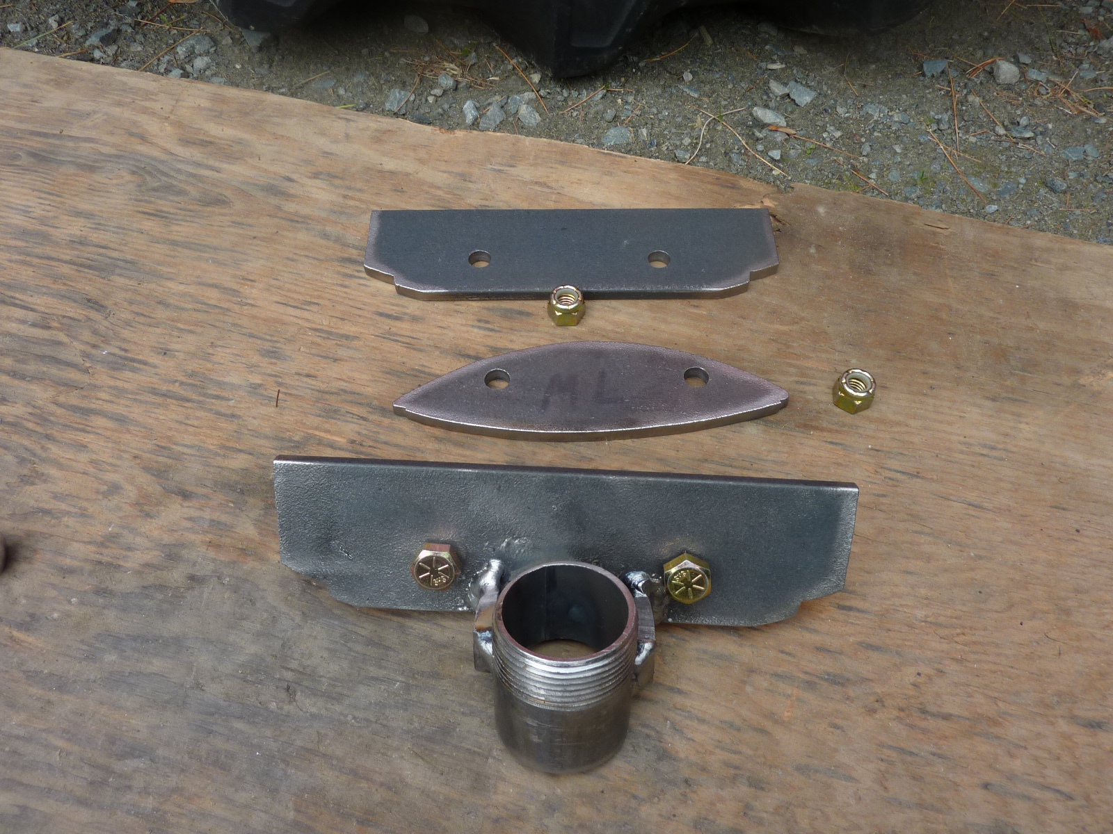

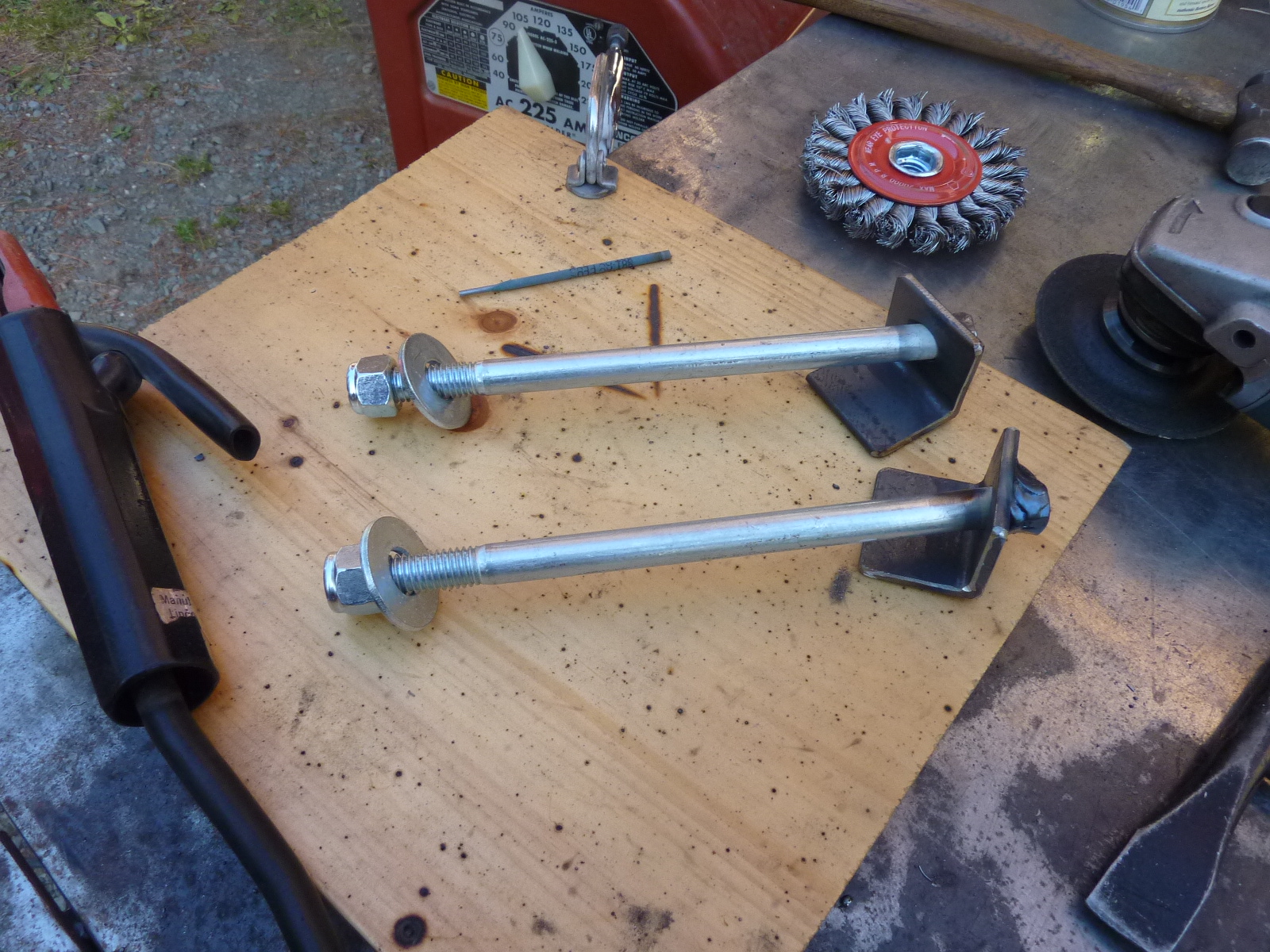

Also some bolt-on choker hanger brackets

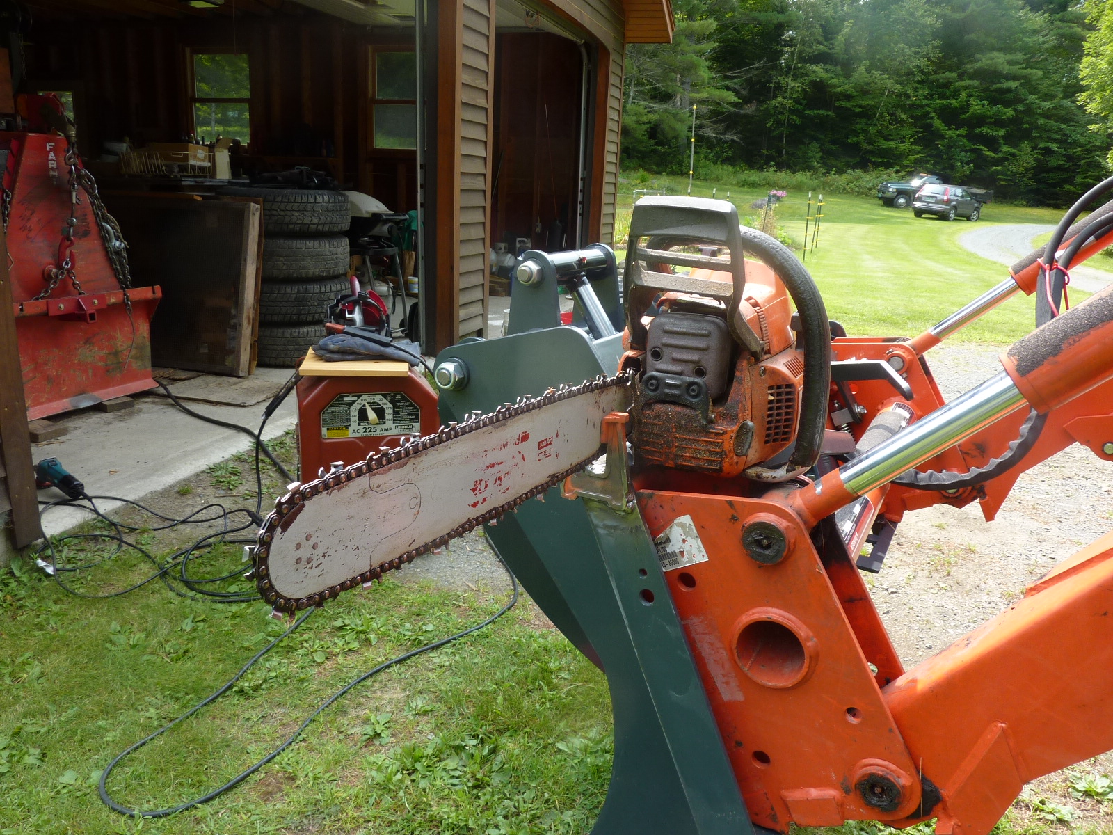

A saw vise for holding the saw while sharpening. Made from a stump vise.

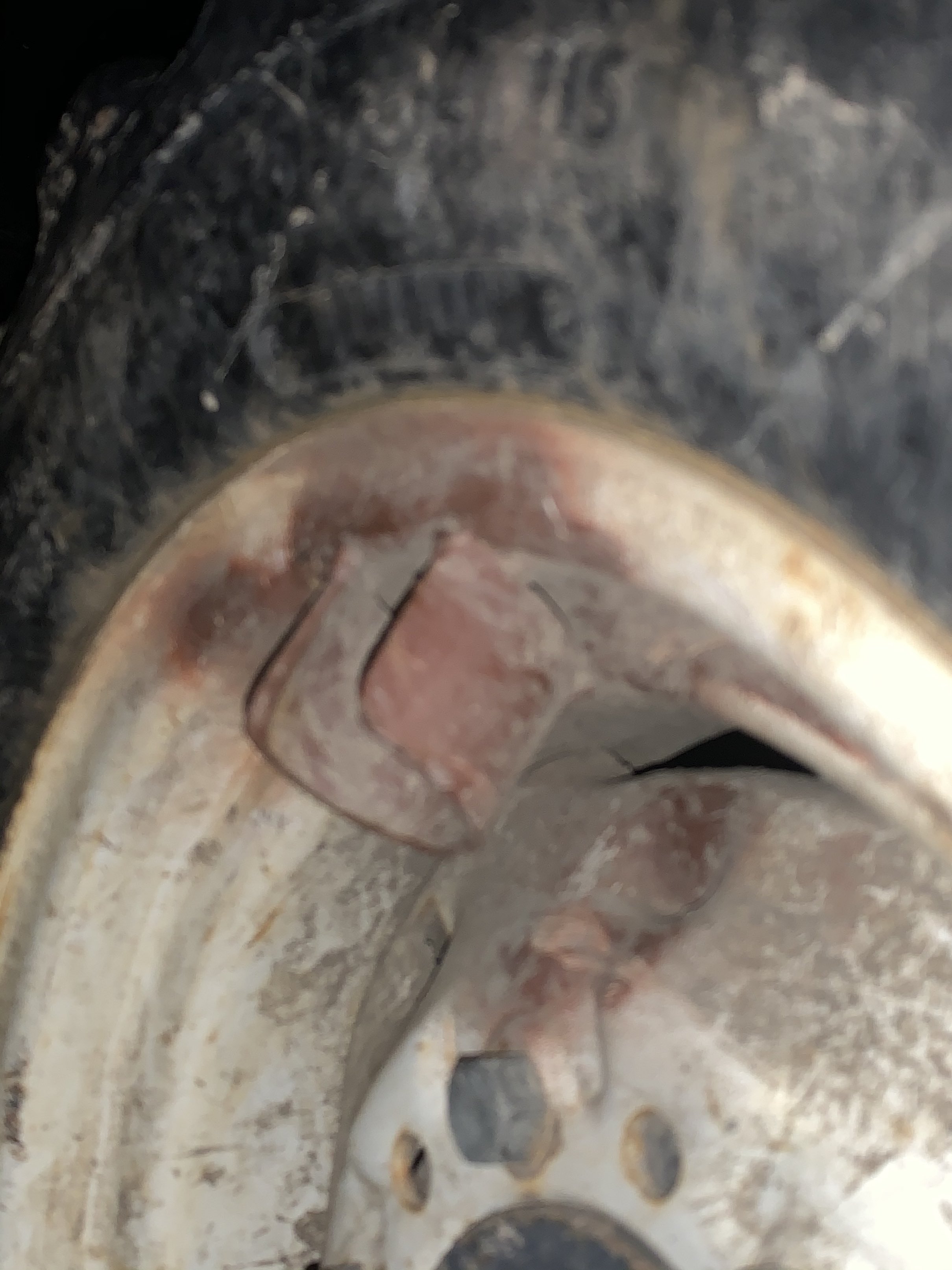

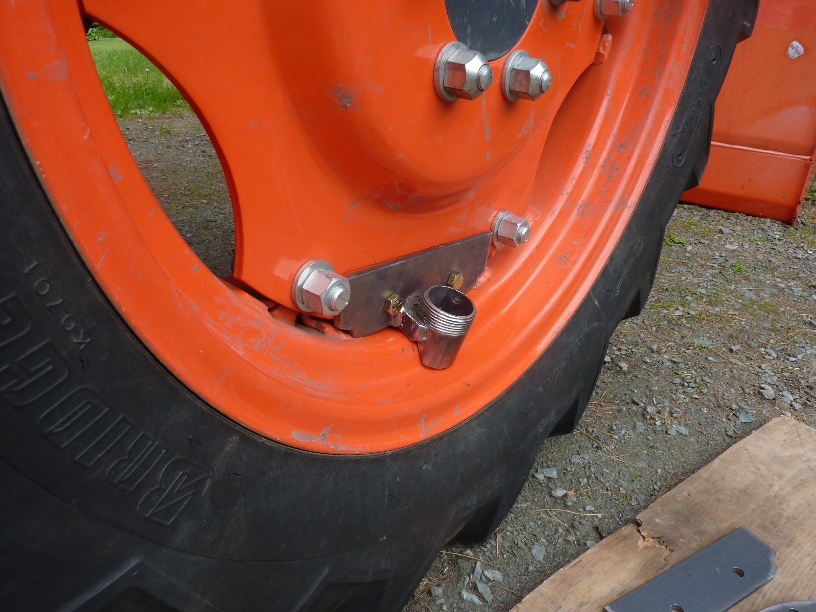

Valve stem protectors that bolt on by sandwiching the rim so I didn't have to break down the tires and weld them on.
gg

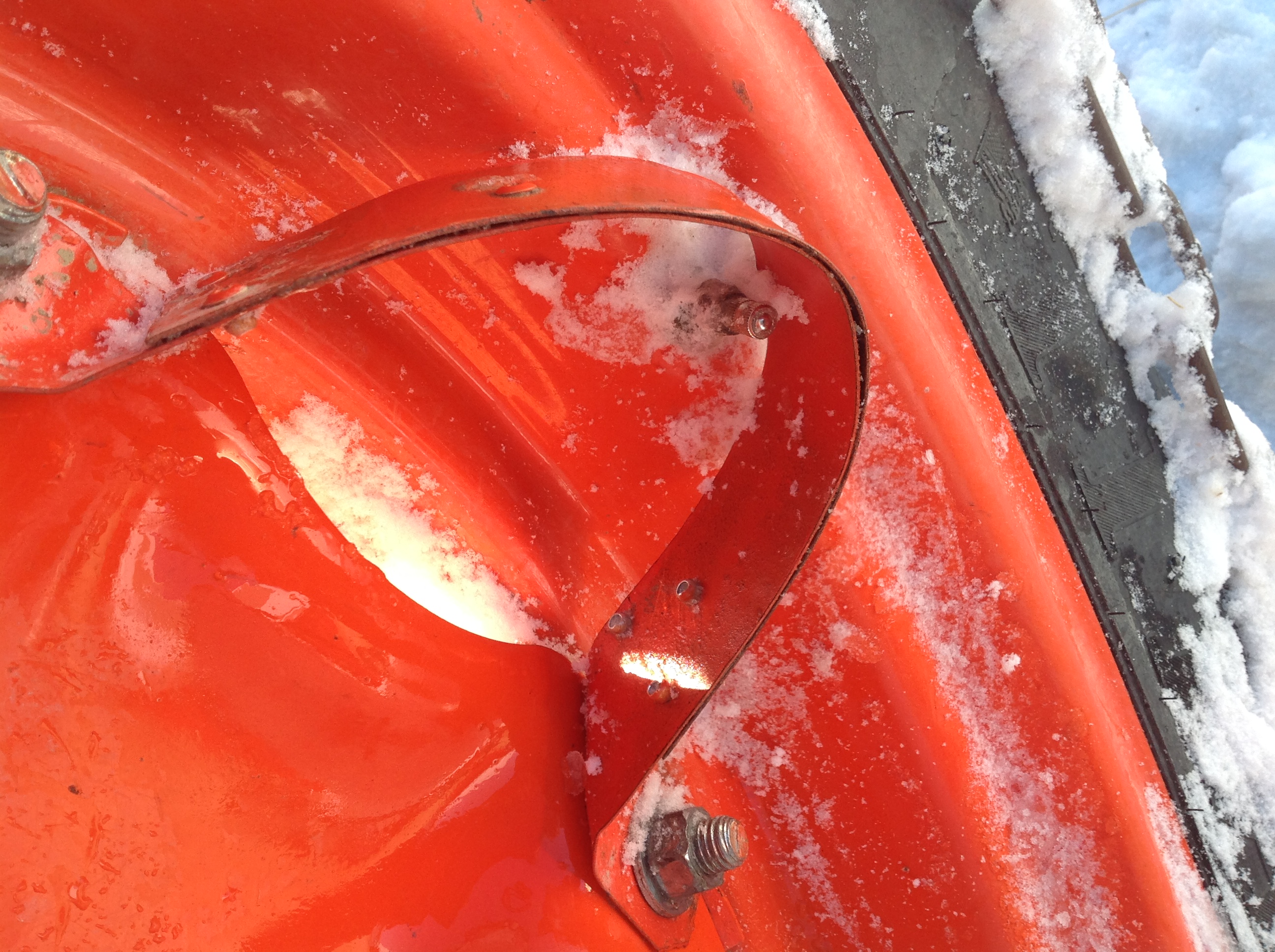

Gordon sure does good work on those valve protectors. Mine not so much. Not as strong or professional. But they work. I don't have equipment to build like his. But here is what I did.
Mine are built from wooden barrels metal hoops. These are light enough to bend into shape on a vice. First I made a cardboard mockup. Once I had the length exactly I cut the hoop lengths and drilled the holes. Then through trial and error I got the bends right to fit the lug bolts and protect the valve. By itself this was surprisingly a stiff protection. But to beef it up I riveted on the second strip which made it quite secure. I may yet rivet on a third. But I think I am quite protected.
My tires are loaded with tubes so it would have been a hassle to have pipes welded on. The thing with this is it can be done cold with little equipment
/ Forestry mods #33
Need is the mother of invention :thumbsup: Looks good !!

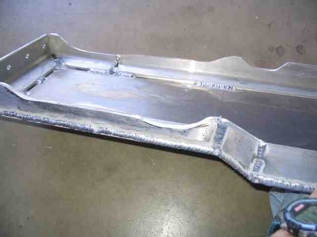

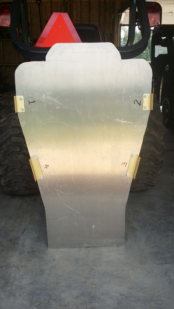

I'd owned my MF 1529 for just a few months when I realized it was only a matter of time before I snagged a hydraulic hose, fluid line, or control linkage on the underside of my tractor. I stopped by the local metal shop and bought a sheet of 1/4" aluminum to make a skid plate. It was easy enough to do and certainly worth the money spent.
/ Forestry mods
#35
I checked out your site. Looks like a nice installation. How long have you had it installed, and how is it holding up? Anything you'd do differently, if yo were doing it again?
I do wonder a bit about the dis-similar metals (aluminum against steel) causing some corrosion issues, but the paint may give some protection? However, the aluminum certainly is nicer when I comes time to remove and re-install. My belly pan is 1/2" steel. I have to think what it will take if I ever have to take it off. (Fortunately, the access holes are already installed.)
Those rear brackets that you were thinking of, but didn't get to due to restricted access might be something to consider if you ever have a rear tire off. It might not be needed, but it's some extra insurance that you won't catch and bend things when backing up.

This summer made the 4th year that the tractor skid has been installed. So far, so good, no issues and I wouldn't change anything. This is not the first 1/4" aluminum skid I've made, having done one for my Jeep Wrangler some years ago. Of course, that one saw much, much more abuse than this one on my Massey.
I enjoy the lighter weight compared to steel. I've had the skid off a couple of times since installing it as I need to pull it to do engine oil changes. When I pull mine, I put a rolling floor jack under the middle of the skid, remove the mounting bolts, lower it a small amount, and slide it out of the way. Easy to do. I haven't seen any dissimilar metal corrosion issues and for what it is worth, and I didn't have that issue on my Jeep either. Having that vehicle in Arizona where things were extremely dry might have made a difference too.
1/4" aluminum will hold up very well to off-road abuse, be it from a tractor, ATV, or a Jeep. One benefit is the ease of drilling holes. Of course, if you are going to weld, a TIG is the way to go. When I moved, I lost my access to that which is why my brackets are bolted onto the tractor skid instead of welded in place. We make do with what we have, right?

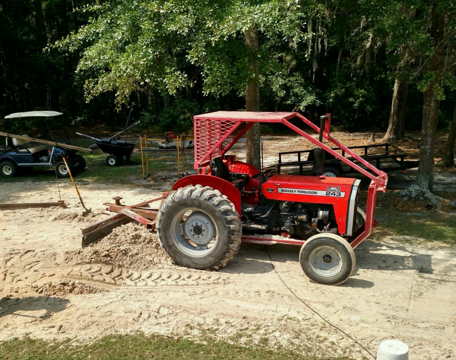

Forestry Mods???
None of that here....:laughing:
Looks like a nice set-up. I can see limb risers and the cage above and around the operator. I suspect you have other changes that are not so obvious in this photo. Is there a belly pan, or a grill guard? Other things I'm missing?
