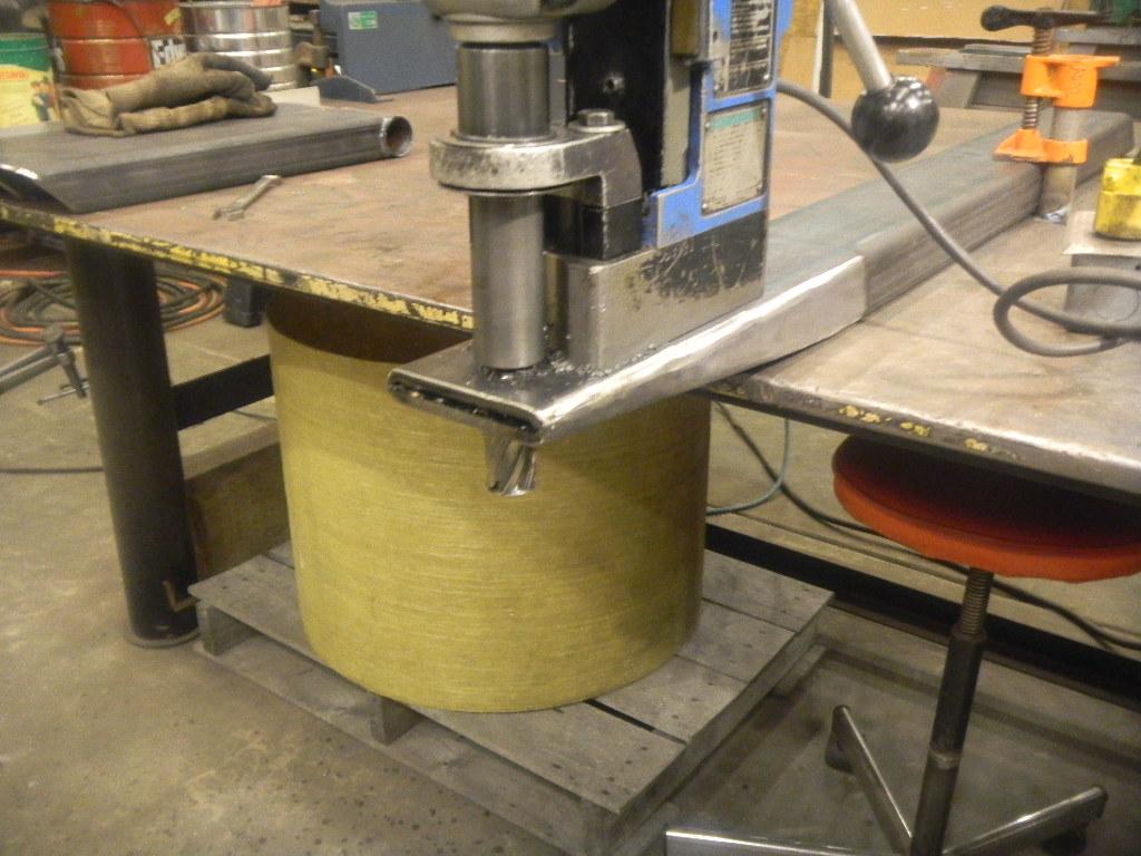

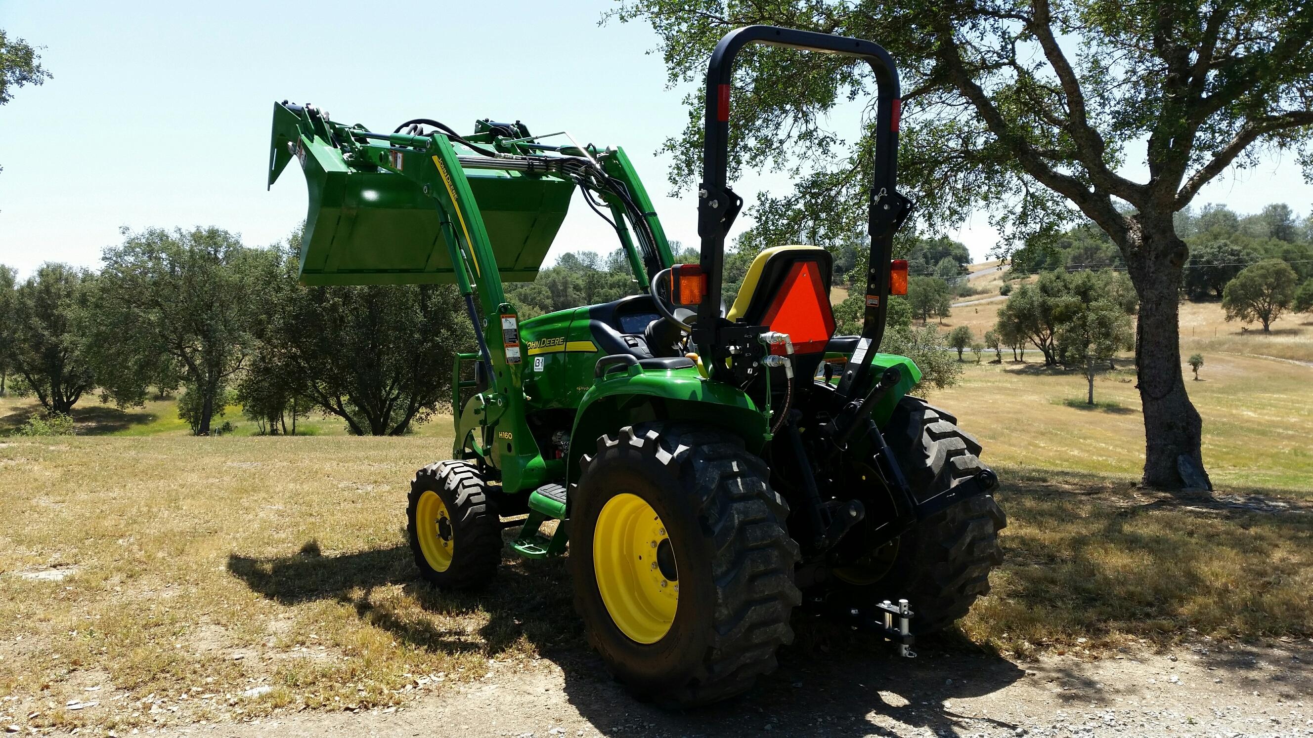

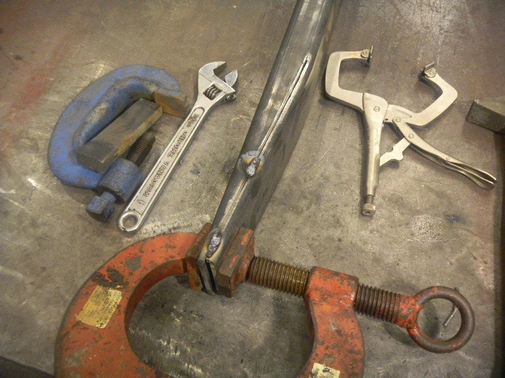

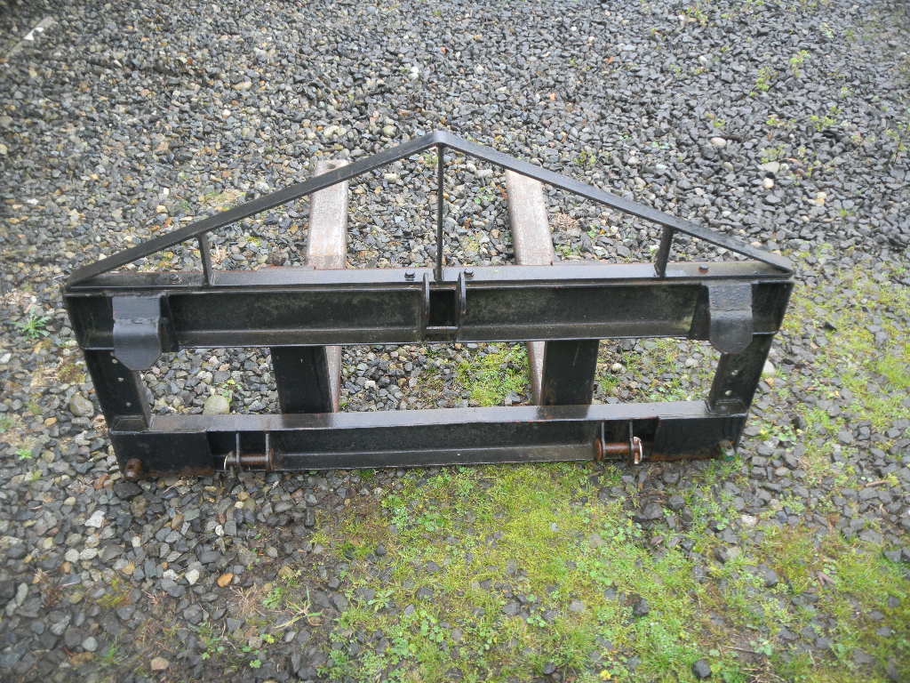

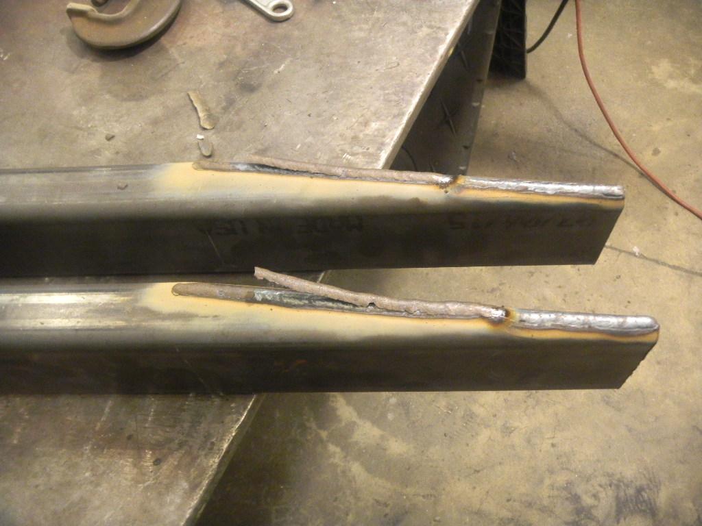

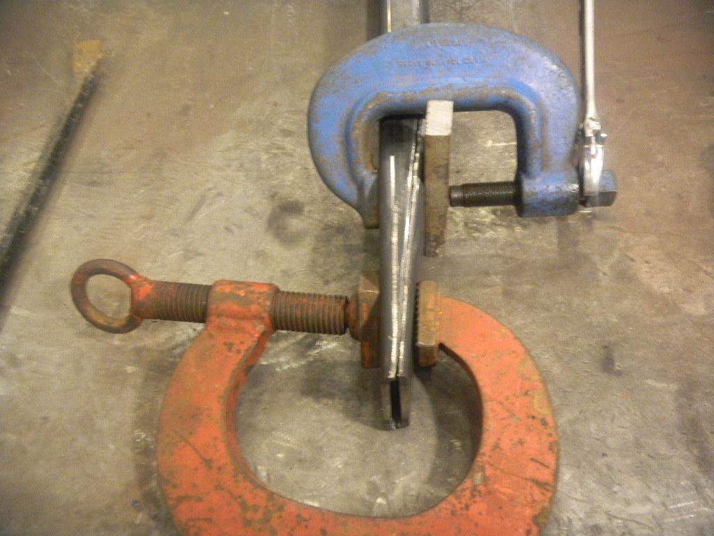

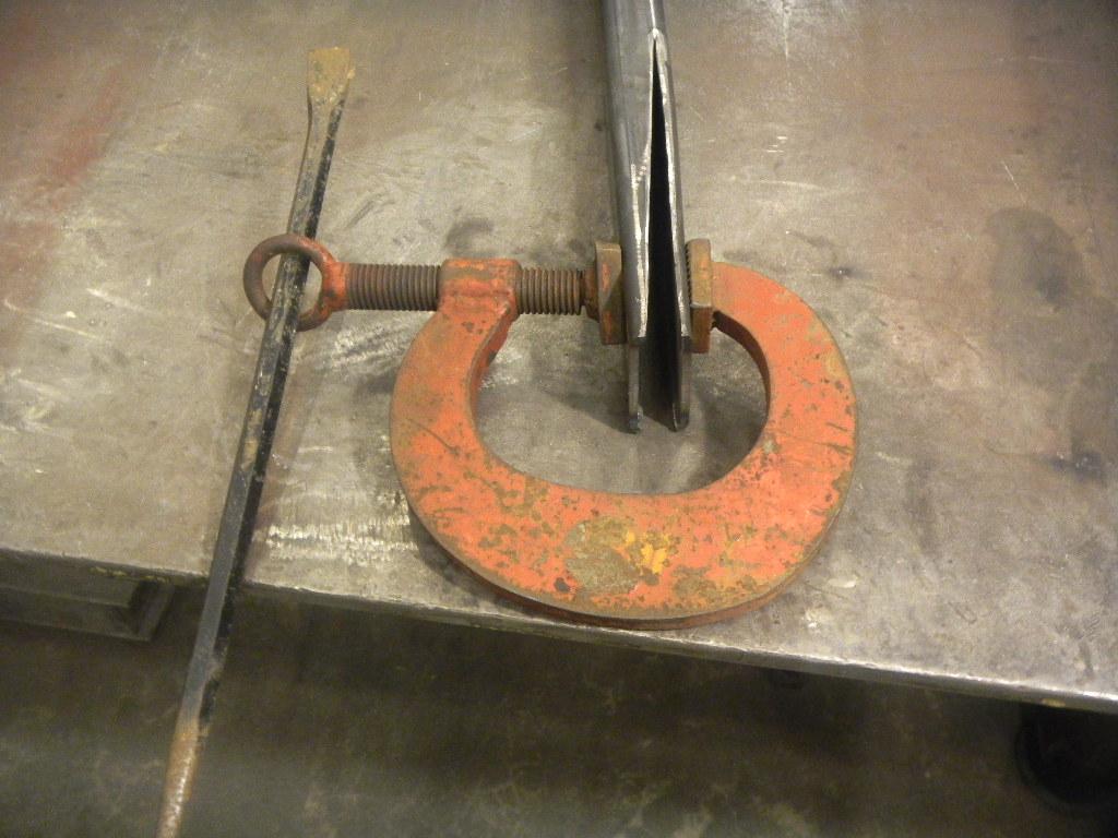

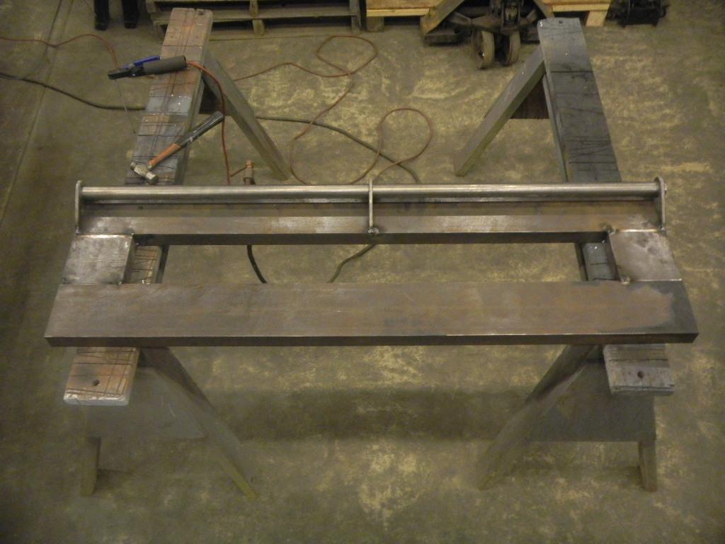

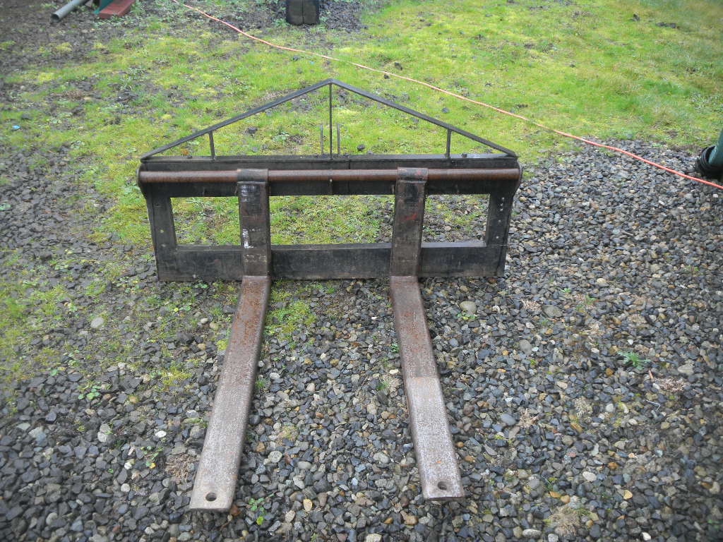

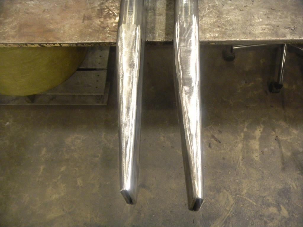

Building another fork attachment, this one is for my brother-n-law. I won't be going back to his place until next spring, so I have all the time in the world to finish it.:laughing:
It's the same design as mine, just a little bigger.

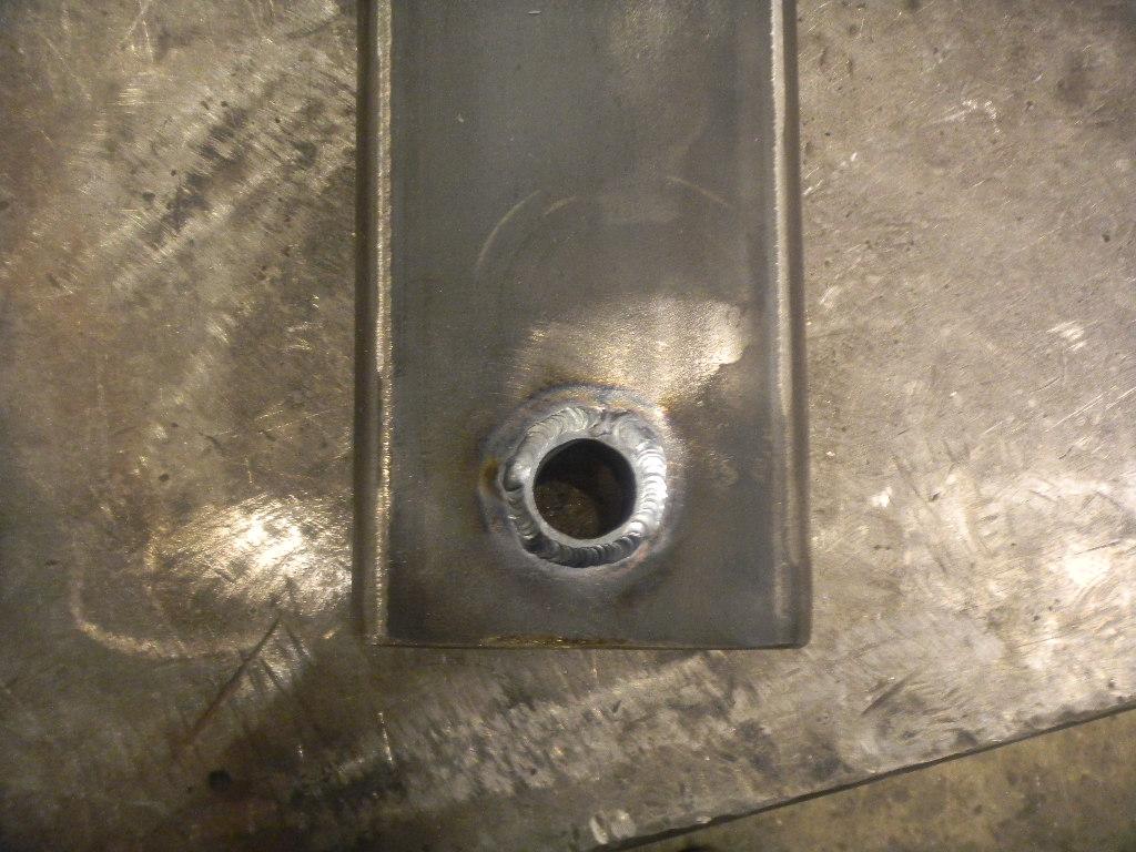

Tomorrow I'll weld up the taper to the tip of the forks. Then drill holes in the tips, and weld a piece of pipe in the holes.
This is all I have done so far.

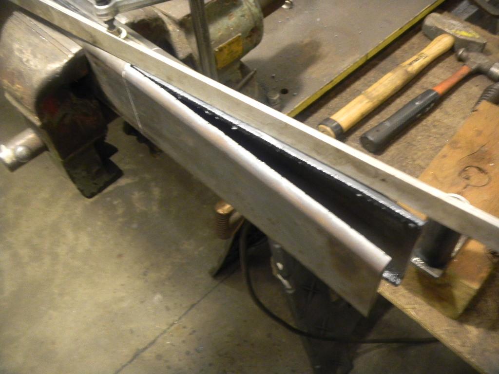

Looks nice! What size tubing do you use for the forks? Do they seem plenty stout?
/ Fork attachment build.
2" x 4" - 1/4" wall rectangular tubing.
The FEL on my tractor will pick 1,300-pounds. I've had rigging and shackles in the holes in the tips of the forks, and stalled the loader. I use the forks mostly to move my engine drive welders around.
/ Fork attachment build. #6
Looks perfect for your setup. I've been kicking around adding some forks to my hay spear attachment, or I may just build from scratch similar to yours. I'm always thinking of a use for pallet forks around here.
The local feed store gives their pallets away. So I have a lot of things setting on pallets. With the quick release FEL makes it easy to change attachments. A good friend of mine has a Kubota tractor, but no quick release. I've been begging him for years to bring his tractor over so I could build him a quick release. He just doesn't see the need! :confused:

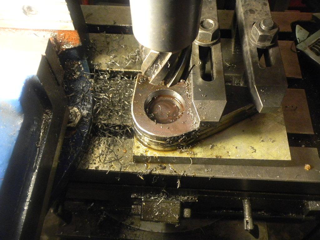

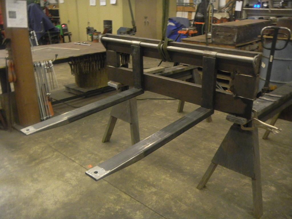

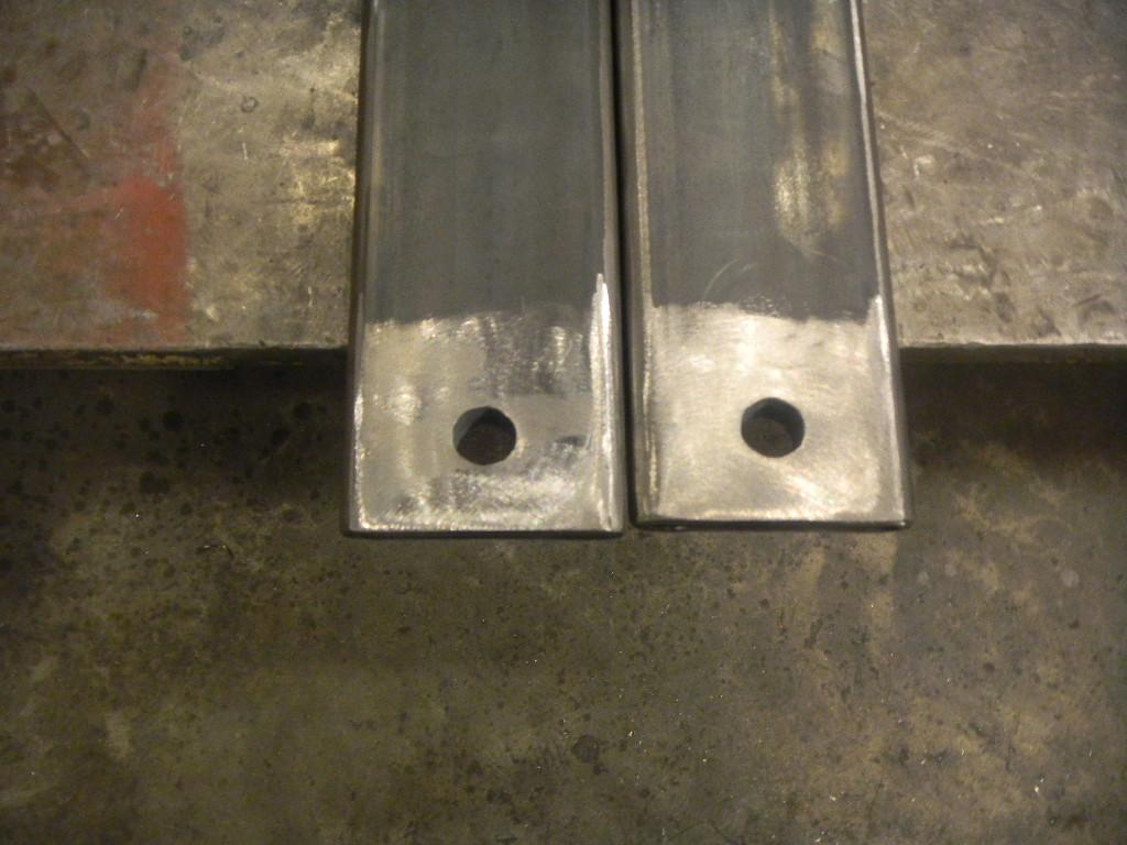

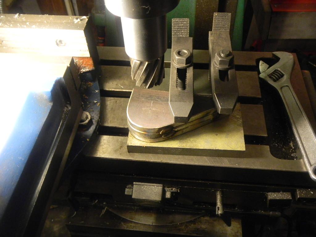

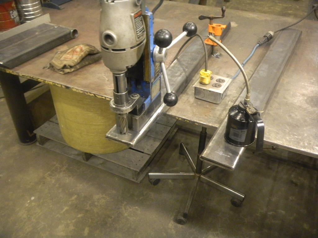

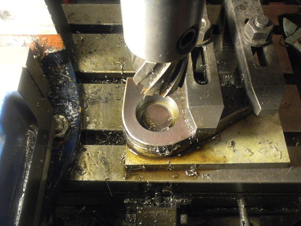

This mornings progress.

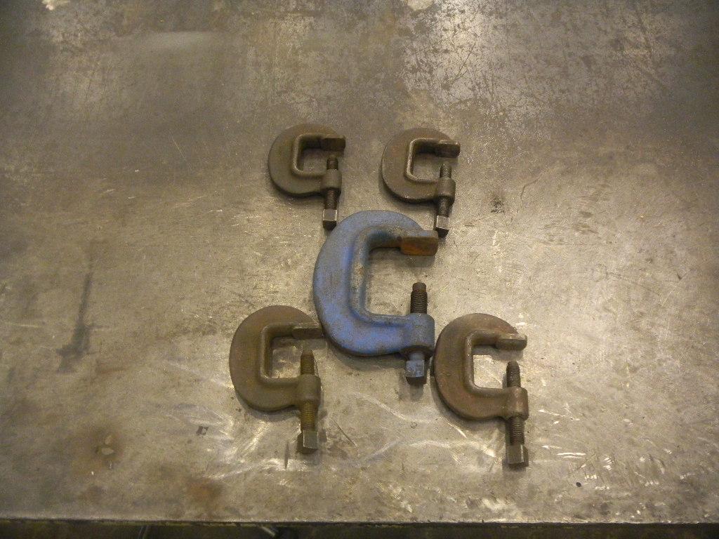

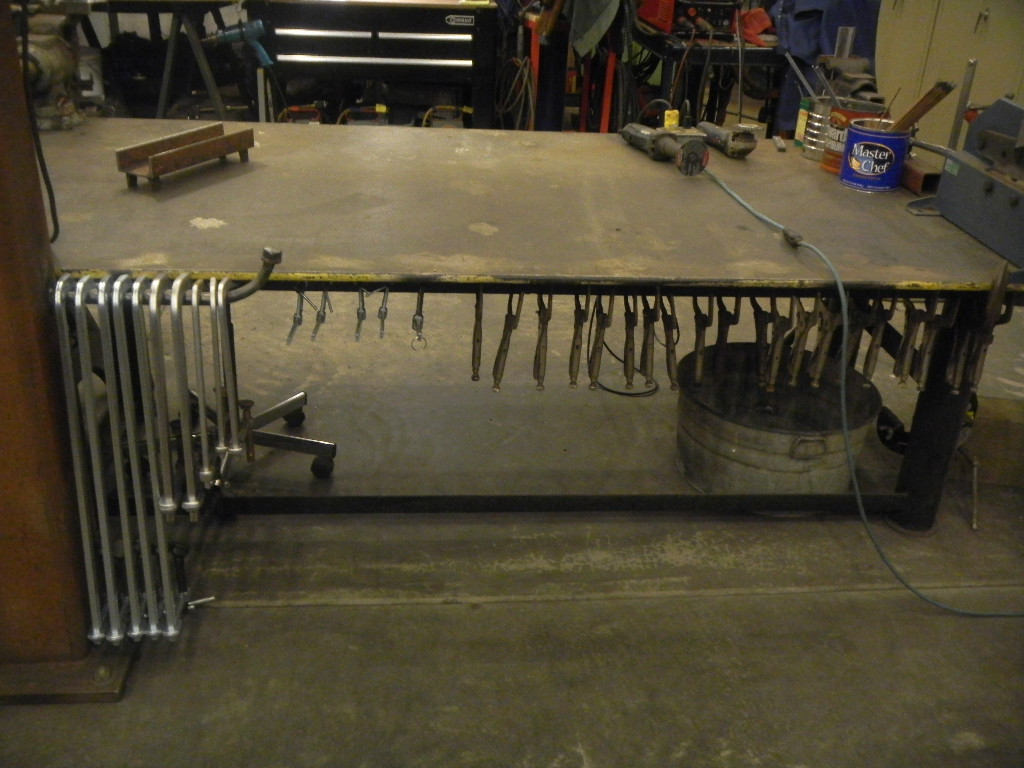

Oh a guy can never have to many clamps.;)

/ Fork attachment build. #11
When I built my 4 fork ( double pallet) lifter I cut the angle off the fork tips and welded in a piece of flat bar. Boy do feel dumb now!!
Nice work! I like those clamps too. Never seen any like that before. But then I'm only 64 years old. :)

I changed my mind today. I cut the forks back apart. Going to the metal yard tomorrow morning. I'm going to insert some 3/8" or 1/2" x 1 1/2" flat bar inside the box tube. My brother-n-law's tractor is much bigger than mine. So I think it's a good idea to beef up his forks.;)
/ Fork attachment build. #17
Good call. The temptation is always there to pick something up just using the tips of the forks.
Never had a problem with my 2x4x1/4" sq tubes because the 4 ft forks had to be TOTALLY inserted into the pallets or else the pallet would break. Turf pallets have no bottom boards. Just runners and top boards.
