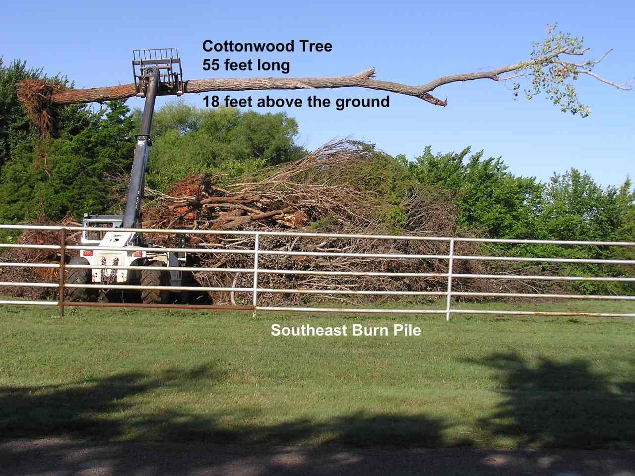

You might consider some flat bar. These are some old Brinly forks that bolted to their 3 point A Frame. I built a frame about 30 years ago to hold them, on a Craftsman garden tractor FEL. Then later added angle iron to use it on the TORO+Loader that can lift 800 pounds. http://www.tractorbynet.com/forums/...ter-put-together-post3204431.html#post3204431
Made some big brush piles with it, "back in the day", here is one from 2006.
