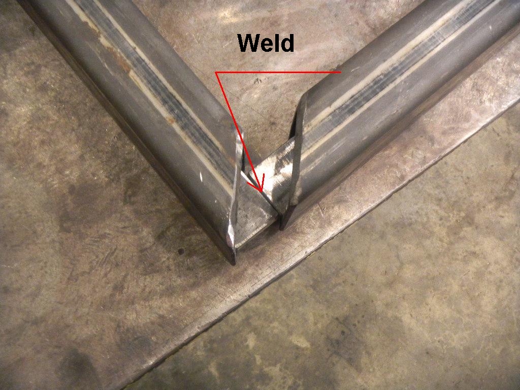

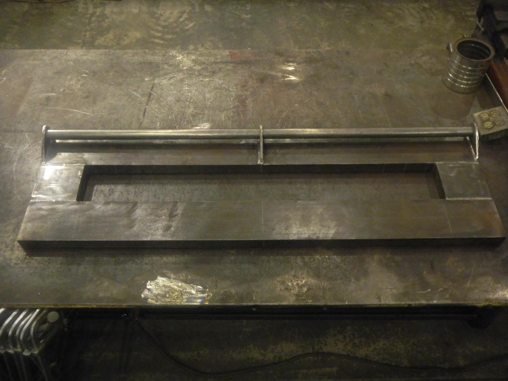

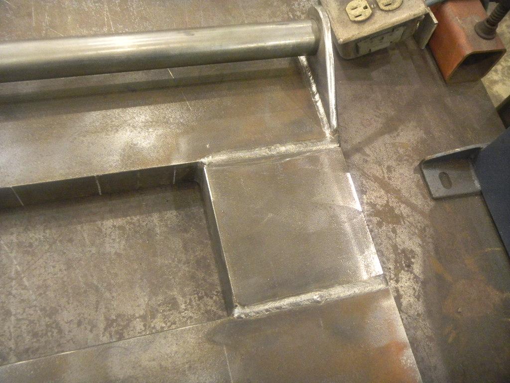

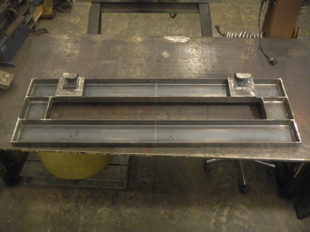

Turned out nice.
The way you did the bar inside to beef up the heel is nice. Not what I was picturing based off what you were describing. I thought it was only going to be inside the horizontal and stop at the heel. What you did should.make that heel area a good bit stronger.
Thanks! ;)
Let's hope it makes the heel stronger.
/ Fork attachment build. #62
It will. Not as much as adding material outside the tube like I described, but a cleaner look.
Similar to adding material to the flanges vs web of a beam. What you did is the equivalent of adding to the web. Helps yes, just not as much as adding at the extremities

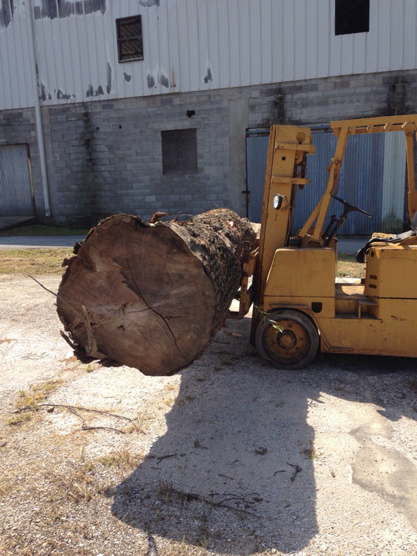

Not my design, I stole it from Ingersoll Rand. I just adapted it to mount on a tractor.
Slots in frame so the bar can move.
Speaking of designs, I am posting this for future builders.
Note the slots in the 6' wide frame to allow the forks to set flat on uneven ground.
The center slot shows up well on the 4' frame that came with my V518.
I moved lots of trees with the forks.

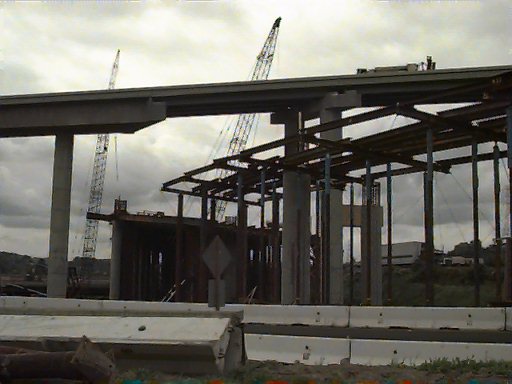

On the job, every once in a great while the engineers will require us to beef up the web of a beam, but not very often. Wish I had a dollar for every beam I've done this to. Or added flange to web stiffeners in a beam.

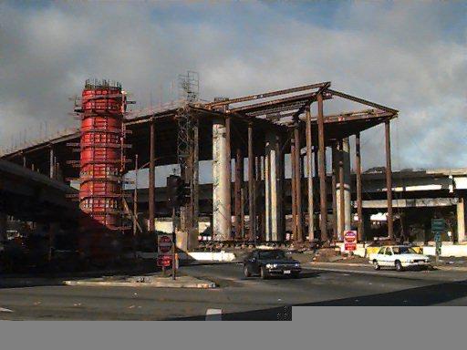

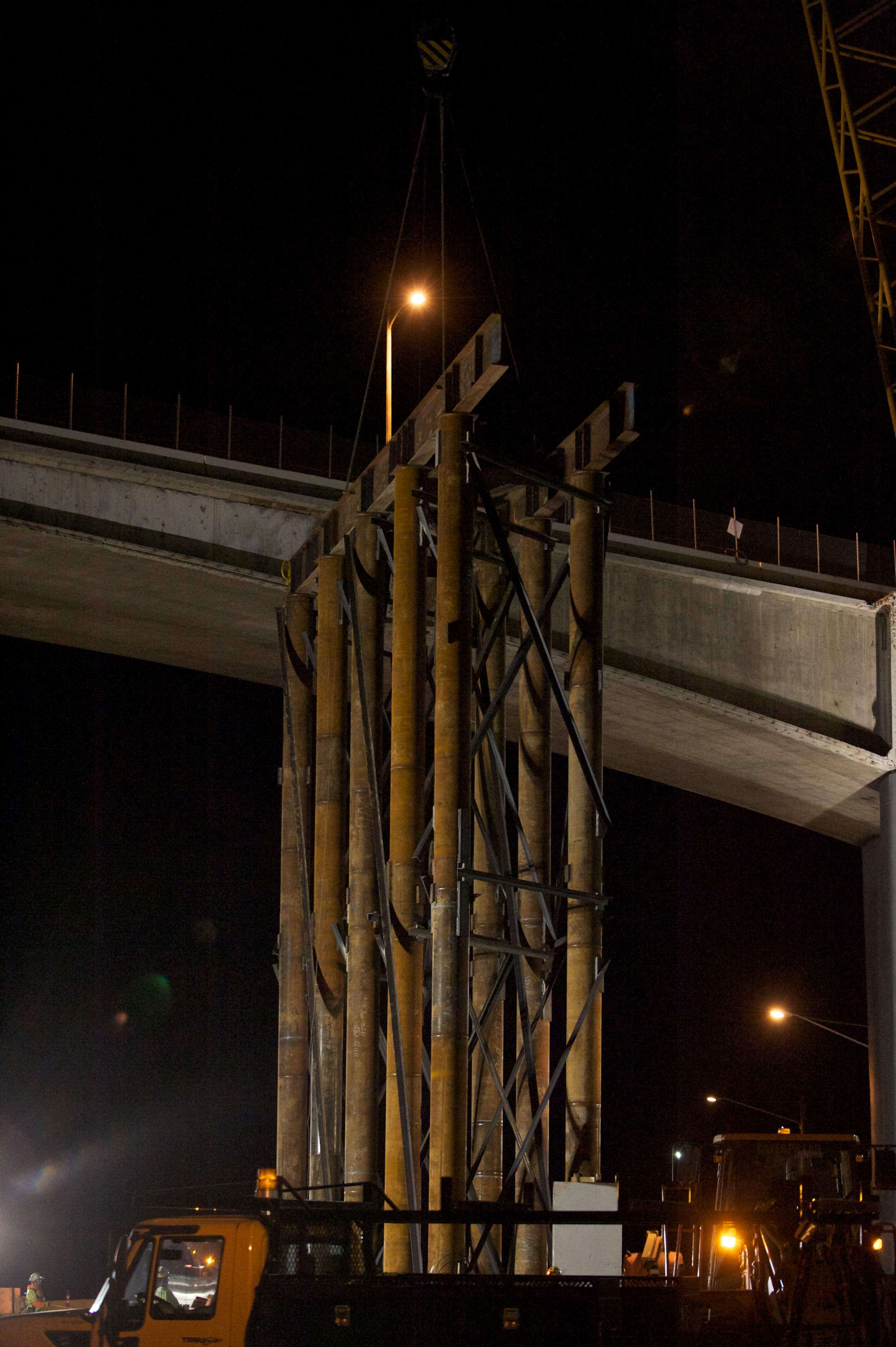

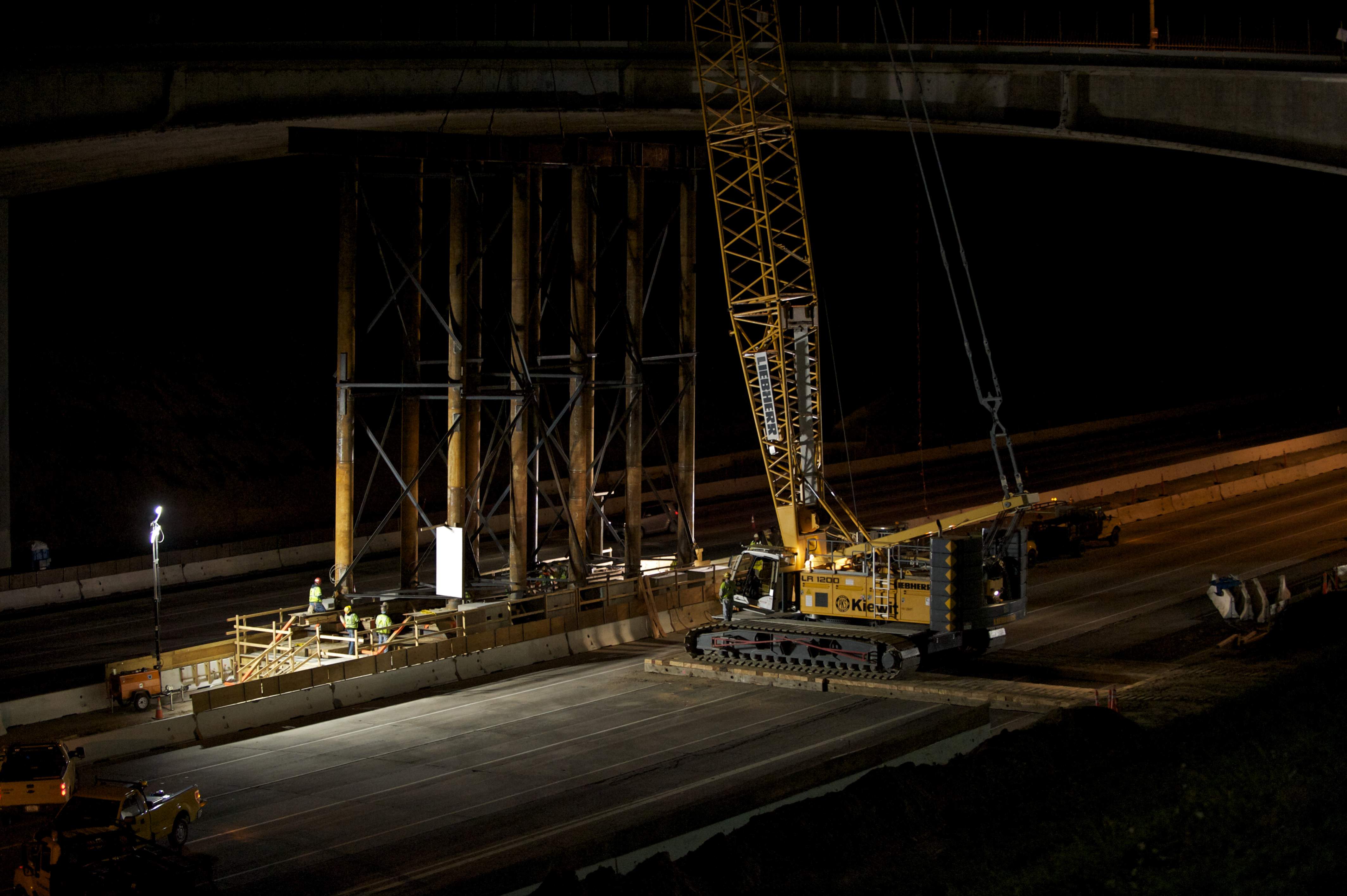

The main reason we did this. All the construction companies I worked for, had huge yards full of beams. When we built false work for a concrete bridge, the beams on hand had to be beefed up to carry the concrete loads..

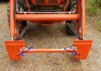

Great job on build. Trying to figure how to do the same and what my needs are. I have a Kubota MX5100 and the loader has the skid steer attach with two pins going into the bottom of the frame and I also have a quick attach like shown above for the three point. I want to use both but cant figure out how to work out both the bottom pins on the skid steer mount and the three point at same time. Anyone seen this done before?
/ Fork attachment build. #68
skid steer attach ... quick attach like shown above for the three point. I want to use both but cant figure out how to work out both the bottom pins on the skid steer mount and the three point at same time. Anyone seen this done before?
That's a good point. I have seen where people make adapters (3-point to SSQA), but that's bulky and spendy.
I think I have CAD of a 3-point QA and of a SSQA plate. I should have a look at that sometime.
I can envision, off the top of my head, slots in the QA plate that lets a piece of plate swivel out that has a hole in it. So 4 things swivel out, put a pin through it, and that's the bottom links. Not perfect.....
Then again, maybe the 3-point features would "nestle" into the tractor-side SSQA such that it'd be ok. On Kubotas anyway, the way it notches in is curious...
/ Fork attachment build. #69
Just to be clear, this is a three point Quick Hitch.
This is a SSQA for a tractor.
Is this what you have?
/ Fork attachment build. #70
I took it as wanting to use on the front or the back. The build shown in this thread has a Euro (I think) mount AND 3-point tabs on it. So it can be used with either. Crystallake (nor I) have ever seen a similar setup only with SSQA and 3-point tabs.

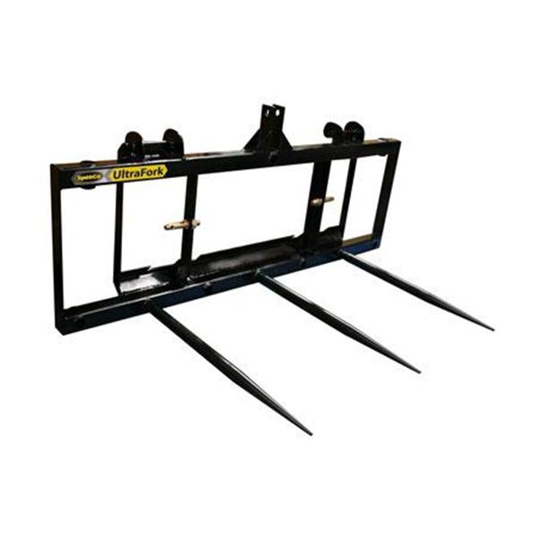

There have been some threads about home built fork frames that fit either end.
The one I have isn't pallet forks, it is a Speeco UltraFork, but the design would work for pallet forks.
