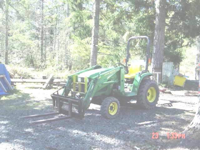

MY forks are 2x4x1/4 and clamp on style. IMG_20140928_142718_948.jpgIMG_20140928_142734_748.jpgIMG_20140928_142814_098.jpgIMG_20140928_142830_776.jpgIMG_20140928_142849_095.jpg
I cant remember, I think they are somewhere between 36 and 42". I dont think they are a full 42" but I think longer than 36.
Have had them maxed out on my tractor, moving nearly 1000# or more. Some old concrete slabs that I just couldnt lift but could curl and push dragging just the heal of the bucket.
Some of them were just too big to even think about. Put the forks on the backhoe and moved them. The BH bucket flexed pretty good cause of the clamp on style, but the forks were solid and no flex.
Have also moved a heavy steel rack still loaded with steel with the BH and forks. As well as used them with a 10k 12' long forklift boom to set my 40' trusses.
So gut feeling is the forks would be fine on a tractor quite a bit larger than mine. But I am sure I could bend them if I wanted to suspend a load on just a single tip and use them on the BH with 5k+ lift capacity.

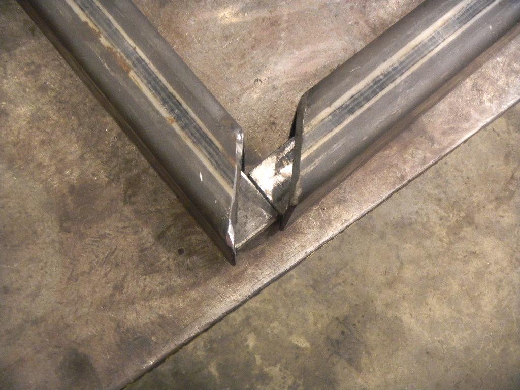

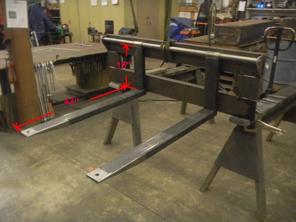

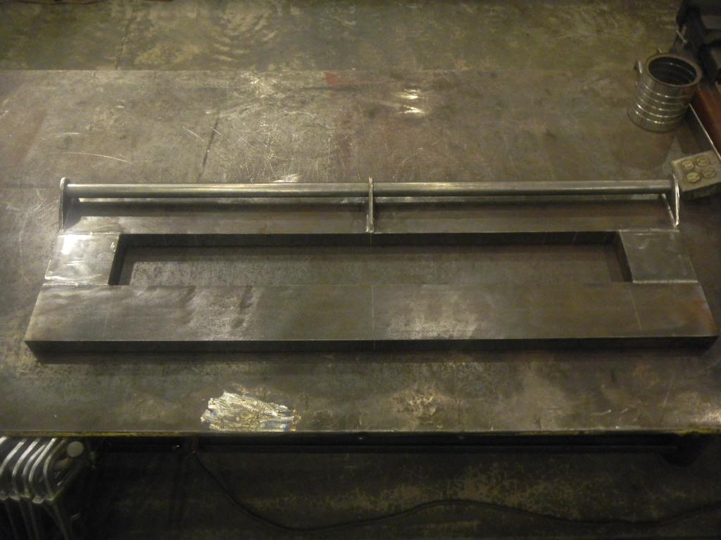

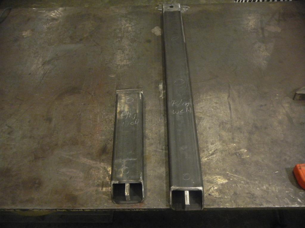

The vertical section of the forks is 15" long. The horizontal section is 43" long.
I plan on inserting the flat bar in the center of the tube. And make several plug welds to hold it in place.

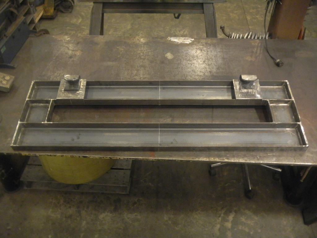

Worked on bending the FEL mounts this morning.

/ Fork attachment build. #24

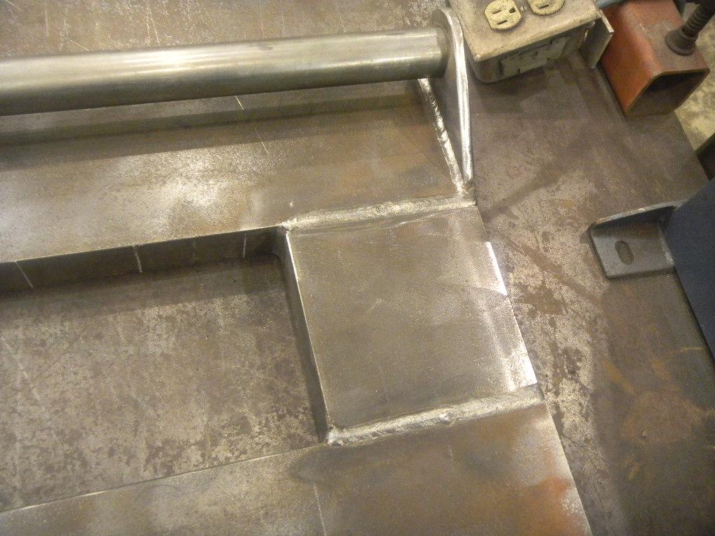

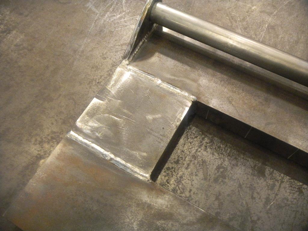

Not going to gain much at all strength wise doing that. The weak link is going to be the heel, not the long section of the tube.
Some 4" long sections of 3x3 angle on the outside corner and inside corner of the heel will do more good than anything.

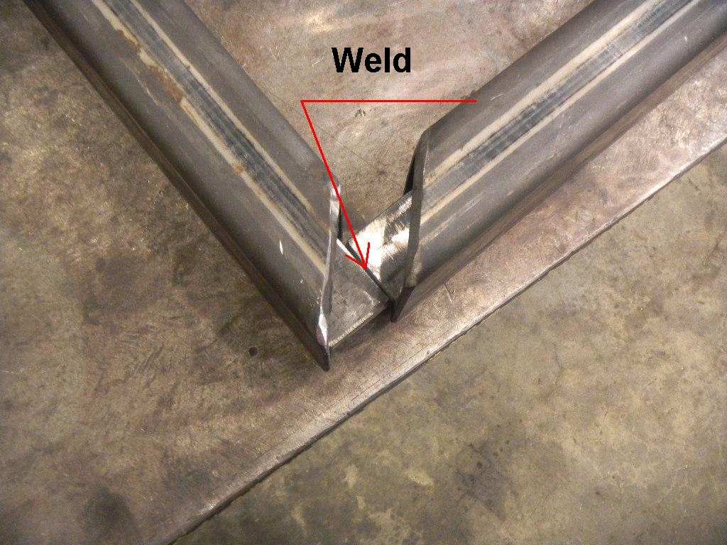

When I built my set. I made an open root weld with 6010. Then capped it with 7018. On the inside of the heel I made a 3-pass fillet weld with 7018. To beef that area up.

provided the weld is as strong as the parent metal, each fork is good for 3600# evenly distributed. So a pair is good for a 7200# pallet. Good for most tractors. Just saying the first thing that will fail is the heel.
The entire length of the fork is the same material and cross section. The heel takes the greatest stress. Adding anything inside the tube doesnt do anything for this area. The fork isnt the weak link, the heel is. since its a welded connection, failure isnt likely gonna be a bend, rather a complete failure ripping apart.
The forks "as is" tested to destruction (which will take quite a bit), the heel is the failure point.

I still dont see how inserting anything in there is going to help, unless you do like someone mentioned and make L shaped pieces and bridge the connection point. Or even cut two L shaped pieces and weld to the outsides. With only 43" forks, there isnt going to be much bending at all up until failure point that will occur at the heel. Adding a piece inside wont do anything to strengthen the heel, thus would still fail with the same amount of weight, and maybe a tad less deflection along the length.
Unless I am not understanding what you plan to do. I envision a piece of barstock 43" long welded inside the tube in the middle vertically? Basically making it look like a pair of 2x2 tubes looking at it from the end?
Like I said, I think they are going to be strong enough as is, but you never did mention what this other tractor is? Adding what you have planned if I am picturing it correctly wont help with strength.

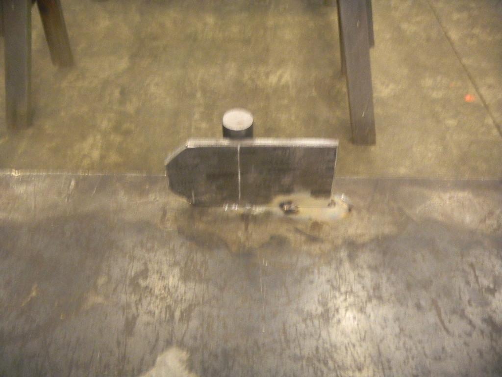

LD1 inserting the flat bar has to help some. If nothing else, it's better than a sharp stick in the eye:laughing:. I can't make these welds until I get back around his tractor, to double check the angle of the forks. My forks could not be at 90-degrees. A lot of this will be cut, fit, and tacked, but not welded 100% until I can get back around his tractor.
I can't remember the number of his tractor, but it's around 35-HP.
Did some welding this morning.
