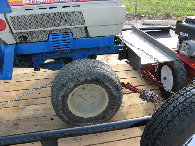

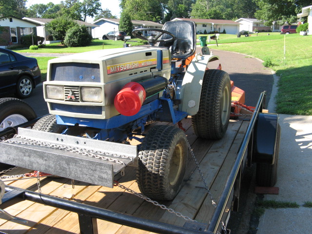

I have seen all sorts of heavy scrap/junk bolted to the front's of tractors.
This is what i bolted to the front of mine: a 38" long section of steel "I" beam that I found years ago when out boating:
I am guessing it weighs about 75 to 80 lbs, and if that is not enough weight, other stuff can be piled onto it/hung on it (just make sure nothing will fall off and get run-over). I cut a 1/4 inch by 1 1/2 inch groove in the web on each end that I can "hook" the link of a chain into (like a grab hook) for tying-down on the trailer.
EDITED TO ADD: If you want the weight on the wheels, you will find information all over the internet for making homemade concrete wheel weights.
