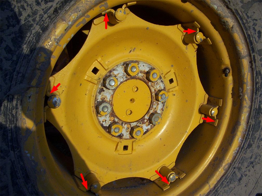

Thing is, I'm not sure in order to do that, that I'd not have to not only flip the tires from one side to the other, but remove the carriage bolts, flip the centers, and remove the fenders.
Bottom line is, this tracking width seems excessive to me, and I was wondering if I can change it is all.
As you've found out, there are many many different ways to put the rims and centers together to make different widths. If you flip the centers and put them back on the other side of the rim tabs, you will get yet another width. The manual will show the different setups.
The tractor can be set up very narrow. The roll over is kindof a construction addition. A good one, but....
Is it possible to put the fenders inside of the roll bar, and stack the mounting tab under the roll bar bolts on the inside?
An inch of clearance is terrible tight, doesn't allow for mud.
