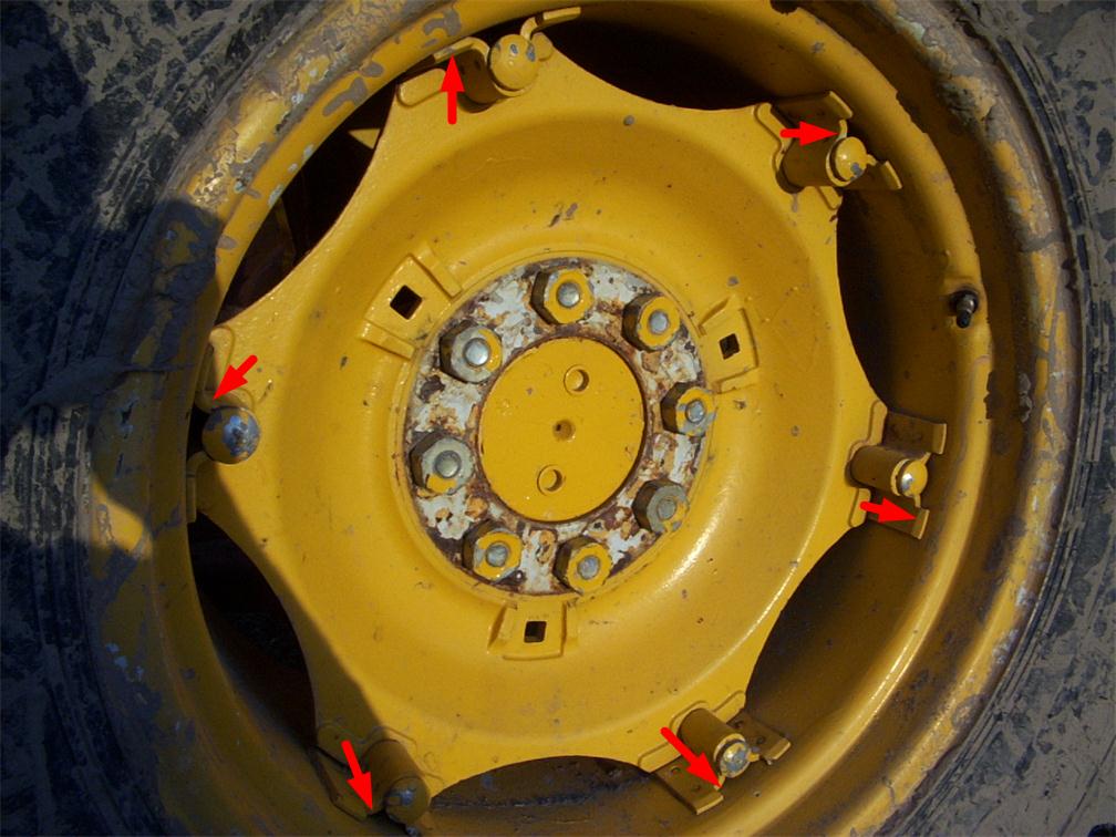

how much clearance is there between the tires and the fenders? Could you put the "dish" on the other side of the mounting locations on the rim? That looks like it would gain you 4" which would get you on the trailer.

/ Ford 4610 trailer conundrum #13
Here is what I am thinking, pull the carriage bolts and move the "dish" to where the arrows are pointing. That should gain you 2-3 inches per side without hitting the fender (and you can pull it if it does).

I'll try that on one tire tonight.
I think it will hit the fender though...
/ Ford 4610 trailer conundrum #15
Measure the clearance and compare that to the width of the mount & the thickness of the center "dish" that will tell you if it will fit.

It looked like there was a bit of room between your fender and the ROPS, maybe that'll be enough to get everything where you want/need it, then ad fenders that attach to the ROPS above the tire?
#18
BINGO!
If I remove the bracket on the fender, and drill & tap holes into the ROPS, I can mount the fender right to the ROPS and it will clear.
I moved the center to the outside of the carriage bolt brackets on the rim, and I was hitting the fender bracket, with about 1/2" interference:
Pushing the lift arm all the way towards the tire, it clears by about 1 inch, good enough for me:
I'll remove the fender mounting bracket, and mount the fender to the ROPS, this will give me about 1" of clearance between the tire & fender:
It moved the tire in about 2", so I'll be able to get the outside tire dimension to 78"
