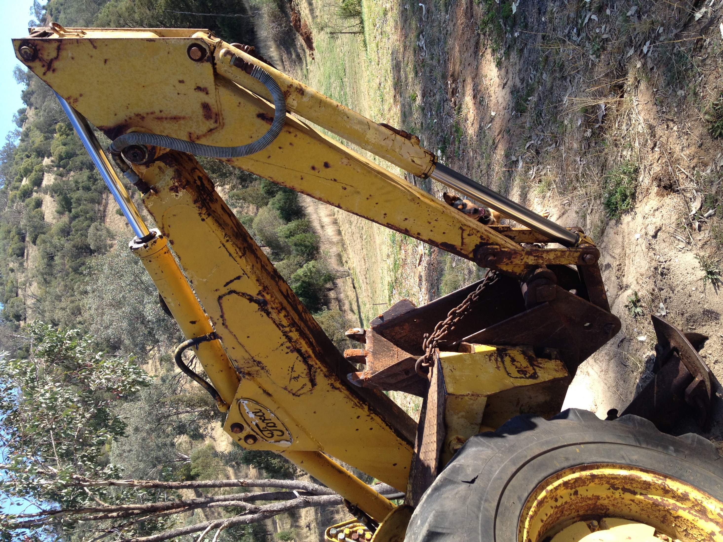

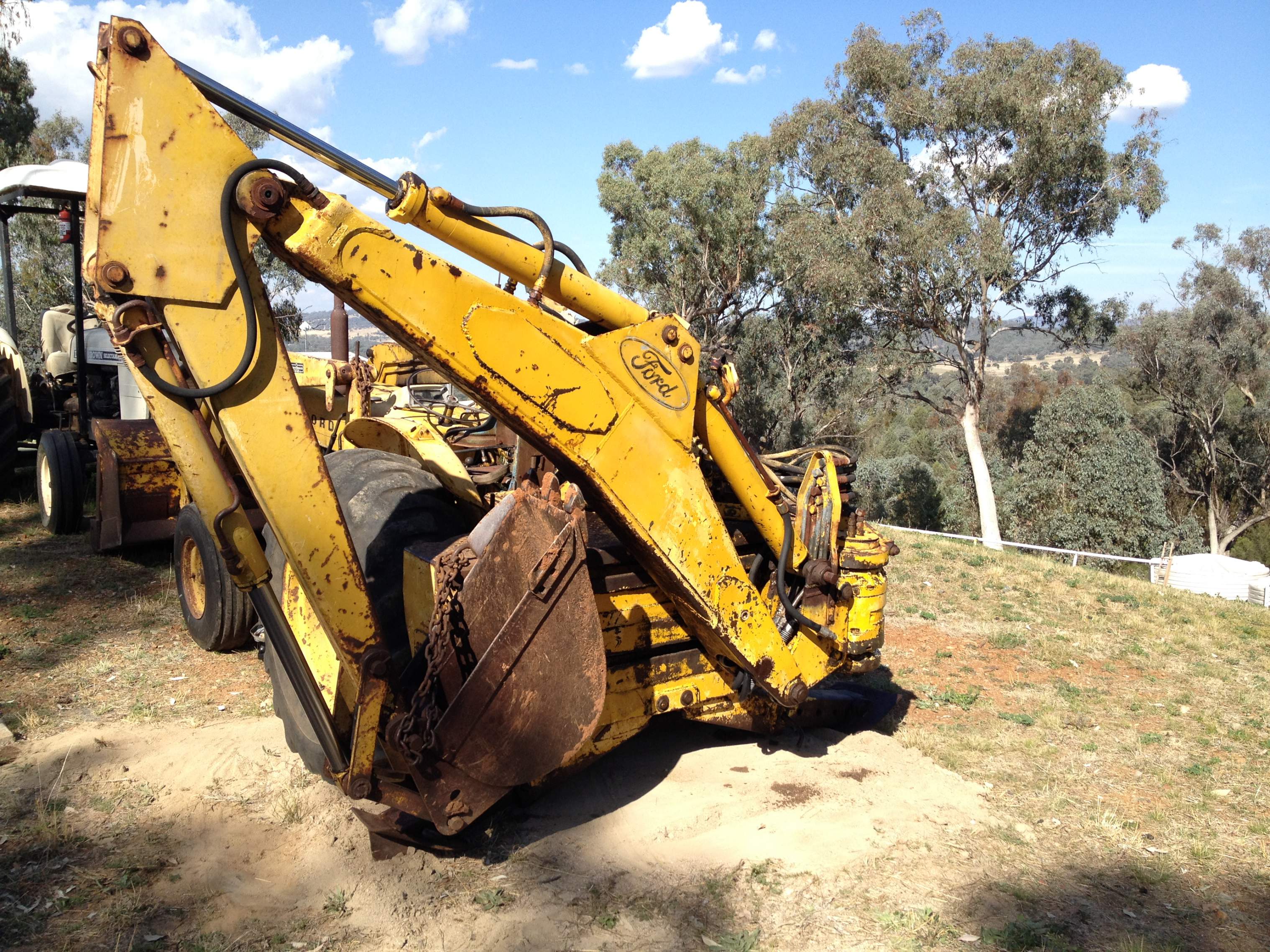

Hi guys, recently purchased a Ford 4500 TLB and having a bit of trouble identifying the backhoe. Forums and manuals state it would be a 753 or 755, but reading about the appearance of the 755 (e.g. distance the dipper and lift rams are apart) would indicate mine is not a 755. The pictures I can find of a 753 show sway cylinders, mine has a rotary swing motor? The only tag I can find on it is "19-454" on the back of the backhoe control console. I need to order some cylinder seals etc. but don't know what to ask for if I don't even know the model of the hoe!? Will try to link up some photos. Thanks.

Here are the photos, hopefully someone will be able to help. :)

For anyone following this post, TractorTech provided the following information via another question I asked:-
"You can look up the 19-454 on the online parts book and it shows you the sections relevant to that unit. Being that it is a side-shift backhoe, not very common in the U.S., it makes it a 752. I think that is a 10' hoe in the 755 series."
/ Ford 4500 Backhoe ID #4
Loopman, 19-454 is the 'true' model number for the backhoe of the 755 series backhoe attachments (not to be confused with the 755/A/B tractor loader backhoe). And yes, it does have a swing motor on a side-shift frame, not a center pivot with swing cylinders.
You can use 19-454 in the online New Holland parts book to look up the parts specifically for your backhoe.
According to the book, both the crowd and lift cylinder use kit 309946. The illustration included is for the lift cylinder.
Cylinder Packing, 19-454, 19-494, 19-561, 19-562, 19-617 thru 19-620, 19-696 thru 19-698, Includes: Ref. 7 thru 14
