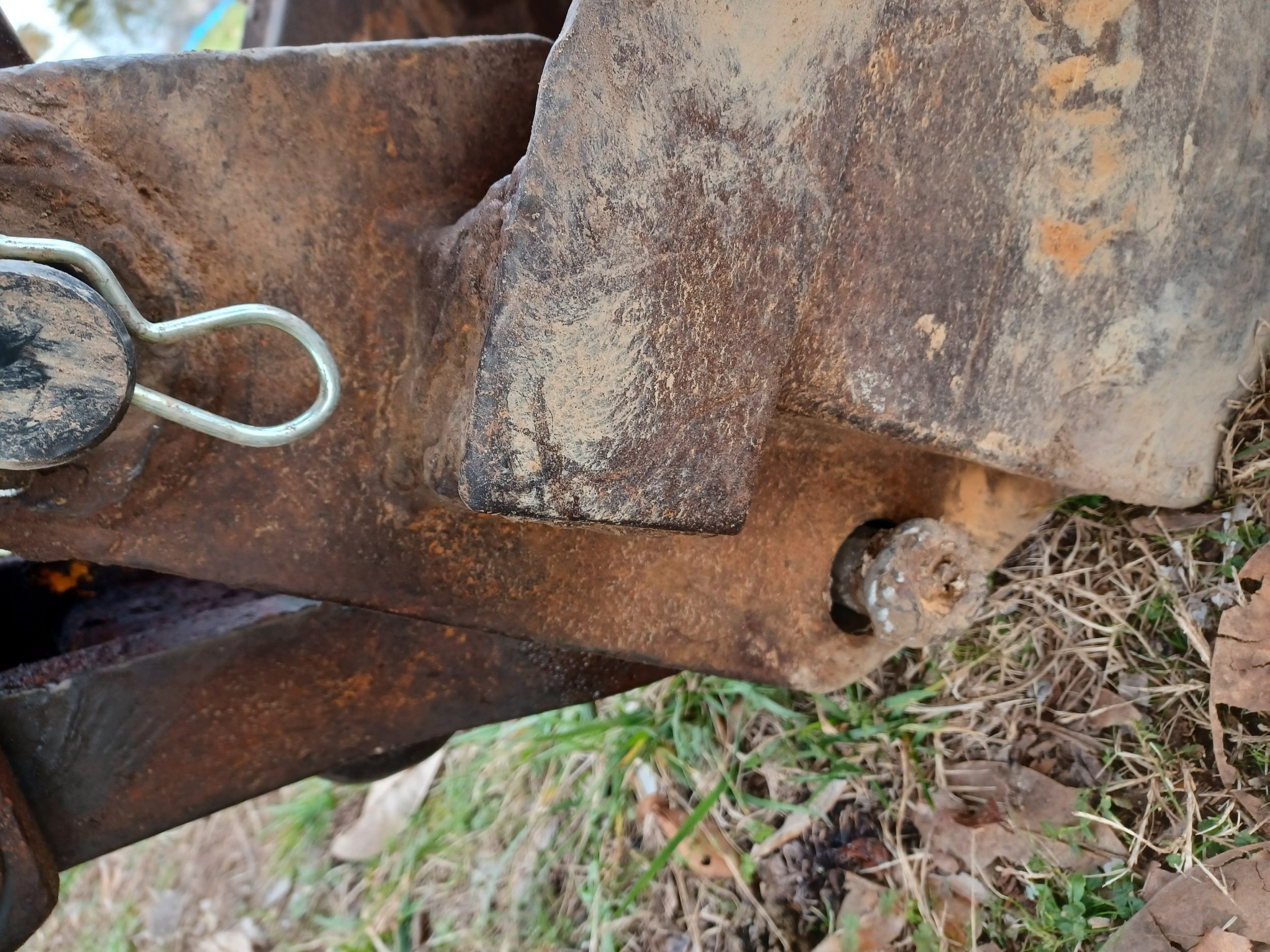

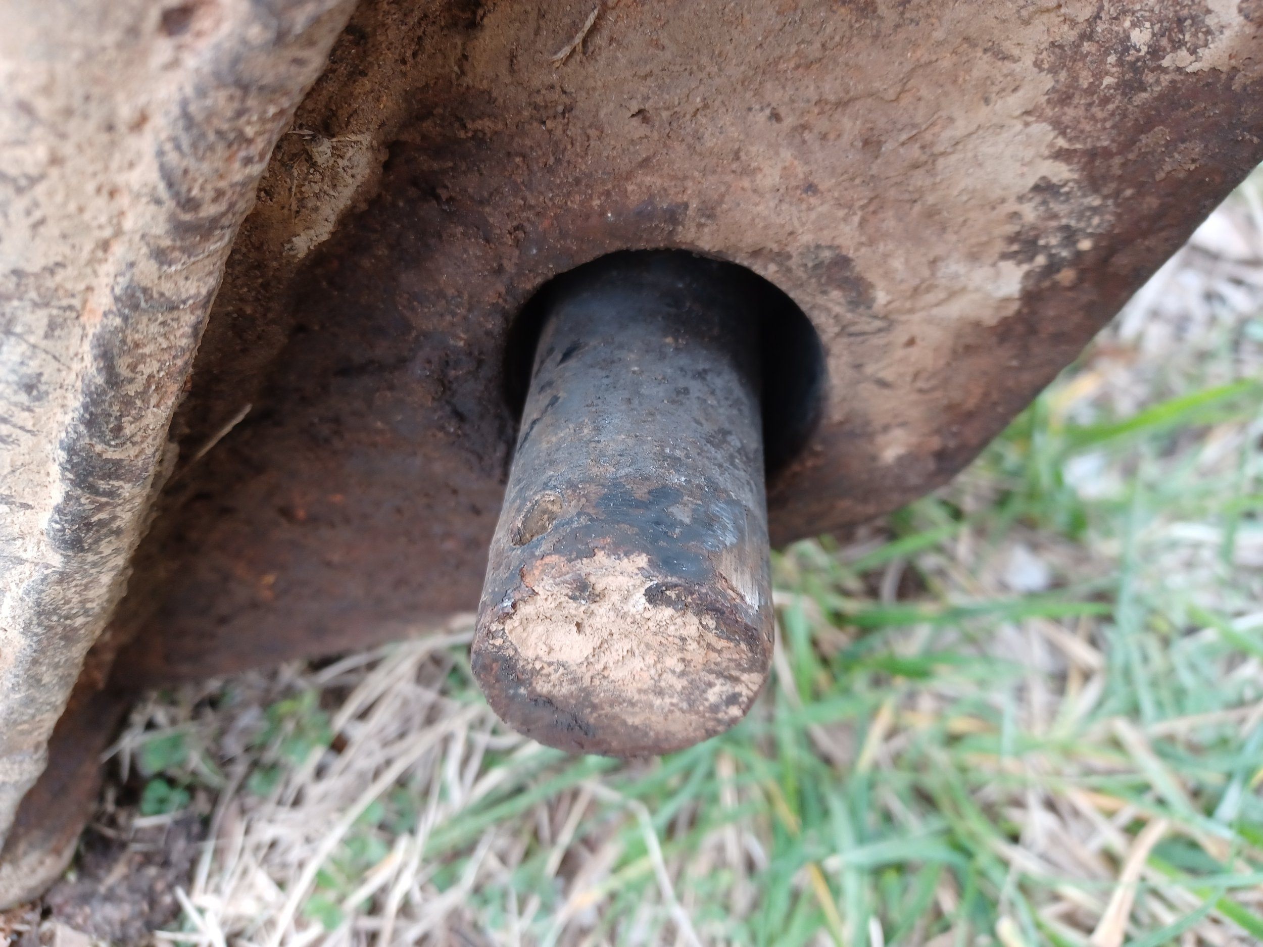

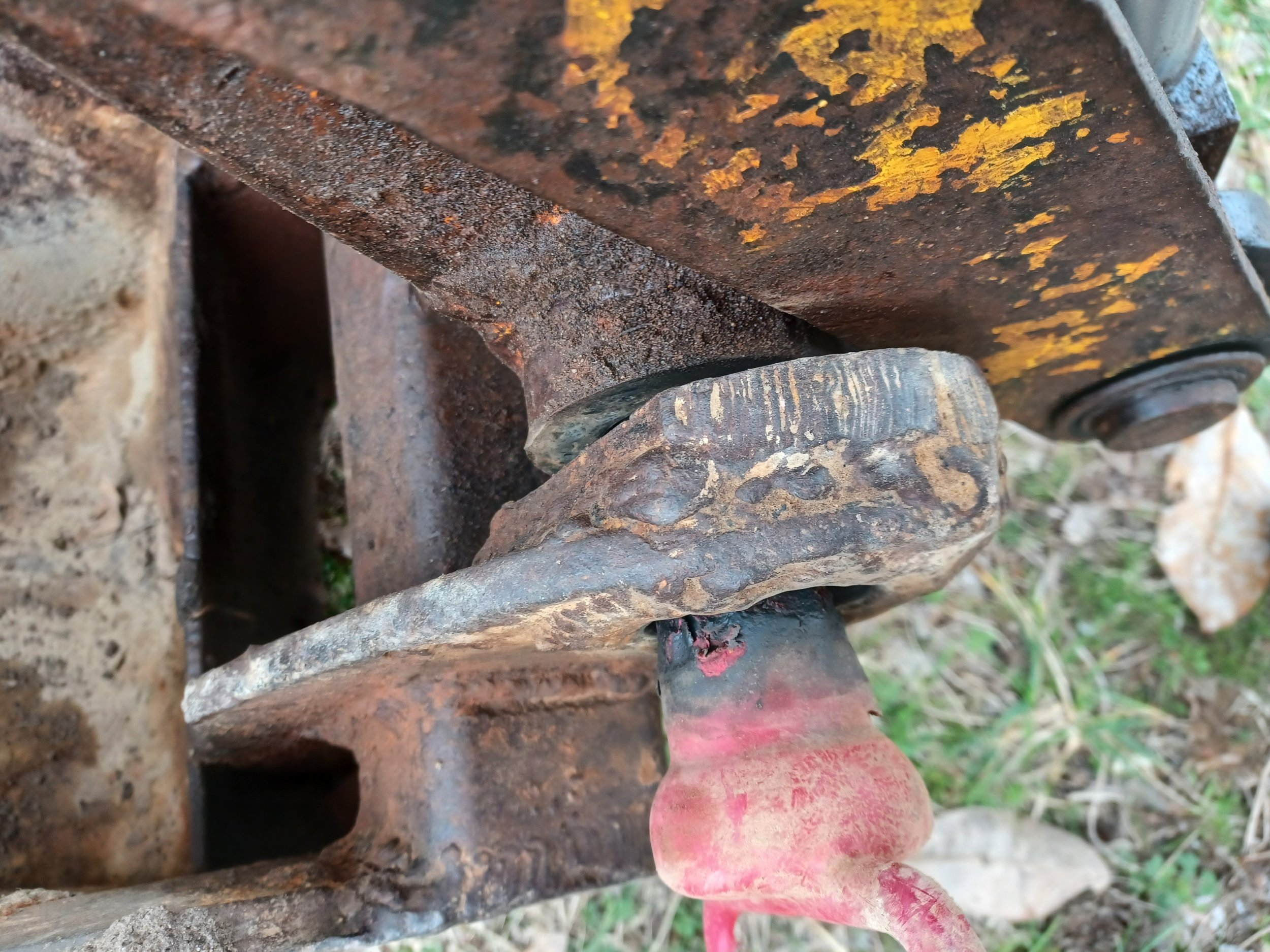

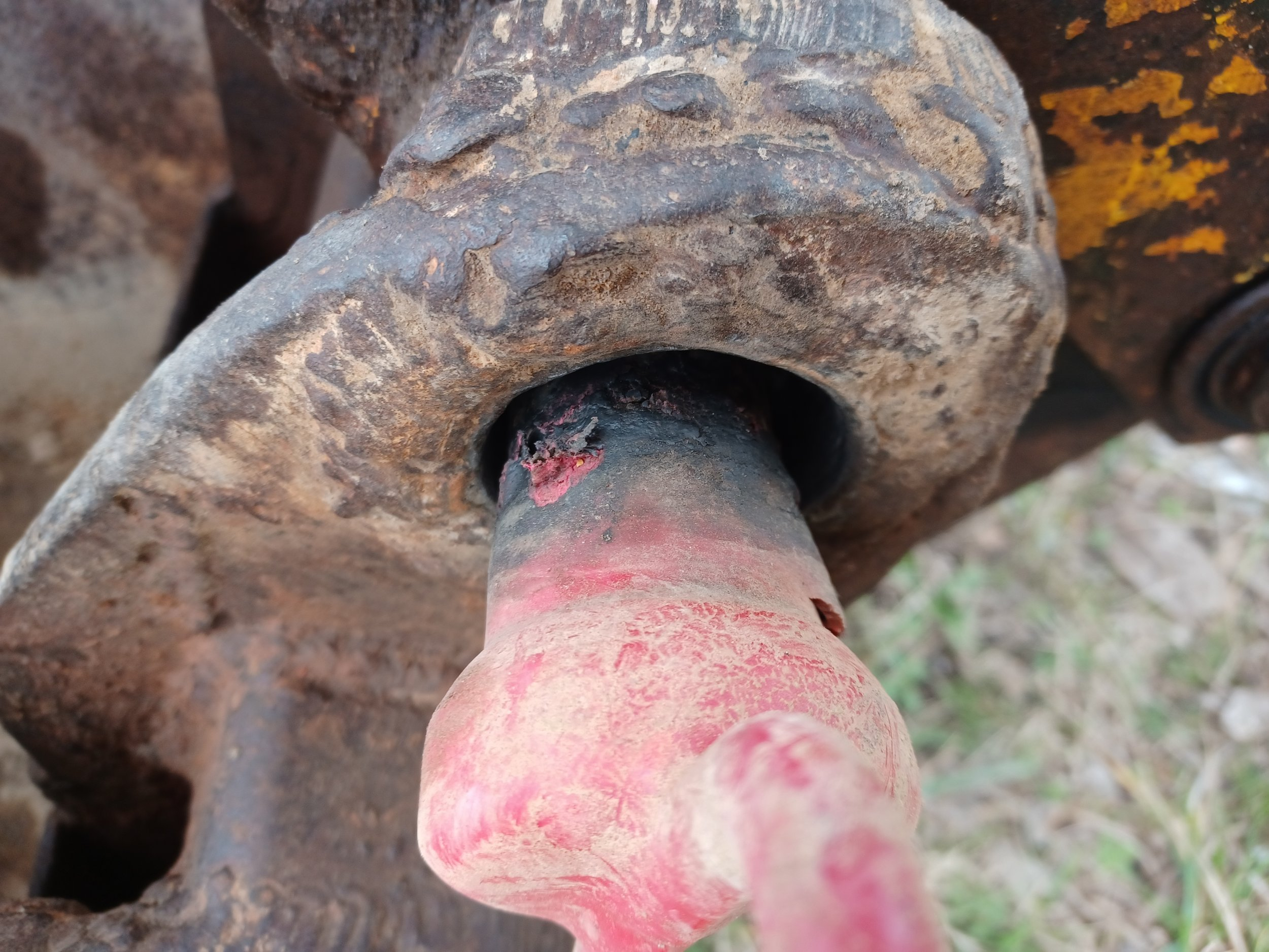

This is what I'm working with. Call me stupid but I don't think I see any kind of bushing in their either.

I would think that the too small pin hammered out the bushings long ago, hate to see what the end of the stick looks like!

Bushing is in the boom. Looks pretty tight to me. Learn to operate it and the slop won't bother you a bit. Or, you can spend a few grand on new bucket ears, pins, boom bushings. I mean, if you gonna fix any of it, you need to fix it all. Like pop said, you can't polish a turd.
Or just keep it greased and keep rolling along.
