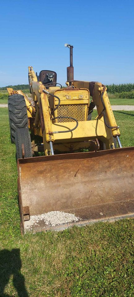

Hi all.
I bought an industrial loader/backhoe from a local meat packer last week that was advertised and sold as a 1980s Ford 755 for $4500. It didn't take me long to figure out with a 3 cylinder diesel it's not a 755. It took me days to understand where people were saying the ID numbers are, but I found them yesterday, and I'm attaching a photo. Having a hard time deciphering just what the numbers mean. If it's a 4500, what year was it made? The model number seems to indicate it's a gas model, though it has the diesel engine in it.
The tractor ran pretty good when I tested it in their field, although it backfired constantly when opened up, there's hardly a neutral position on the power reverse shifter, so hard to get in and out of neutral and shift gears, and there's some leakage in a couple hydraulic cylinders. I drove it home about 14 miles, and right off the RPMs were going up and down quite a ways running about 2/3 throttle. The temperature was getting toward the top of the meter, around 200, so I shut it down a couple times to cool down, although I see now the temp meter shows 160 when it's cold, so a new meter is in order. I got about 3 miles from home and stopped for a minute, but when I restarted at idle throttle in gear to avoid gear grinding it wouldn't move. I observed liquid bubbling up from the boot of the shift lever. I had to leave it set til the next morning and it moved fine then. After getting it home and playing a little, it seems to be slipping terribly in reverse, can't get it to move at all in reverse without increasing RPMs significantly. I took off the trans fluid cap and the fluid is milky and was at the bottom of the gear. I put universal hyd/trans fluid in to cover the gear. I don't see a level window or dipstick. There's a lot of play in the forward/reverse lever, which I haven't looked at yet.
The hydraulic fluid in the front reservoir was low, too, and I brought it up to level. That seems to be clear, but the loader stutters from 2/3 up to the top. I'm changing oil and putting anti-stiction additive in to clean it out.
What do you think? It's obviously an older tractor than I thought I was buying. Should I go return it to them? Looking at available loaders and backhoes it seems I may not get a comparable running unit of any kind at this price. I don't need any more power than this will supply. It's actually above the range I was looking for.

"45021F" will be a 4500. IIRC, the backhoe is a 752, but don't hold me to it.
/ Ford 5400? Year? #5
Looking at the pics I agree looks to be a 1966-1967 4500 The hood louvers were dropped in the 1968 models.

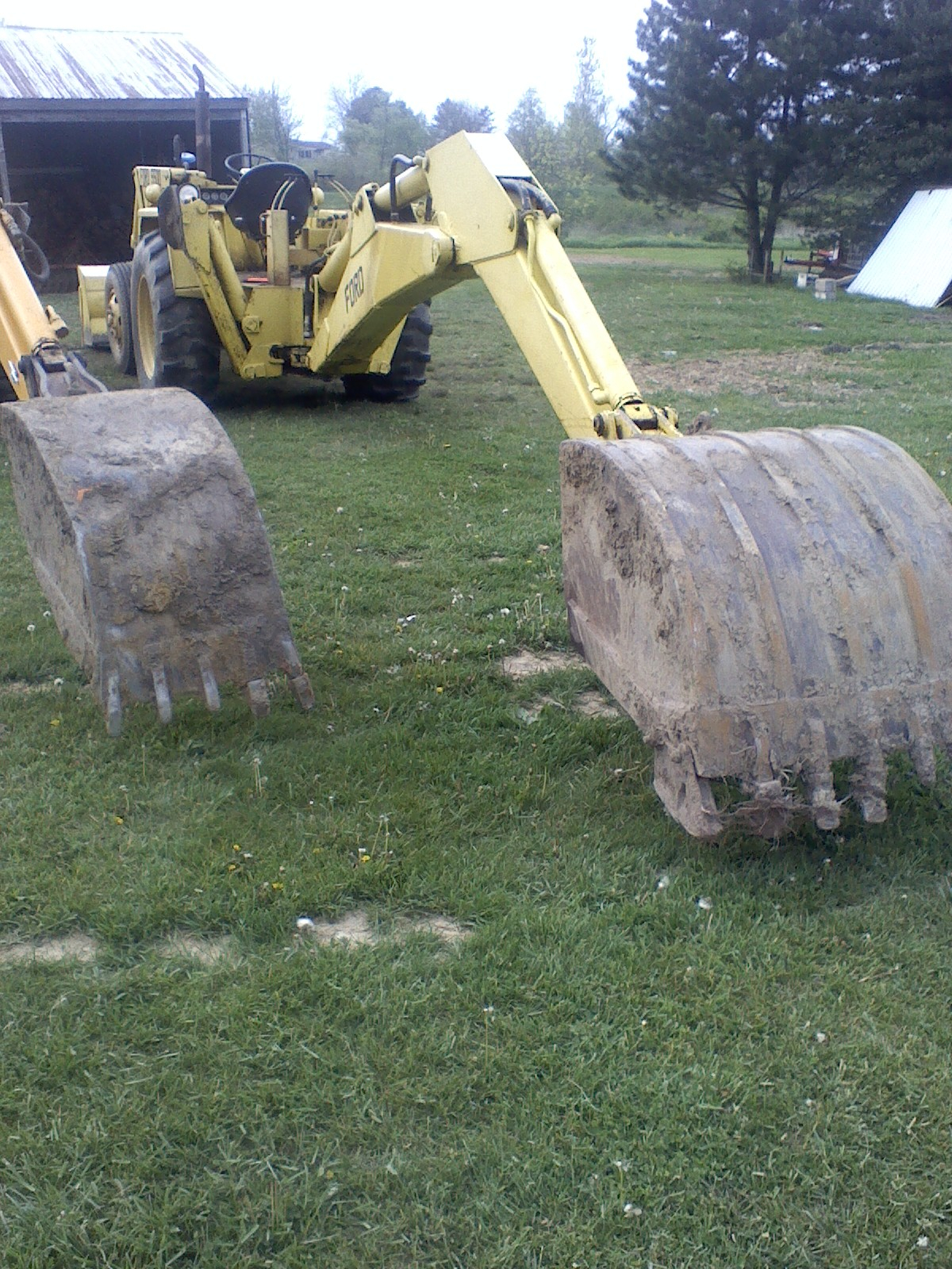

But I think the backhoe is a model 755
The crowd cylinder and lift cylinder pin spacing on the boom is wider on the 755. The 752 is the side shift model with rotary swing.
The 750 ,753 and 755 are center mount
750 and 753 were used on the 3500 model.
Not certain, but the 4500 may have been available with any of them depending on how it was ordered.
750 was a 10 foot, 753 called a 13 foot, and the 755 was the 15 foot version.
I recently bought a working but rough 1977 Ford 550 TLB with the 755 and from what I can gather the 4500 is the predecessor.

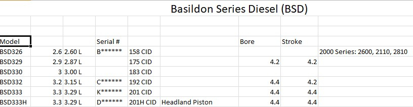

The giveaway for it being a 4500 is the "hard nose" square radiator shell. The other models had a sheet metal nose like an ag tractor.
The engine can be identified by this chart I made up by matching the S/N located at the bottom, RH center of the block OR RH front bottom boss of the engine. The S/N is what identified the original engine (it could have been rebuilt and bored out to the larger size) and the date code will be located in the same area that identifies the original build date. It should have a 333 engine in it. The 333H didn't come out until the 80's. My chart is only for diesel engines

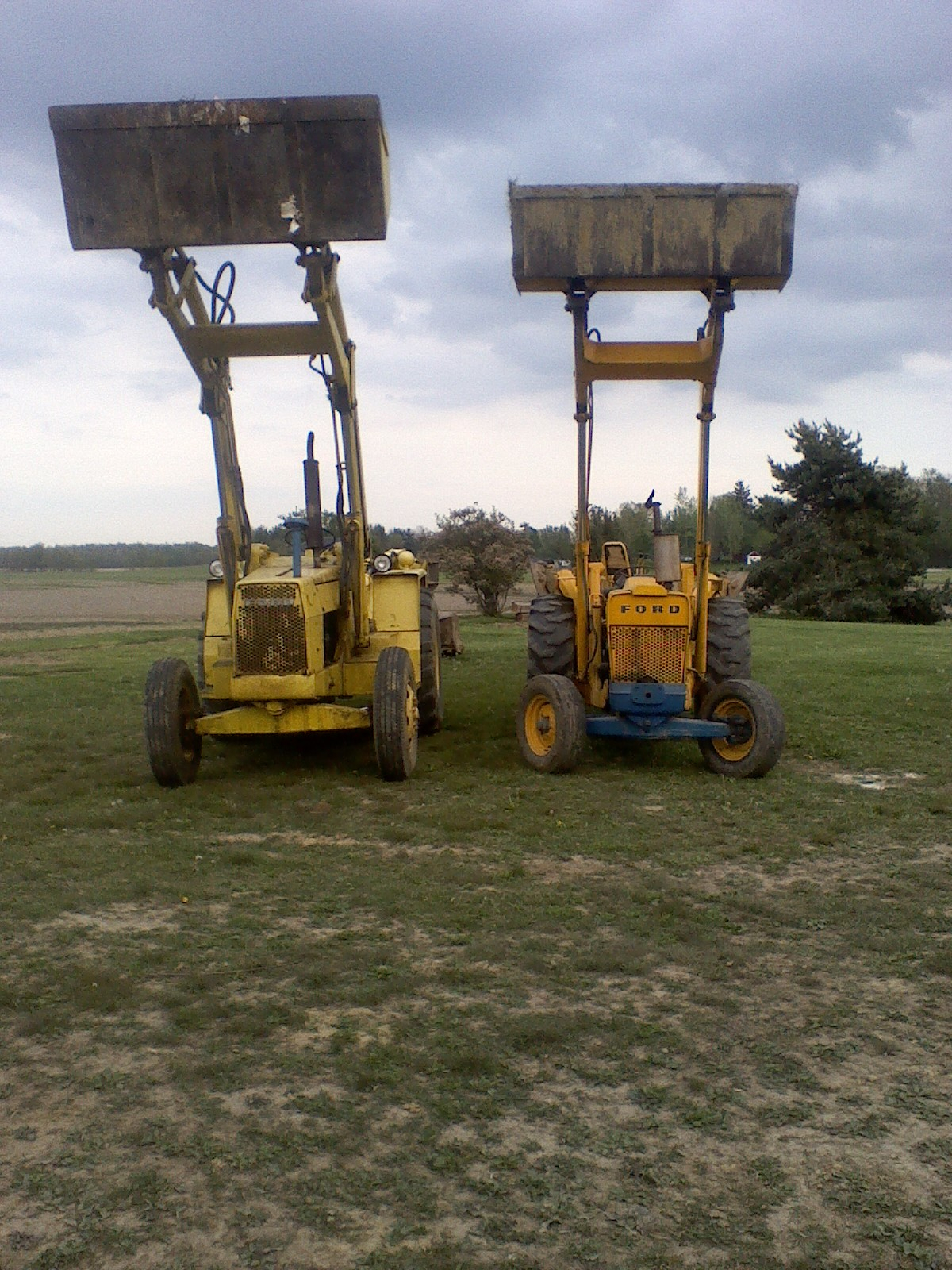

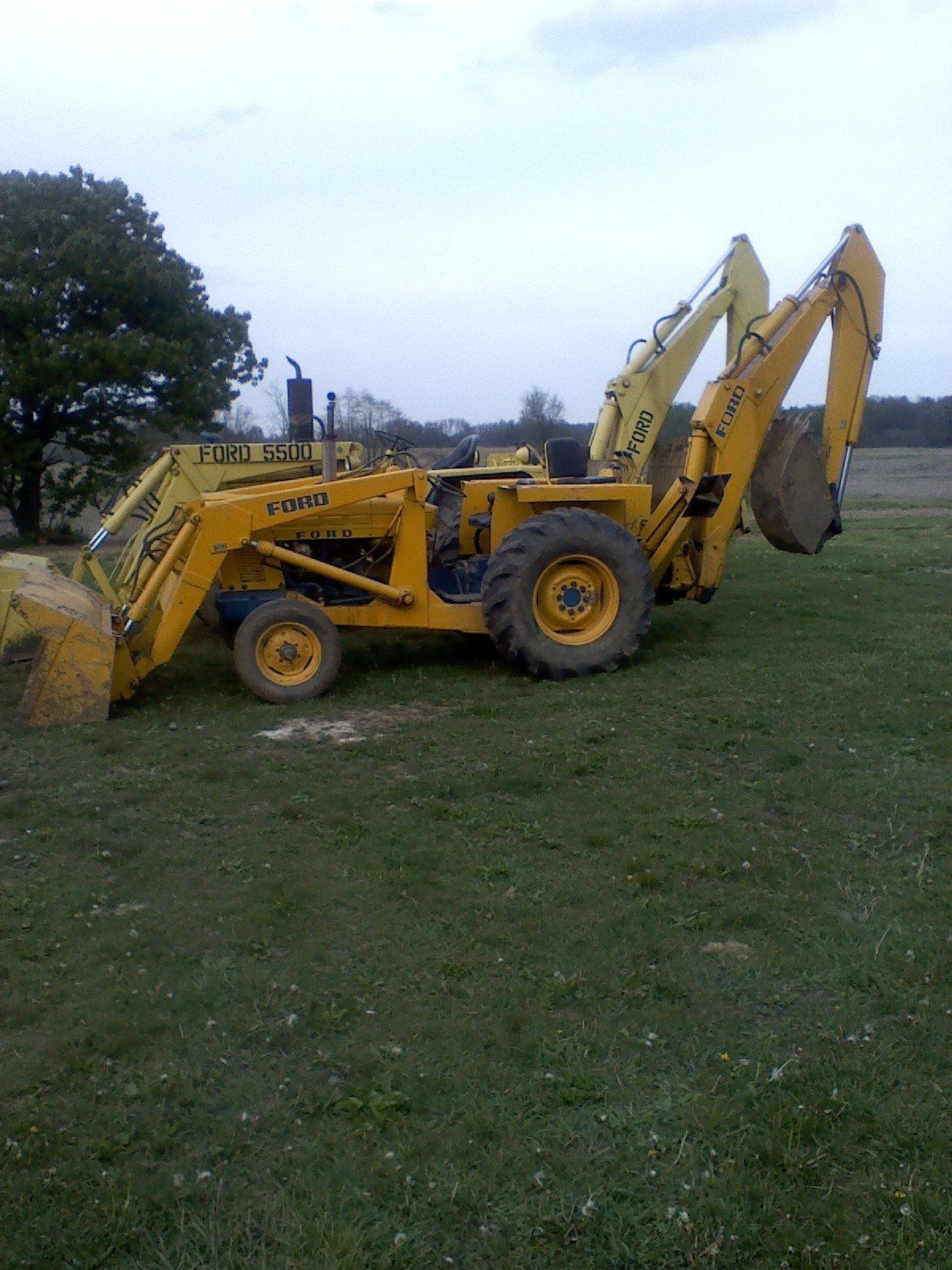

Here is a side by side shot of a 4500 and a 5500

For sure LD1, there is a big, big difference between the 4500 and the older 5500, 6500, 7500. The latter have a Clark transmission, which was continued on with the 750, 755... TLBs.
The 4500 has a Ford transmission with a Borg Warner shuttle assembly in the front end of it. Much simpler and smaller overall. Same basic housing as the ag tractor versions.

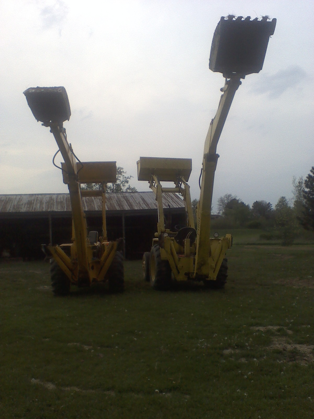

As far as the backhoe goes, as various replies have said, it definitely looks like a 755 backhoe attachment. But to make sure, look at the control tower facing the operator seat. If it is still intact, as SD455DAN pointed out, there is a "true model" of 19-388, 19-389 or 19-390. 19-390 is the 755 or 15' hoe. The loader has the same 19-... #, but as LD1 pointed out, it is a 740 loader as the 4500 only used this loader.

I am in agreement with Dan that it IS the 755 hoe. The 10 and 13' versions did have much closer pin spacing at the end of the boom cylinder and base of the dipper cylinder. Can spot the smaller hoe's a mile away.
The 740 loader was a beast in comparison to the 730 or 735 loaders. Almost too much for the tractor IMO.
