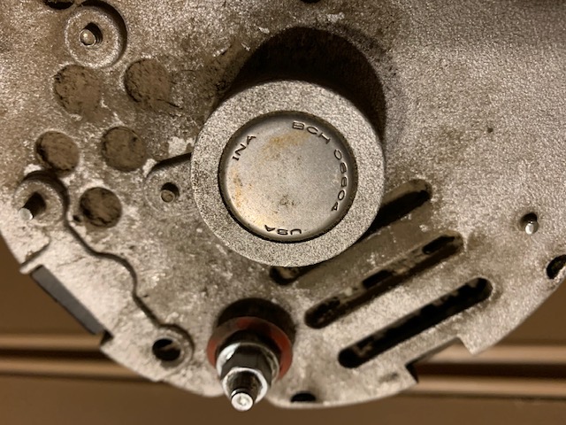

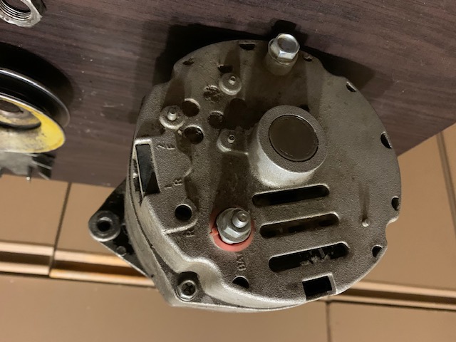

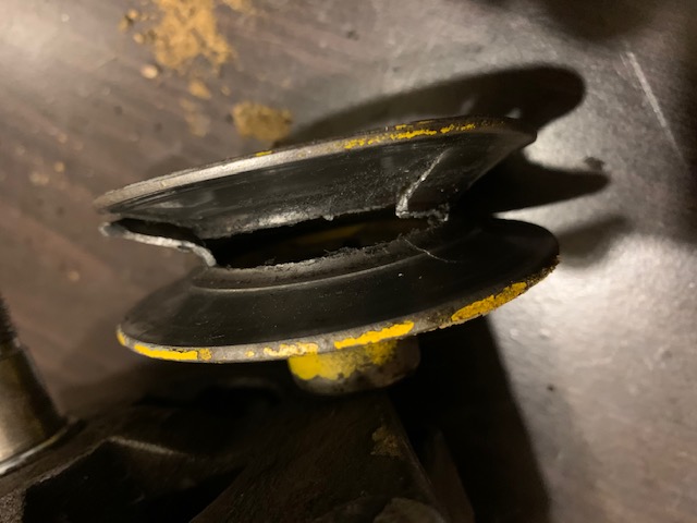

Aaron Z,
I'm attempting to attach 4 pictures of the alternator.
You mentioned that you wanted to see the shaft - perhaps because I mentioned the characters stamped into the back -- so I included that. Other than that, the front end of the shaft is fully round -- no flat sides, no groove for the square key I mentioned that the pulley seems to allow for.
One picture shows that it is a one-wire configuration. Given that the electrical system is positive ground, that one wire would actually be for the negative, I guess.
And the other picture shows the break in the pulley.

I'd be curious to know how it broke; I can sort of imagine how one would fail if it was too tight, but I would have thought that the bearings would fail first.

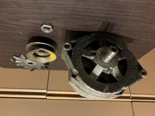

flyerdan,
I was able to remove the nut. Although there is a hole in the front end of the shaft as you mentioned, it doesn't seem to be hex. But I was able to remove it by hanging on to the fan blades.
I couldn't tell you for sure what made it break. I do know that it occurred while I owned it. That belt also drives the water pump, and, no surprise, the tractor overheats in just a few minutes with nothing to push the coolant around. That behavior only started recently. The only diagnosis I could come up with is that the belt was oily, and so it probably made the belt slip, leading to the over-tightening. But what you said makes sense too, i.e. that the bearings would take the abuse initially. The shaft seems to spin smoothly as near as my fingers can tell.

That looks like a "standard" GM 3 wire or 1 wire alternator that has been modified to run on 6v Positive Ground.
If the non-threaded portion of the shaft is 5/8" in diameter, a pulley such as: https://www.amazon.com/DB-Electrical-APL5000-Alternator-Prestolite/dp/B00Q8LRT72/ should fit (that pulley is for a 5/8" wide belt)

Correct, the alternator pictured does not have provision to run a tachometer drive.
Q6: My search also introduced me to the term "self-exciting alternator", with one forum member stating something about requiring the engine to be running at higher RPMs in order for the alternator to actually charge the battery, and the response was that the 3-wire versions were better in that respect. Is that true? And should I care about that and change to a 3-wire alternator? Here's a basic question demonstrating my lack of experience in this area: Given that the current configuration expects a 1-wire alternator, if I were to convert to a 3-wire alternator, where do the other 2 wires go?
The biggest wire is the charge cable, then there is a 2 wire plug (where the 1R and 2F terminals are on your alternator), 1 wire is the voltage sensing wire (would go to the fusebox on a car, to make sure that the alternator knows better what voltage the electrical system is at. On my David Brown project, they just ran it to the charge terminal). The last wire is the excitation wire, that goes to key switched power (often through a lightbulb so that it will glow to warn if the alternator fails).

Don’t waste time in the auto parts store. Measure out the puller needed and then go to an industrial supply place and get one that matches your needs.
