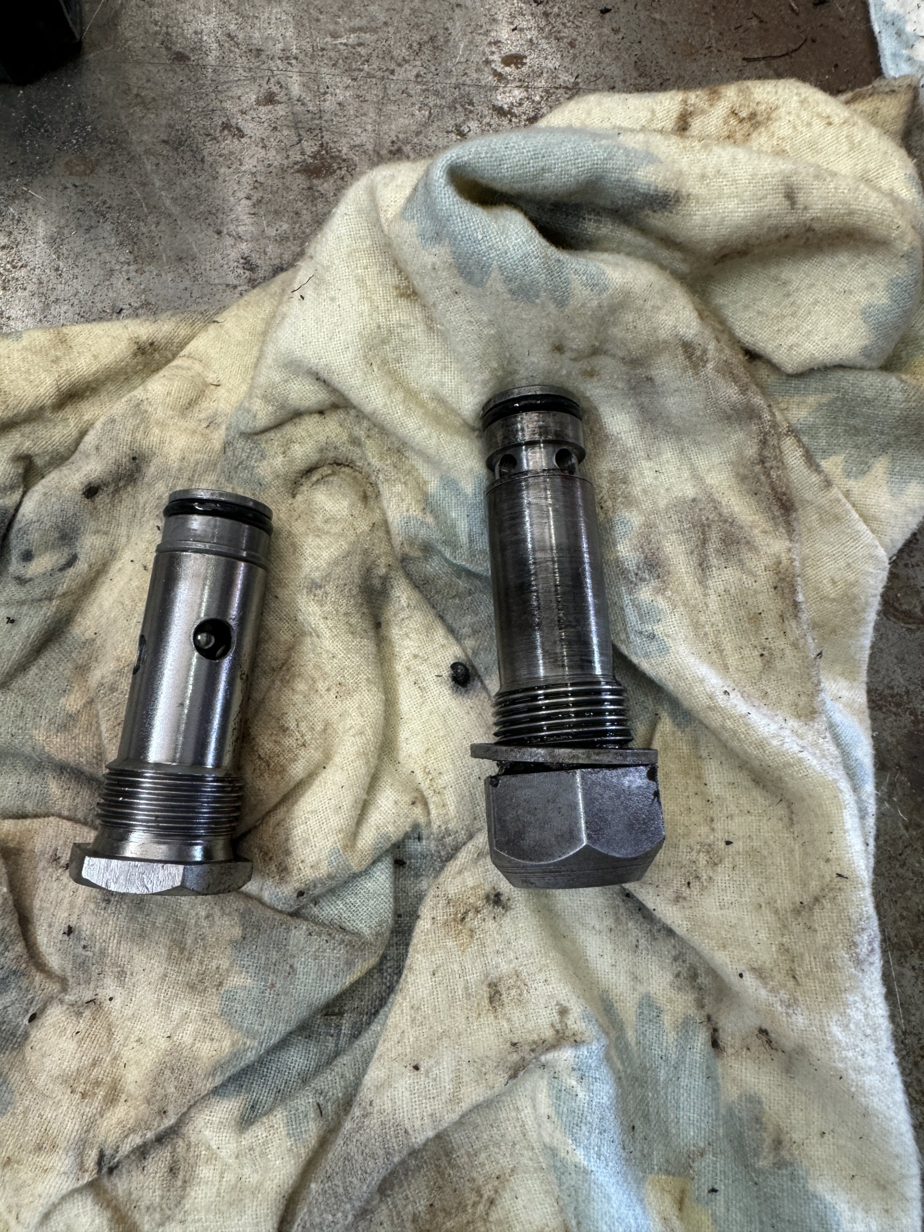

I am in the process of rebuilding my Ford 2000 top lid and I believed I had ordered correct parts.
So far everything has been a 1 for 1 likeness..Until today.
I removed the pressure relief valve from the bottom of the hydraulic case and compared to the new supplied valve. There appears to be quite a bit of difference.
I am guessing I've ordered the wrong part. Can anyone assist? I believe by the serial numbers its a 1968 Ford 2000 (3cyl diesel).
Thanks in advance.
Marty

My thought is the valve design has been updated, we are talking about a nearly 60 year old machine. As long as the valve fits and it looks to me like it will, I would screw it in and run with it.

Thanks John0829. I've googled as much as I can and everything comes back with the same type of valve, so I'd say you're correct. At least its easy to get access to if I need to swap out.

The parts manual indicates C7NN638E replaced C5NN638C, which I suspect was the original in mine.
