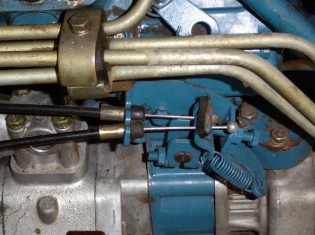

MIkeWard said:
Found a couple of problems.
The outer throttle cable is very loose and not really attached underneath the floor. It is connected to gas petal and the pump.
You can see how loose it is at the pump. Do i just need to stretch it out and clamp it in several places?
The other thing I found was a broken wire on parking brake sensor. Should I try to repair it by soldering connection?
A;so looks like it is missing a nut to attach it to the parking brake bracket.
So far so good
Mike
Mike,
So far so good. now that you have your MASH unit ready it's time to operate. On the throttle cable, a bit if play is okay , look on the other end of cable may be able to adjust the tension some. On the wire, if you have enough wire as it seems you have I just take the right crimped connector that I can find for the switch and re-crimp two brand new connector. there is nothing wrong with the soldering the wire. If I o that route, I'll put a piece of heat shrink tue in there before I solder, once the soldering is done pull the heat shrink over the soldered area heat shrink it to make it moisture proof.

I was referring to the play at the end of the throttle cable .
The outer one is completely flopping around and not clamped down in any way.
I will look for brackets to route it through. A couple of zip ties should also help tighten it up.

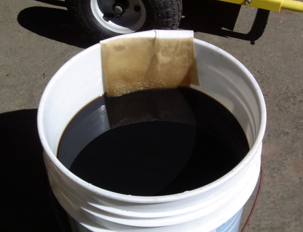

Got a few more things done today. I think I mentioned that I'm in no big rush to get done.
Drained the transmission. Boy the color that comes out the bottom is completely different than on the dipstick!!
I took a pic of a paper towel dipped in the stuff. How does it look what do you think?

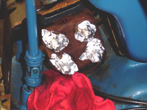

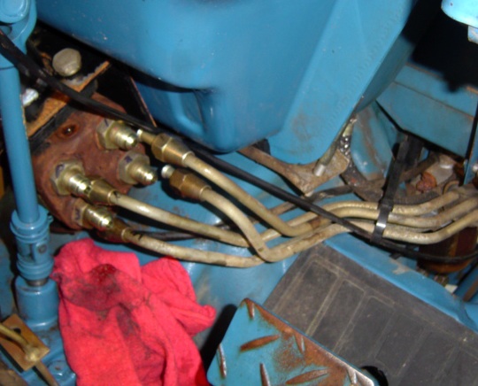

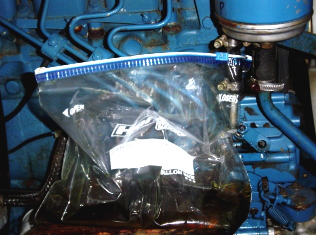

Disconnected all the power steering tubes after draining the fluid. I left the four hoses in their common brackets and removed the two brackets from the engine
I used a 1 gallon ziplock bag fastened around hose to drain reservoir. Seemed to work pretty well and did not leak. I placed it in a bucket just in case. I used tin foil to cover all open fittings.
I had the same experience as well Mike. You're going to remove suction and discharge piping off of the hyd pump to split the tractor. What I have done on mine I removed the inlet screen in the differential housing (need suction pump removal). All return hyd fluid come back to the differential and loose it's velocity quickly, that causes sediment junk of all sort to settle down. I used a combination of shop vac and and a collection can to suck up all the stuff from the bottom of differential housing. I did not want to get the oil in to my shop vac. anyhow, I was able to suck up close to two quart of snot out of the housing, it had the consistency of loose cheese curd. it probably not a bad thing to clean the inside. I used a 3 feet piece ofg garden hose as my suction tube and shoved it in the housing sucking up the stuff in to my collection jar.
JC,

OK I'm up to removing the suction and discharge piping off of the hyd pump. When I read your post I did a double take and went back and reread the repair manual. It did not mention taking them off for the 1920. Then I read the section for the 2120 and sure enough remove em.
The manual says to swing the inlet tube out of the way.
With the loader and BH brackets on this is impossible. So I guess its remove the tubes completely or take the brackets and
loader hydraulic controls off first.
At this point I'm worried about damaging O rings on the suction and discharge piping off of the hyd pump You can see this in the pic.

JC I removed the suction and discharge piping and got a good look inside and it looked pretty clean.
I had quite an oily adventure today. I had already drained the tranny (almost 4.5 gal). When I went to remove the suction and discharge piping I knew there would still be some more fluid to drain ( little I thought) Note for the future DO NOT use an almost full container to catch what you think will be coming out. Another gallon and a half came out overflowing the container. Boy was I hopping trying to get another container quick and sand to throw on the oil as it spread all over and past the plastic I put down.
Finally took off the 4wd shaft Next will be the split and finally the clutch.

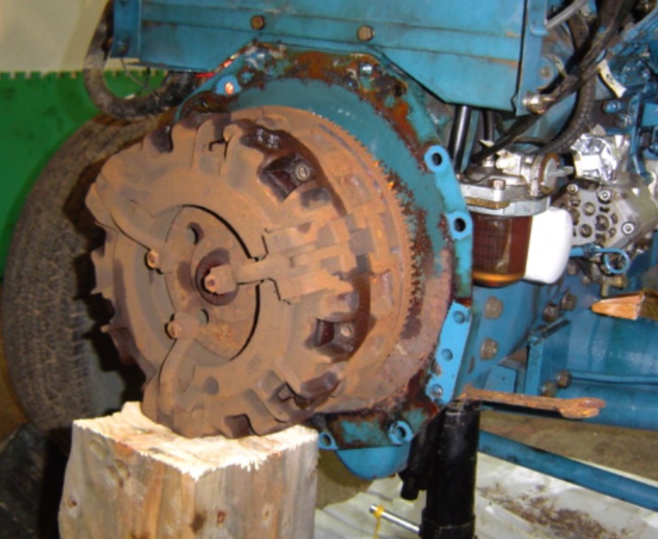

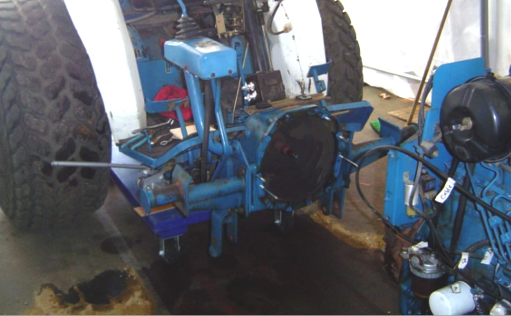

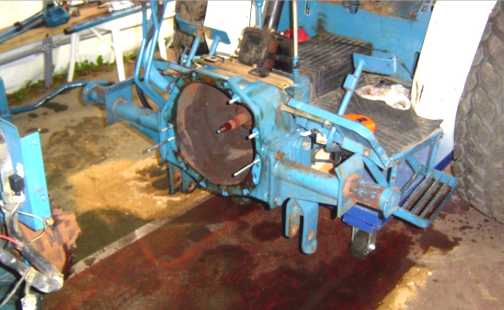

Today's the day. Chocked and blocked the front.
supported and lifted the rear (a bit).
Got a come-a-long attached to my truck and slowly split the tractor.
WOW did it come apart easily.
Just had to break some rust holding it together.
