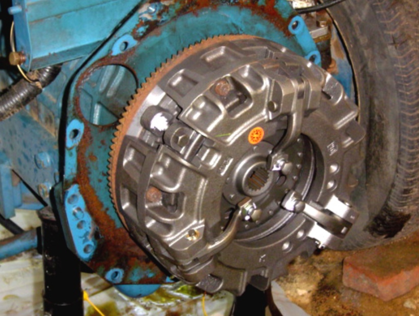

JohnnyB if you look at this picture
See the bright clean blue paint on the metal behind the clutch...
That's where the bolts are that must be removed to get to the clutch
even if the dealer did it by removing the engine.
If the paint was still unbroken on those bolts the clutch could not have been touched.

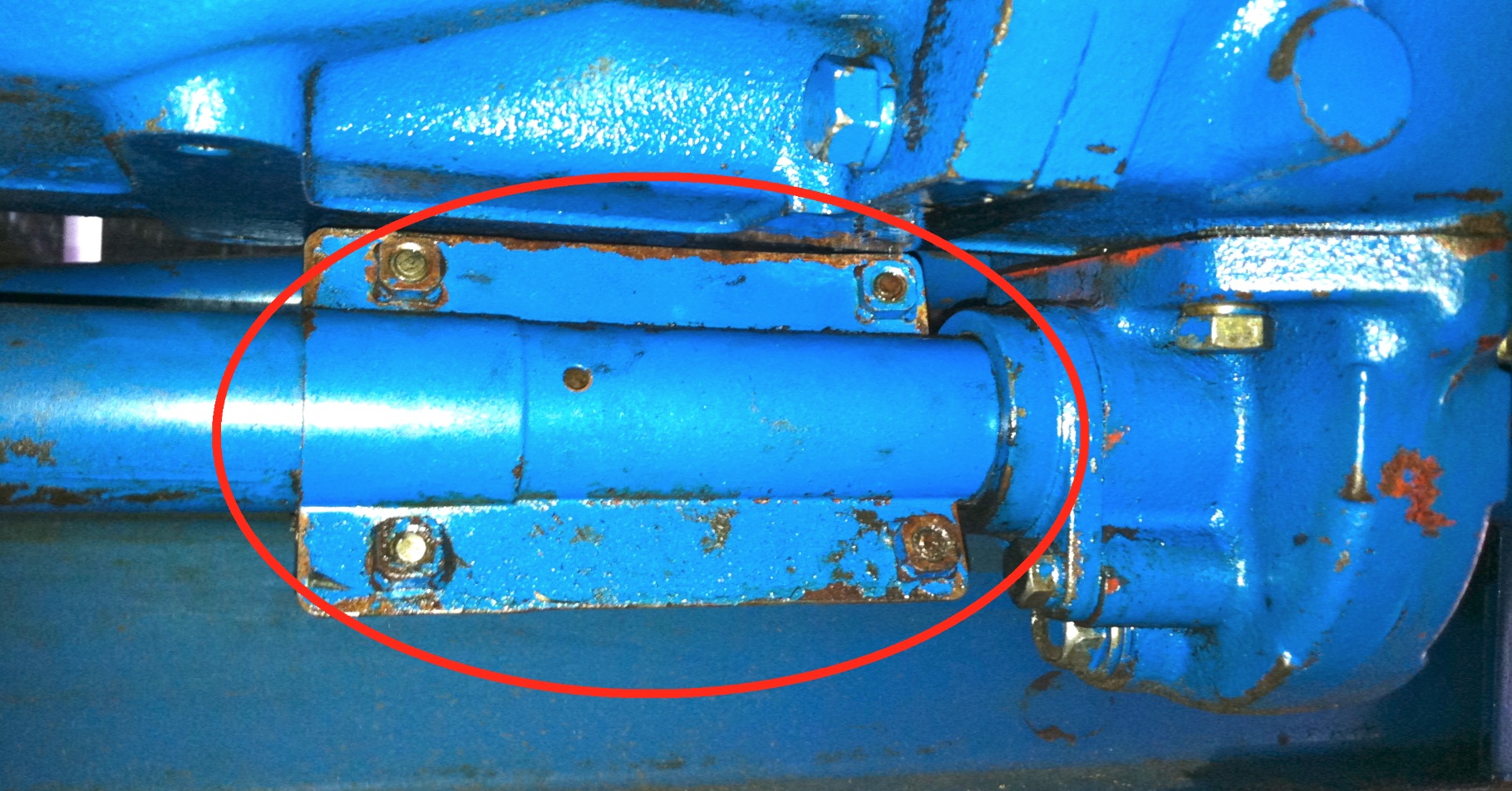

this is the rear portion if the driveshaft for the front axel
removing the 4 bolts will allow access to the drift pin that has to be tapped out to allow the shaft to drop away so the tractor can be split
