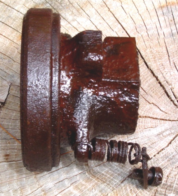

MIkeWard said:
JC thanks for the reply and info.
I got the bearing off and cleaned up the part it's mounted to.
What a difference!
I wonder if this tractor was in a flood. I didn't mention it but when I removed the outer covering around the 4wd shaft there was some water in the end where it goes into the front axle. That and the amount of rust in the clutch housing- and look at the clutch rust its a wonder the clutch was working at all.
I know Soundguy and others were talking about UTF fluid and someone mentioned that used hydraulic fluid could be used as a rust inhibitor- spraying it inside car doors. I'm thinking os wiping the inside of the clutch housing with it.
Any opinions on this?
Hey Mike,
looking good , getting there ..slowly but surely. I tend to agree with you about the flooding. This amount of rust is out of normal, even if the tractor sat outside you'll get some condensation in the rear differential since the transmission oil and hyd system is a vented (atmospheric) system and is not sealed, if some gaskets here and there dry rotted and allowed rain water to creep in is also another way to get a lot of moisture in. The rust in the inside looks so uniform and causes me to agree with your suspicion. Did you any sign of silt or dirt caked up her and there inside. The way utf or any other oil protect the metal is because of " oil film" or basically a very thin layer of oil that kind of dries our or stays on the metal like a thin film. what this does obviously keep the oxygen out keeping the rust or oxidation in check. if you cover the rust with the oil you still keep the air out. I knew couple of old mechanic that liked to spray a very thin layer of diesel on engine thinking it kind of dries out to touch in time but protect the engine and nuts and bolt from rusting. my preference is to mount a brass metal circular brush on my drill to dry clean most of the rust out first brush and then use a paint brush to coat the metal with used utf or new oil and have a rag to take the excess off and keep it good and well rubbed in.

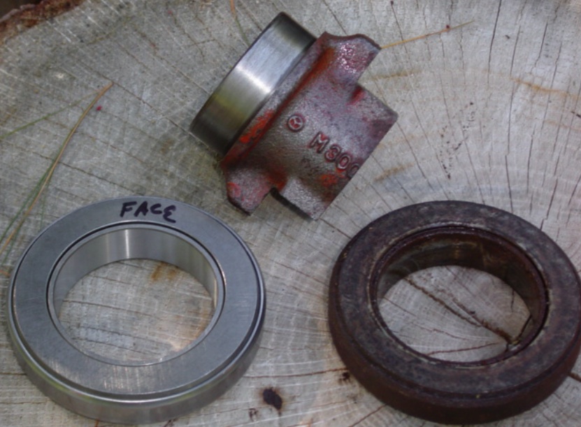

JC
I will be cleaning up with a wire brushes on a grinder and a drill.
The part I cleaned for the throw-out bearing was done by spraying with liquid wrench and then wire brushing. Seemed to work pretty well! When done I'll rub on a coat of UTF.
The more I think about it the NH dealer I bought this from really pulled one over on me!

   / Ford 1920 clutch Help needed #53
Learnt me something new about throw-out bearings.
Wow, that is alot of rust. Wire brush and anti-rust paint ?
Did ya use a alignment tool during assembly ?
