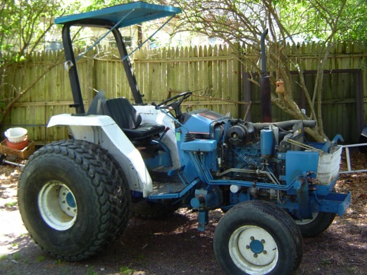

Removed Bh and loader.
The clutch finally was delivered. Boy is it heavy- about 75 lbs.
I power washed the tractor after removing tins.
Removed canopy - I think I will make a better one.

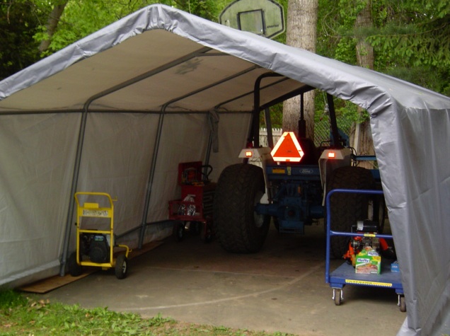

The weather has been rainy cool and lots of things falling from the trees so we bought a temp carport and put it over where I am fixing the tractor. Garage is full so it is outside on the basketball court for repair.

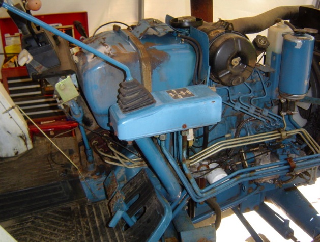

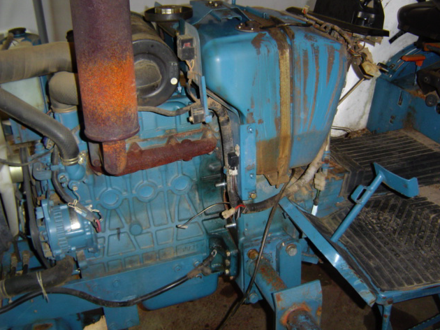

Got the whole dash disassembled.
The whole space underneath the dash had a HUGE mouse nest.
I am lucky none of the wires were chewed.

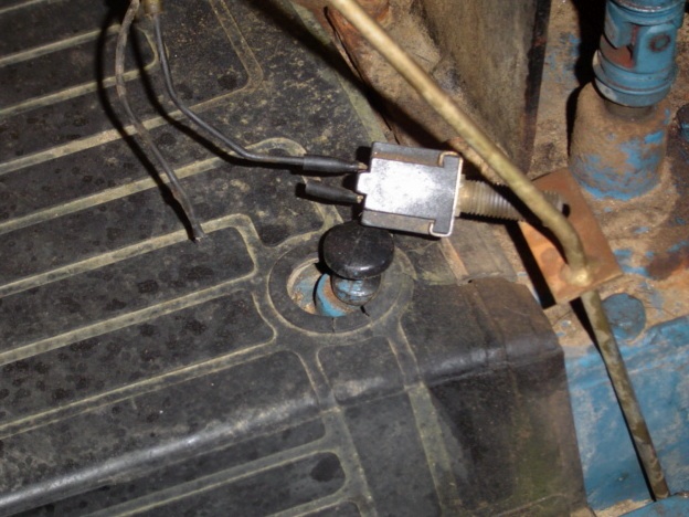

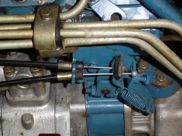

Found a couple of problems.
The outer throttle cable is very loose and not really attached underneath the floor. It is connected to gas petal and the pump.
You can see how loose it is at the pump. Do i just need to stretch it out and clamp it in several places?
The other thing I found was a broken wire on parking brake sensor. Should I try to repair it by soldering connection?
A;so looks like it is missing a nut to attach it to the parking brake bracket.
So far so good
Mike
