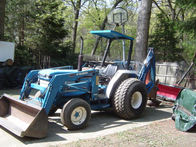

Thanks JC
That's some picture you posted
I'm going to get the whole rebuilt clutch
Messicks has it for $508.(HY-Capacity rebuilt)
Everyone else seems to want $1000
They also (HY-Capacity) have pilot bearing-$14.00 and Release bearing $55.00
I checked their website and called a rep and they don't have it in stock but will send if from Vender ups 22.00 shipping.
Is this deal too good to be true?
They said it was for a ford 1920.
Mike

MIkeWard said:
Thanks JC
Mike
I think it is pretty good deal for double clutch. Although, I have never bough anything from Messicks, I'm sure they are all right as I hear many folks deal with them here at TBN all the time. Got to have a good reason for that.
Good luck and keep us posted on your progress. JC,:)
P.s . By the way , nice looking rig you got there, a bit of TLC and it should serves you a long time.
