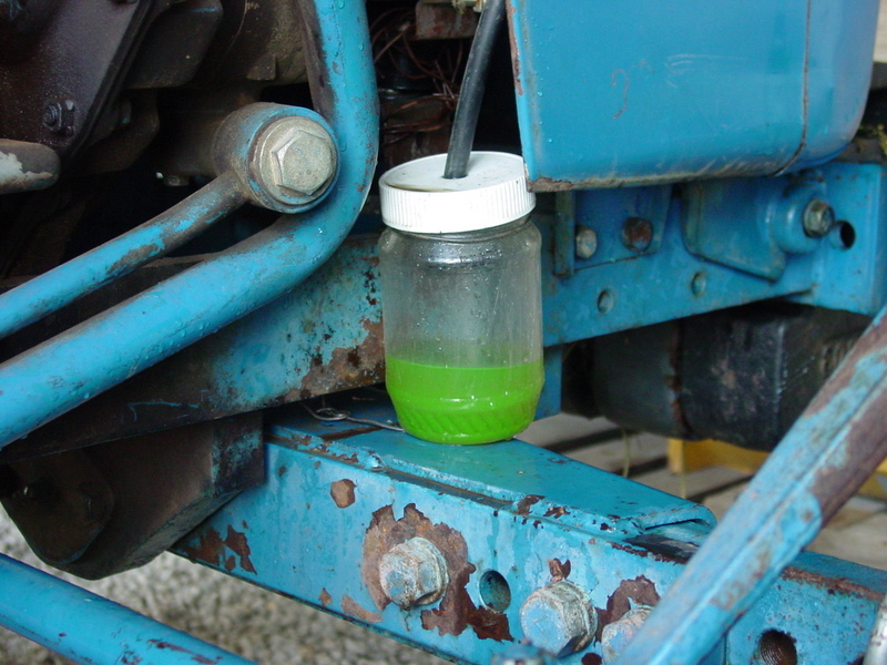

Ditto with what Roadworthy said. Nothing to worry about but do keep an eye on the gauge as a matter of routine always. What I have done was using a clean Peanut butter jar for the last 10 years to collect over flow when engine gets hot. Fluid is sucked right back in as the engine cools off in storage. I secured the jar with some bailing wire ( my go to 1st aid). I taught I have to replace the jar every once in a while but still have the same jar for 10 years and there is plenty where that comes from, costs zero.You might have to get a longer overflow tube based on where you keep the jar mounted to the tractor.
