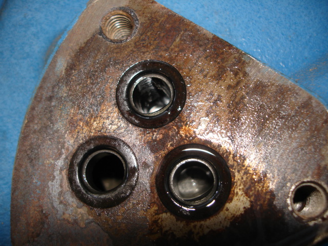

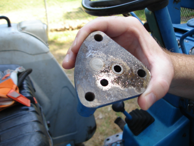

Attached are pics of the backside of the plate and the holes on the tractor. One of the telltale signs this is the right plate is that one of the passageways in the plate is sealed off and on the tractorside all three holes are patent. Also, there is no bolt on the right side of the plate.

If you look on messicks site under 1710 hydraulics 05E01 REMOTE CONTROL VALVE & PIPING KIT W/POSITION CONTROL, 1110, 1210, 1310, 1510, 1710, 1910. The cover for this valve looks like what you have but the valve is missing. I wonder if this tractor had a remote valve and someone took it off.

Well, on Messicks there are two #3's. The plain cover is specified for the 1710 offset and the cover with the valve appears to be for my unit, the regular 1710. Seems like somebody swapped it for the wrong part somewhere along the way. . .

That looks exactly like the cover on my non-offset 1710.
I know because I pulled it off when I installed the adapter plate for rear remotes which goes between that cover and the main casting. I see nothing wrong with what you have.
