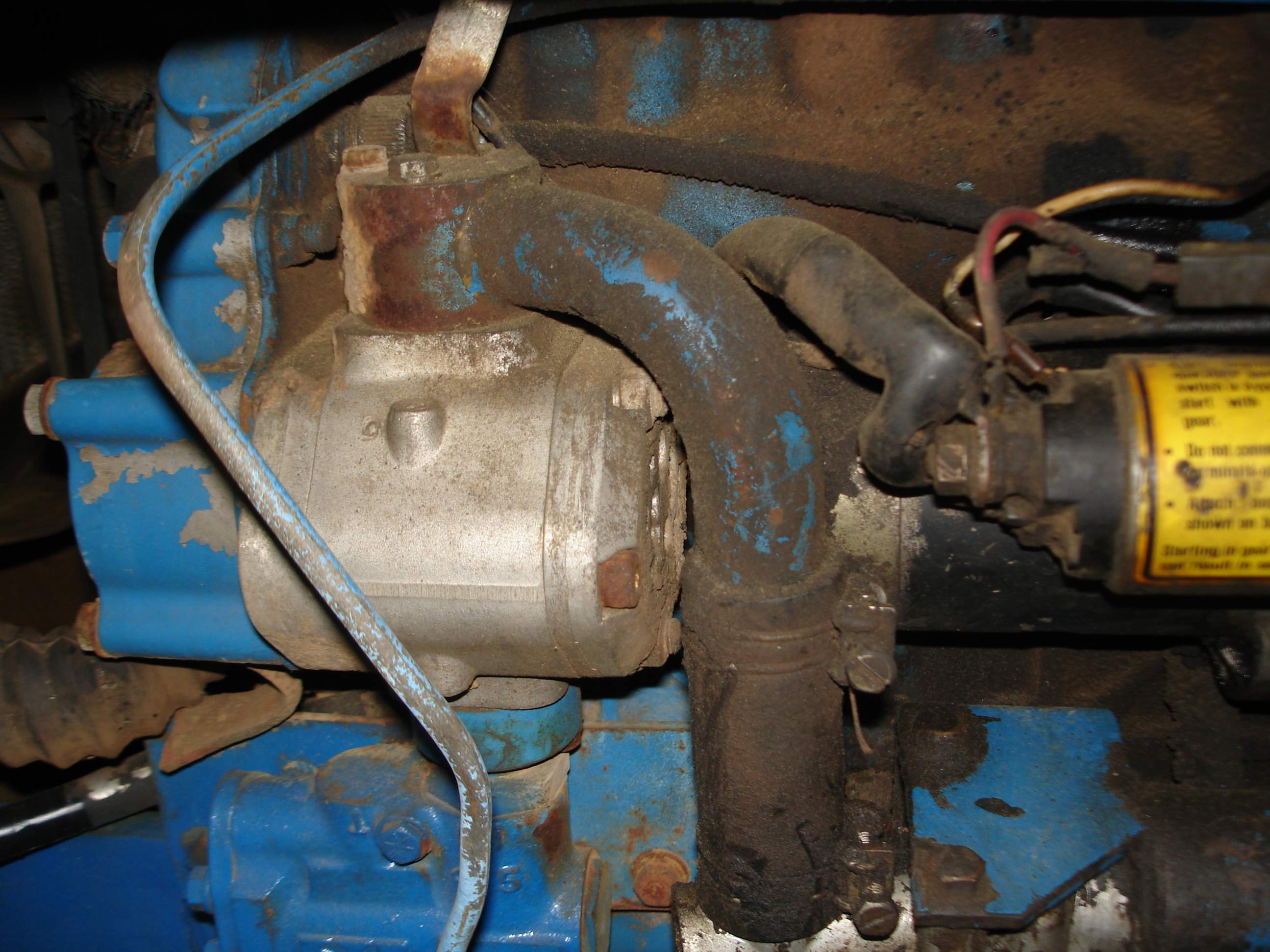

Trying to upload pics now. And how do I go about "set" the relief valve? Is there some sort of adjustment? Also, I'm going out now to try and get that valve off and apart to see what it looks like.

On your picture on the left, you see the cylinder head and the bolt on the left side of it looking from your picture's direction. You should put a pressure gauge there to see if you have any pressure and what it is. if you don't have the gauge then you can buy one from Northern under $20. It might be a bit messy buy if I did not have the gauge I'd open the bolt off and see if I can adapt a flex hose there pointing in to an empty bucket to see if I get any flow.

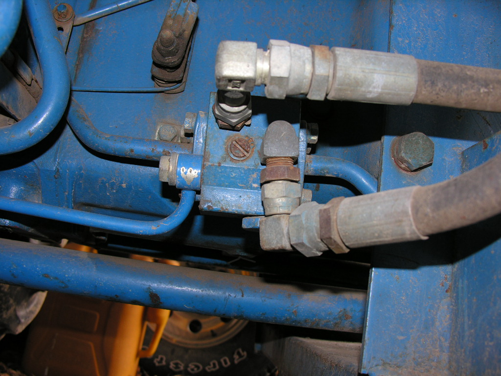

Coud you post some more pics of where the hoses for the loader tie into the hyd system.

..... And I do not see a diverter valve (assuming its an external device). .....
It's under and in front of the pedals on the right side.

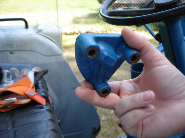

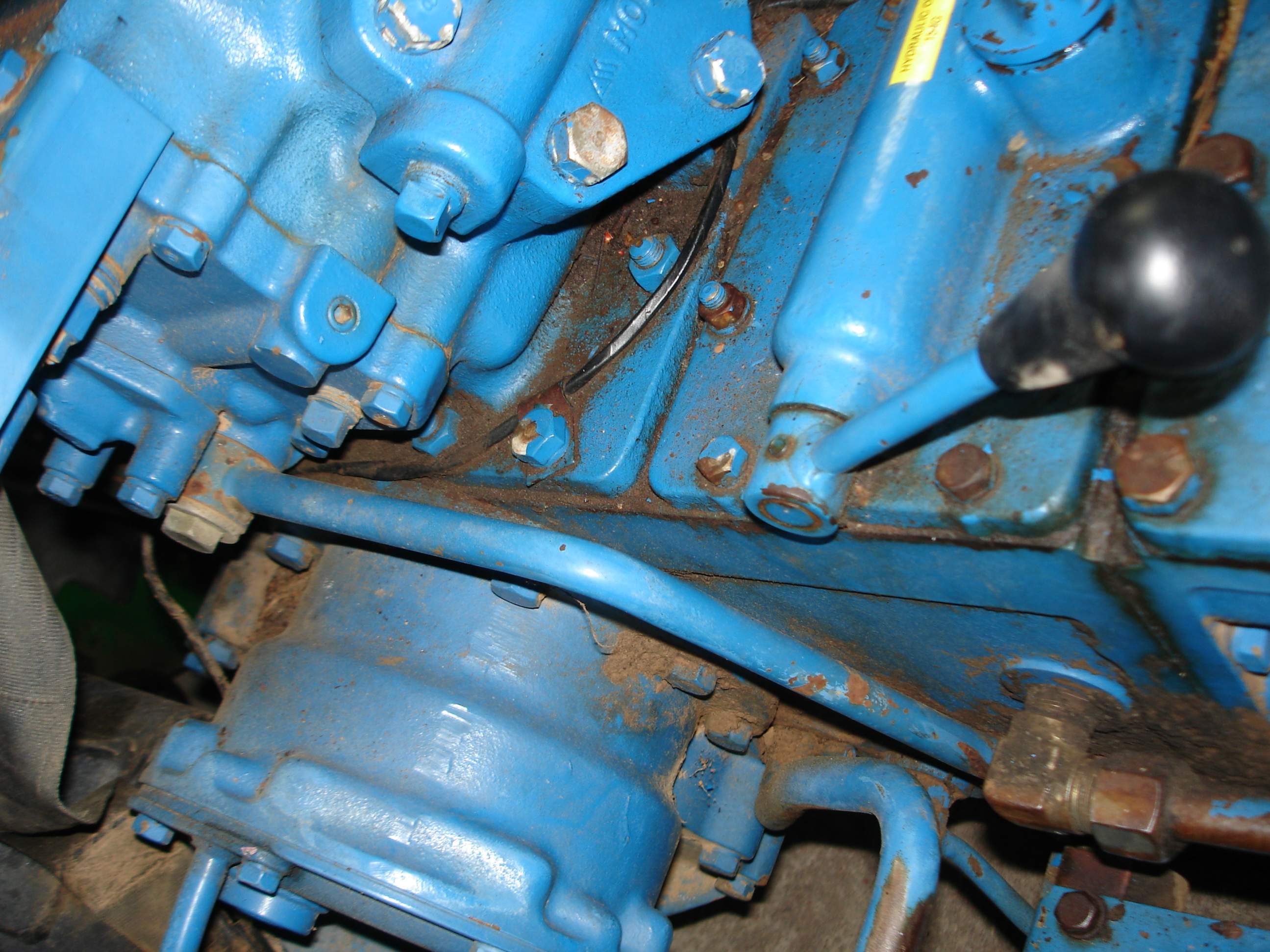

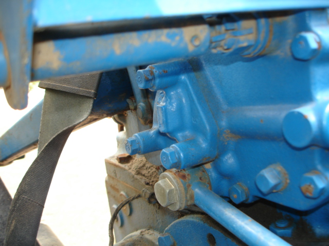

No, its not fixed, but we once again think we found "the" problem. Looks like some previous owner must have swapped the valve and cover. . .my cover has no valve in it! There is no pressure relief valve where the parts diagram shows. Ordering new assembly and keeping fingers crossed!

Hmmm, that looks different from NH diagrams. How doe is look on the other side of on picture #1 )left)? on the same pic I can see some sort of internal passage way that leads to this cover. Can you pan to the right and take a picture. Do you see a bolt there?. you might not have a valve like what I ave shown earlier, but a spring the oil passage way and required # of shims can achieve the same thing.
