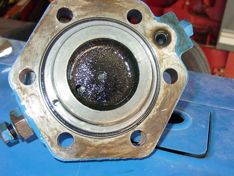

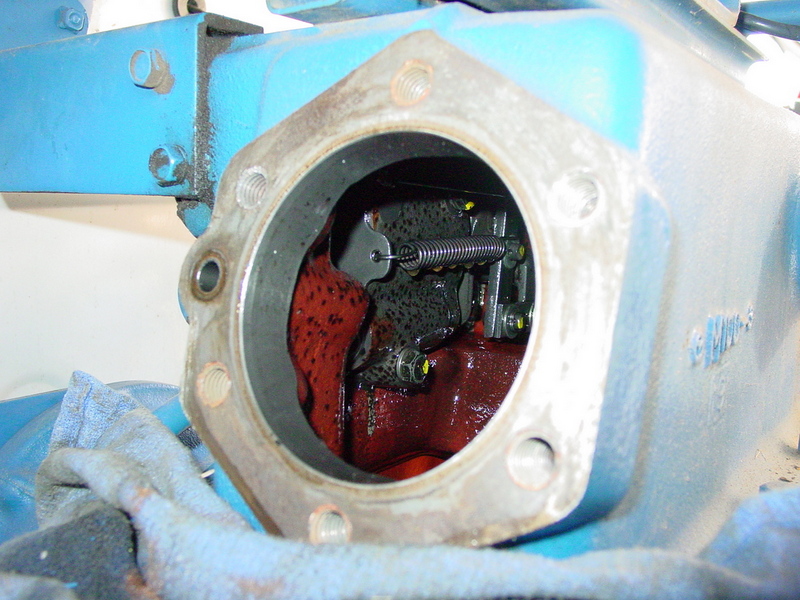

Good evening. I know this thread is old I’ve looked at a couple different post about this problem with Ford 1700 no 3 point hydraulics and I’m still stumped. But for whatever reason I’ve got a little different setup than most I’ve read about attached is a pic of my relief valve setup and block for front bucket hydraulics and power steering. Have all hydraulics but no hitch hydraulics with the lift piston head off I have flow inside the block but no pressure at the gauge port any help is much appreciated. Wondering if JC is still around to help thanks in advance
/ ford 1700 hydraulic problems #35
Paul,
I am still around. Yup, this a bit different. Looked at the pics closely. There are two seems like 1/4'' ?? lines behind the 4 wheel drive selector. Can you identify where they go and what function they serve? why don't you do the following test and report back. I will have two picture below here. There are the lift cylinder head. On the left side from operator seat you will see two set of check valves/detent balls. very carefully take them off. Make sure not to lose the balls or the spring. You will have a hard time to purchase them easily. Clean them and keep it in a magnetic tray so you would not lose them. Operate your rig with someone holding a bucket underneath and rag in front of the hole. Operate the 3-point lift arm and observe flow and rate of flow and report. Additionally, we had made much reference to lift piston seal, have you looked at them? do they look good and undamaged.

Good morning JC. The 2, 1/4” lines run behind the 4wd selector down the left side of the trans cover and under the dash area to a hydraulic box on the steering column I’m assuming power steering. What I’ve done so far is hydraulic oil and filter clean, new lift piston seal, took apart relief valve and cleaned, took apart check valve and cleaned as well everything looks good. Had the head off yesterday and have lots of oil raining down from just above the spool valve inside the diff. I started with hydraulic filter and oil change first as that was the easiest fastest fix filter was disgusting as like the one in a previous picture in one of your post cleaned it in the parts washer air dried over night Monday morning I filled with fresh oil just over 6gals like the book calls for started tractor 3ph worked as it should worked up and down multiple times with even a buddy standing on the arms. Stopped the tractor restarted that evening to till a garden spot of mine once again no hydraulics at 3ph so I go to the next start pulled the flow control valve checked piston seal and have the seal wasn’t even there and what was there was crumbling so I ordered one and replaced that Friday after work and still nothing. Have since then cleaned relief and check valves to no avail just drawing a blank on where to go from here. Attached will be a pic of the 1/4” lines and how they run thanks for the help.

Very busy this am and will be on travel next week. I will have to read carefully to get a mental picture of what's going on. Did you do what i suggested in previous post with pics? What I am trying to ascertain is if you actually have flow in to the lift cylinder head. With that plug removed oil should gush out. If it does not issue might be with spool. I will have some time to read your response tonight.

No worries JC and yes sir I have cleaned throughly I had the plug removed and no oil coming out of the plug hole. Would the flow control valve cause the 3ph to not raise or does that just adjust the speed the hitch let’s up and down? Thanks

Yup, that was what I wanted to know. I assume no oil was gushing out all the time you were raising and lowering the lift arm? is that correct? if so , I think you are diverting the flow in to diffy housing from spool valve or right at the relied device that sending the oil back to diffy rather than fighting relief valve spring to make pressure ( flow against a dead head or spring pressure is what causes pump pressure. Do you have an oil filled pressure gauge good to 3000 psi? look at the pic below. If you install one where i show in the picture you can verify system pressure there. If no pressure there then you will not have flow. In this case either spool valve or relief is diverting flow to the diffy. Which one? I don't know but by process of elimination hopefully we can find it out.

Yes correct no oil comes out of either one of those plugs I’ve removed to check for flow and no oil comes from either one. I’ll try a gauge on the pressure port but I’ve had that plug removed as well and no oil comes out. It should come out with the gauge plug removed correct?
