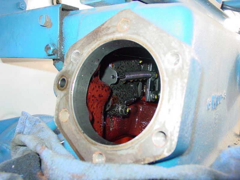

ok so i have taken out the cylinder head bolts and the cylinder head is loose from the lift arm housing. coming straight out the head wont go past the 4 wheel shifter box. it will almost go past but not quite. the cylinder is attached to the head causing no clearance for up and down or side to side movement. at least i think it is the cylinder. i am going to go out and move the arms up and see what happens, but i thought that would just move the piston and not the cylinder. my book says to take the head off and the cylinder , piston, seals and and stuff is readily available. i dont think the cylinder is suppose to be stuck to the head. also going to try and get the 4 wheel drive shifter plate to break loose from the transmission housing so i can move it just enough to get clearance enough to pull the head straight forward and remove it to see what is going on. i have read a lot of your posts and know you are very familiar with the hydraulics . i hope i have made it clear enough.
/ ford 1700 hydraulic problems #4

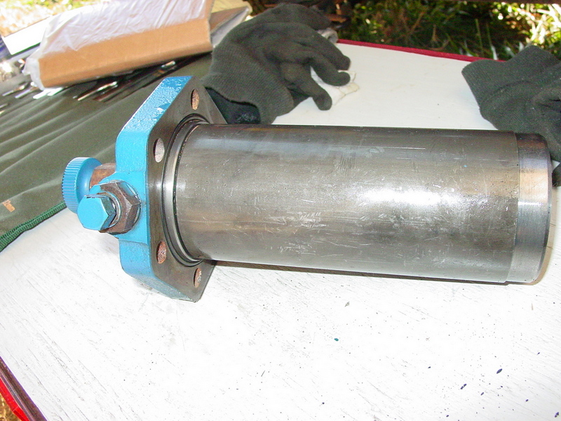

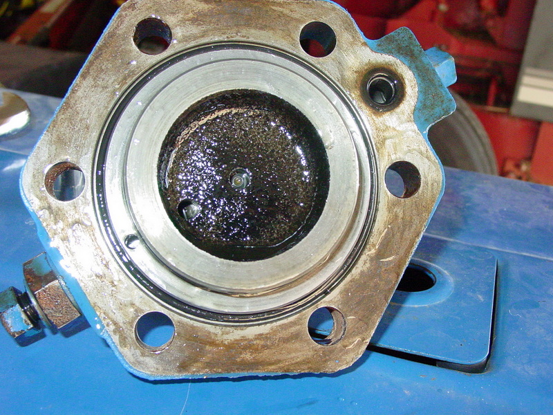

cylinder head ist not fixed to the cylinder . There is a rubber o-ring that connect the head to the cyllinder. Get a rubber mallet or dead-blow hammer with rubber head and wack it good with purpose on the side of the cylinder and head and the head will come off. Then you have plenty of room. I was able to get my shifter move up and had no interference with head/cylinder combo.
Look t attached pics for clarification,

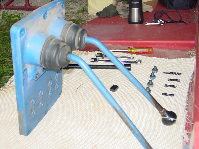

You can also remove the shifter cover. It is not needed or necessary to free up the cylinder head at all.

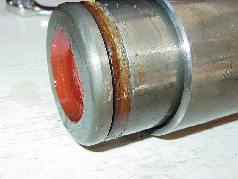

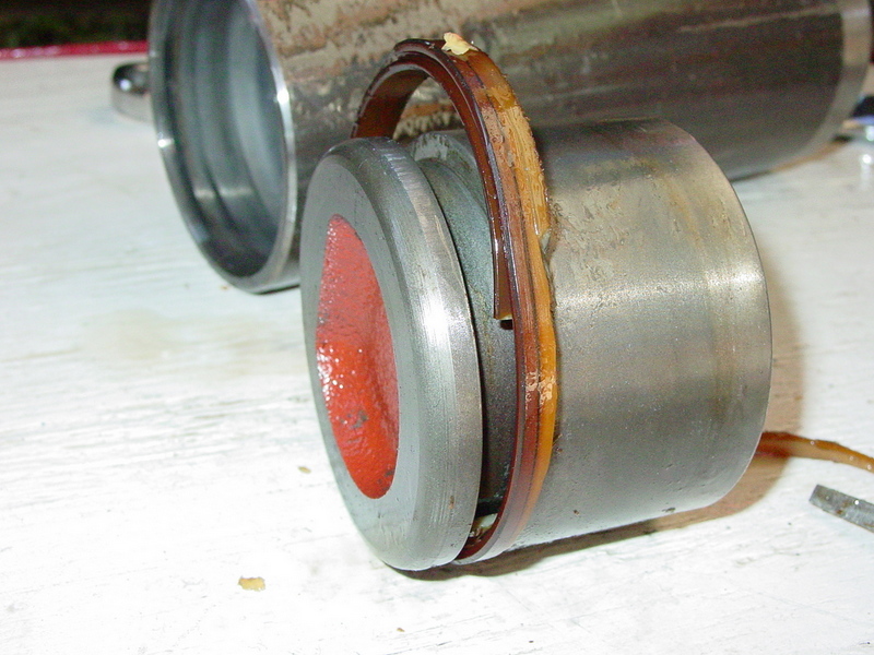

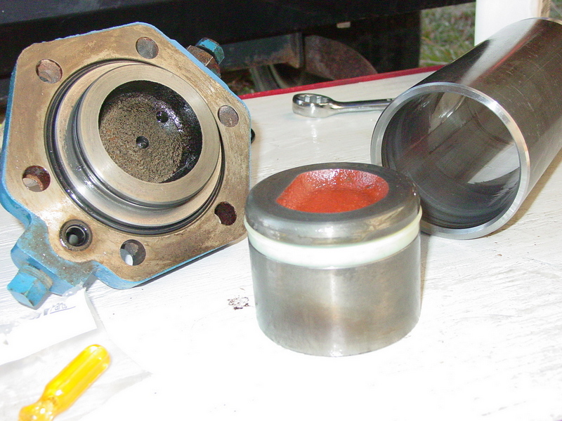

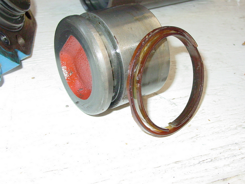

i have gotten the 4 wheel shifter off and the cylinder head and cylinder came right out . the piston dropped down , but was able to get it out. the piston seal has disintegrated into small pieces. the cylinder was cocked enough that it was stuck to the head, but got it off. now i am waiting for parts to come in. that would be 2 o rings and the piston seal. will clean up parts and be ready when they get here. this is on my 1700, but ordered 2 sets so i can do my 1900 also. any assembly instructions would be very helpful. thanks a lot for the first reply.
/ ford 1700 hydraulic problems #7
most likely you can salvage the o-ring. I did mine 10 years ago, bought the o-ring and just kept it for spare. Wished I have gotten extra piston seal for spare since it was just $8. it is pretty easy how it goes together. The installation of the seal is a one time deal and if you put it in reverse once t seats in the piston groove and it is a done deal. It is a double lipped nylon seal. The lips should face the piston head and not the other way. it will be a tight fit. I have heard people put the seal in hit water to soften it up. I personally did not like that idea. I just got a plastic bag, oiled up the seal and left it on my car hood for 45 minutes under the sign and that soften it enough to install. look at the pics below.

Before you mess with the spool valve check the following. Look at the pic below.
The hole on the right side with the o-ring is your supply to lift piston. The hole in the middle is the rate of return drop, next to to it o the lift is the supply to top of piston. The very last one on the left opens up in diffy and that is the over pressure release to keep the seal from being damaged. Now you see the head is symmetrical and has two identical ports . If by mistake you installed the head 180 out then the hole does not match the casting on lift cover hence no pressure and flow to the 3 point.
Now look at the pic below. That hole should line up with the hole you see on the right of lift cover as you seat on operator seat. That is where oil from the lift cover casting goes to lift piston head.
