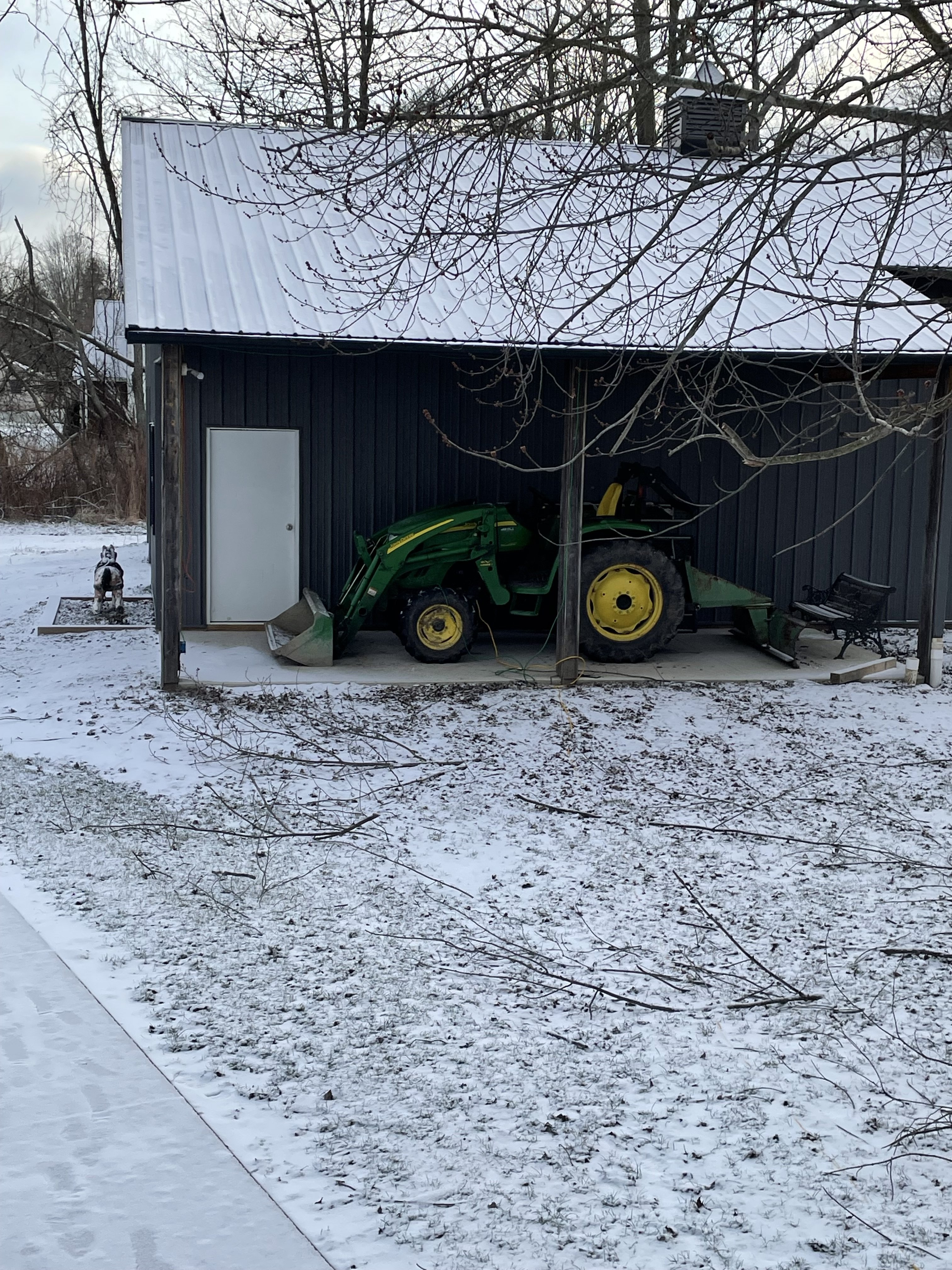

I have been using a 4 amp smart maintainer on my 3500 RAM, and both batteries test at 100% health and charge at 5 yrs old! If they give me 2 more, I'll be happy.
When I get prepared for snow, the tractor is checked over, the battery tender hooked up, and the block heater on the WIFI timer. Then when I go to start it, fires right up. Only need about 2 hours on the block heater.
Once you get some heat in that block, it doesn't sound so mad when starting!
