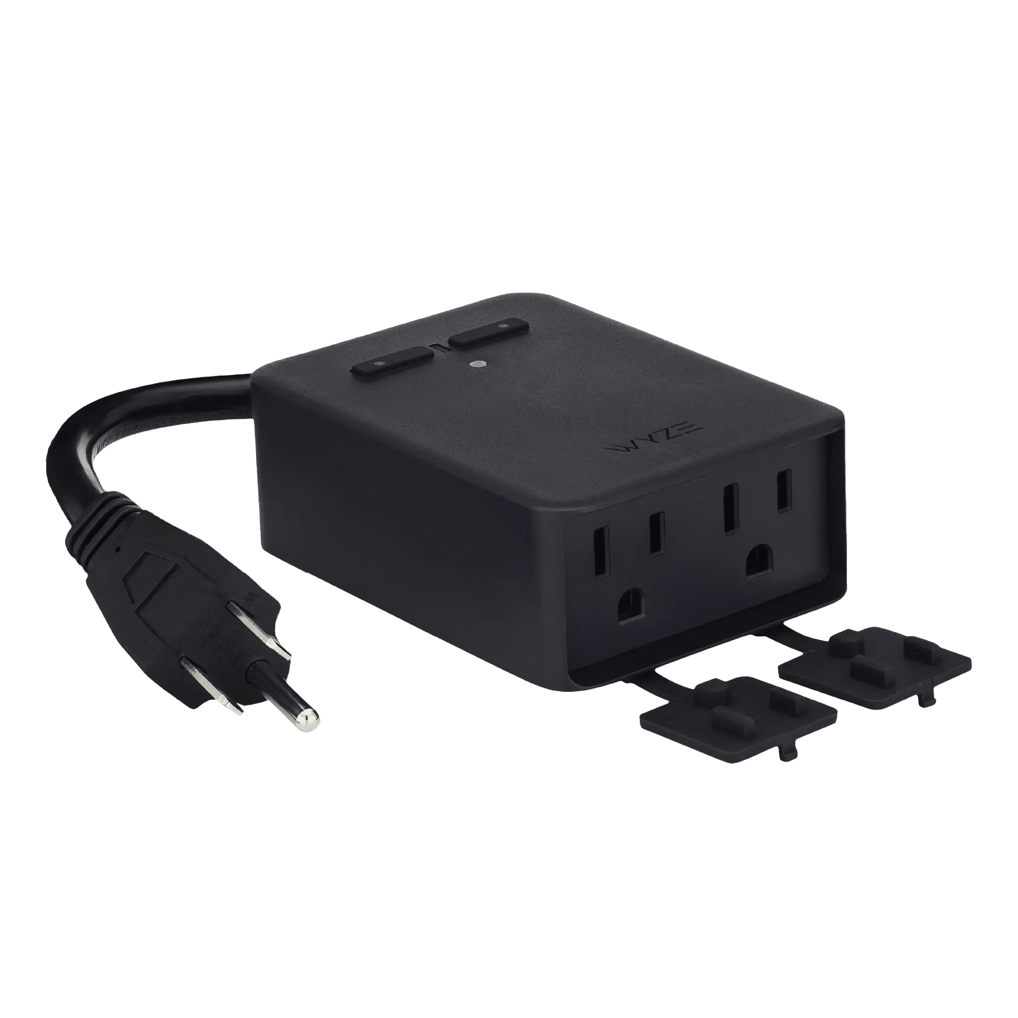

I use this Wyze Outdoor Wifi managed outlet for my block heater, I can program it for when it turns on automatically and off for set time.
Thanks for the link. Like the fact that it has 2 plugs. Can it be set to on go on at certain temps like Topzide can do?
WiFi timers are the way to go for block heaters. I have one that I use for my RAM, and can set it to come on at certain temp and time. If it's not that cold during that time frame, it won't come on. Really helpful when I'm the DW's tow truck! She leaves at o'dark thirty, and I have the block heater to start when it's needed to get on the road quick!
The turning on based on temp seems like a good idea. What brand is it that you are using?
/ For those with block heaters #30
It more of what the app can do, not the plug. I just have a 2 channel outdoor wifi plug. Means it has 2 independently operated plugs. The app has scenes that allow me to set what temp to come on at. I use 1 channel for block heater on my RAM and the other for a battery maintainer. If I know I'll need the tractor, get it plug in the same way with another setup.
I'm using the Smart Life app on Android. Hope that helps.
Not that I have found, I can turn on each individual based upon time however. So if you know it's gonna be a cold one, set it X amount of hour before you get up and turn it off at said time you start plowing etc. I've used mine for years.
