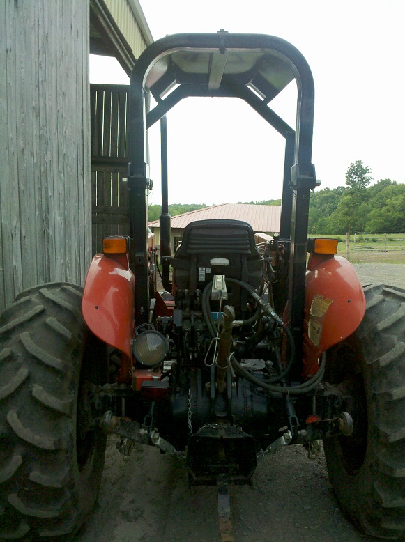

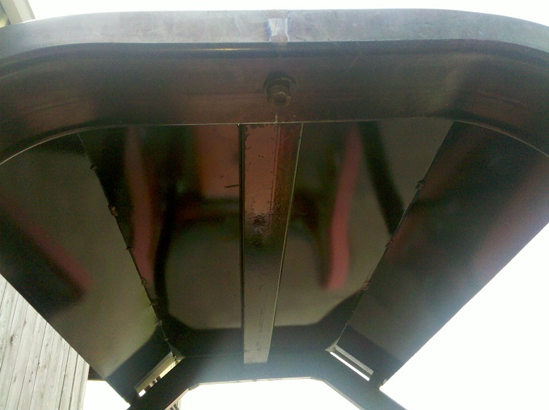

/ (FOPS)FALLING OBJECT PROTECTIVE STRUCTURES #52
I've had my FOPS installed now for quite some time since my last post. My expense was about $500. The cost to manufacturers would obviously be less with production savings. It can be removed with the FEL after removing one bolt.
My point is that this inexpensive protection would be effective against the final common pathway of accidents from objects falling from virtually any FEL attachment and includs improperly attached quick detatch implements falling from the lift arms.
I cannot conceive of an argument against this simple option and its installation upon the purchase of FELs. I bleive its installation should receive the same attention as regards the present requirments regarding ROPS/seatbelts on tractors. Is there actually an argument against this out there? If so, does it apply to ROPS too?
