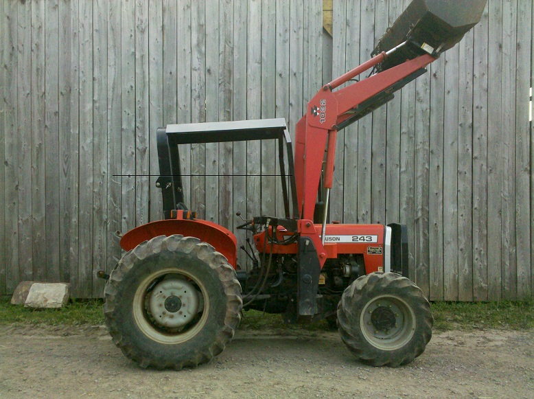

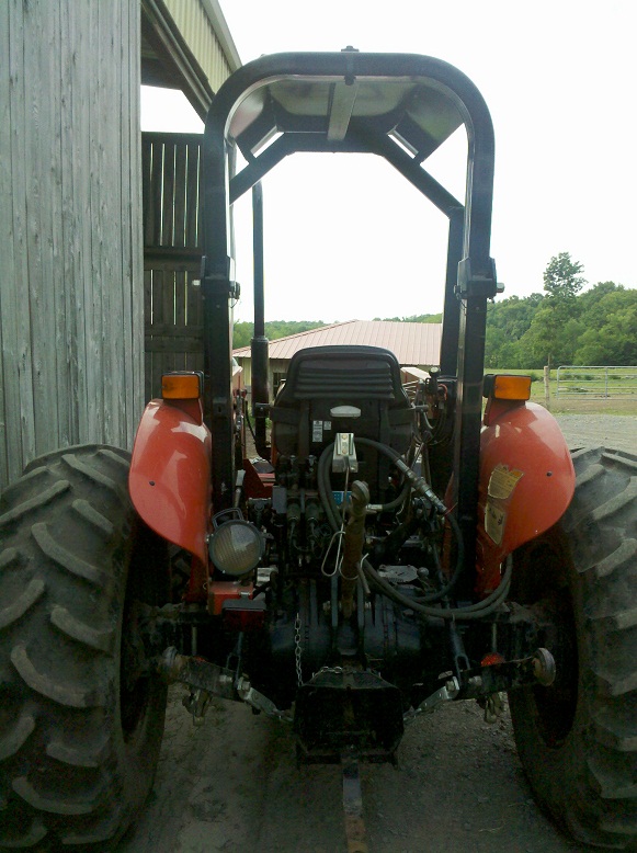

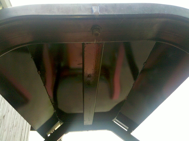

I've had my FOPS installed now for quite some time since my last post. My expense was about $500. The cost to manufacturers would obviously be less with production savings. It can be removed with the FEL after removing one bolt.
My point is that this inexpensive protection would be effective against the final common pathway of accidents from objects falling from virtually any FEL attachment and includs improperly attached quick detatch implements falling from the lift arms.
I cannot conceive of an argument against this simple option and its installation upon the purchase of FELs. I bleive its installation should receive the same attention as regards the present requirments regarding ROPS/seatbelts on tractors. Is there actually an argument against this out there? If so, does it apply to ROPS too?
I haven't been following this thread closely but I don't believe you can legally call your canopy design a FOPS unless it is certified as such. That means at has to meet federal safety regs for the class of vehicles it's installed on. That generally means that you have to demostrate that it will take so many ft-lbs of energy from a falling object installed on the tractor without failing. Welding big chunks of steel to an existing certified ROPS doesn't make it a FOPS and it could invalidate the ROPS certification. Most people don't have the expertise and the money to design and certify these types of devices. That's why it's left to the manuafacturers of these vehicles. Google FOPS Regulations if you want to see what they are.
The other issue is using the equipment in a way that it was not designed to be used. Most FEL's I am fmiliar with come with warnings to not use the bucket to lift objects that can roll back on the operator( logs and large round bales etc.). Round bales should be hndled with spears or grapples and logs with forks or grapples. Why should a manufacturer issue those instructions and then provide a device to protect the operator if they violate the operating instructions? I'm talking Ag equipment now. Construction equipment has an entirely different operating scenario and different design philosophy. Whether that design philosophy should be adopted in the design of Ag equipment is another argument.
Then there's Murphy's Law. There will always be somebody that will find a way to hurt themselves with the very same safety technology that is supposed to protect them. I call this "Darwinism in Action".

I would also be interested in seeing more pictures of the front, the connections and how it all mounts. It looks to me like something heavy coming down and hitting just one post on the front could twist/crumple the whole thing and put you in a worse situation than before.
See: http://www.tractorbynet.com/forums/customization/172660-cage-kioti-lb1914-3.html for a well thought out design
