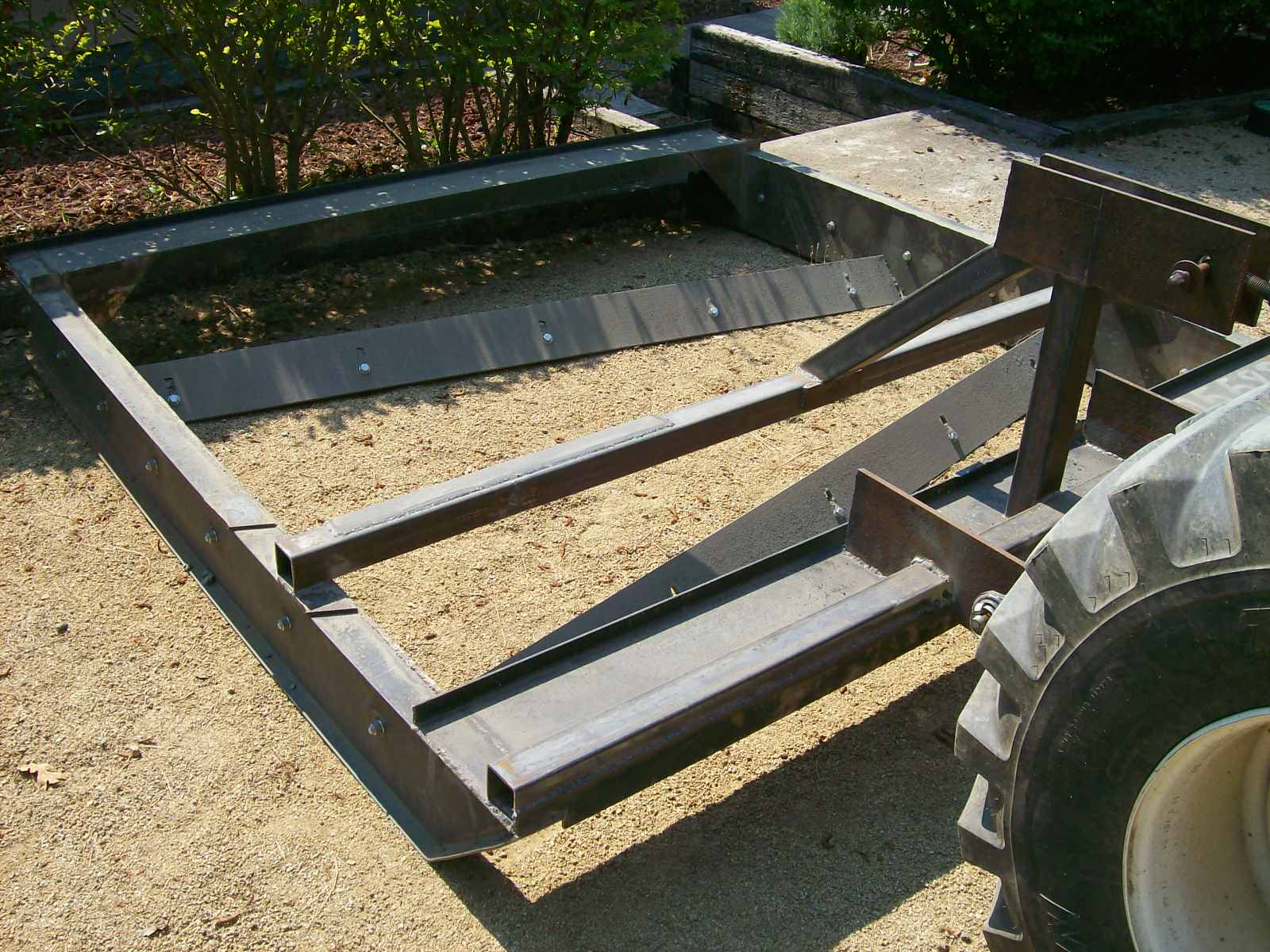

Ditto what Ovrszd said . Bending the gun lead to much , to tight a bend will easily cause jams at the drive wheels using flux core . I have done it with my 220/240 Longevity with knurled roller running .035 . I get lazy and instead of moving welding cart to a better angle , I have tried bring the gun in at the angle I want , BUT it puts a tight radius into the feed and POOF , No feed and birds nest in at drive roll . I have even went to a larger liner but that seemed to make it worse .
I use to have a Lincoln 135 , ( a 100/120 unit ) , ran .035 flux core and built several 3 point attachments . Have never broke a weld . Bent the Crap out of things , but no welds broke .

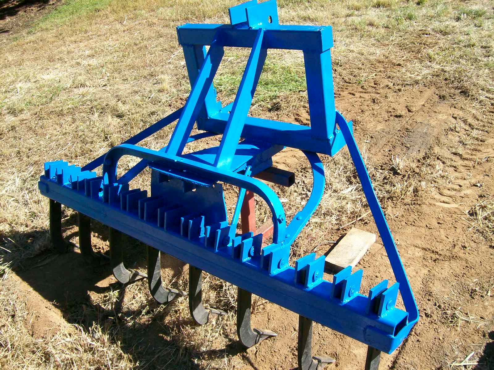

First photo is a homemade 3 point hitch that has a .250 thickness tube with 8 16" ripper shanks attached . My TC-30 will pull it buried in the ground downhill and sidehill on Our property but struggles up hill since it is 10 to 14% grade . Never broke a weld any place , but have hooked some big oak roots that have stopped the tractor in it's tracks .
The 7' + land plane is for driveway maintenance . Hitch is all .250 or bigger . Rails are .250 I beam with .250 sheet attached on inside . Welding the sheet on the first rail was stitched to keep heat down . On second rail , I ran straight through . Warped the I beam about 3/8" front to back . The 135 was not turned up all the way , something like 8 on a 10 scale . Never over heated , Never tripped the machine . I ran it on a 30 amp breaker and a 50' 12 gauge cord .
