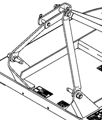

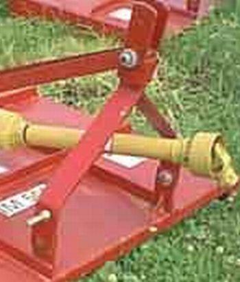

There are more, but I'll upload shots of the U-type Henro's got, followed by the 3-sided type I've got. Both as you will see, provide the missing pivot point required for terrain following, while retaining the rigidity required for lifting on the horizontal plane.
//greg//

/ Floating Top Link? #14
and the 3-sided type
//greg//

</font><font color="blue" class="small">( Float Mechanism details. Without IMatch. )</font>
Doesn't look like it permits much play (float) at all Jack, but then again - we're only talking 4 foot cutter here, I usually think in larger terms.
But it pretty much reinforces the idea that the toplink on Ralph's 4010 must be too long - which effectively cancels what little freedom of movement is shown in your JX(x) illustrations, AND, that his chain idea is not compatible with JD design
//greg//
