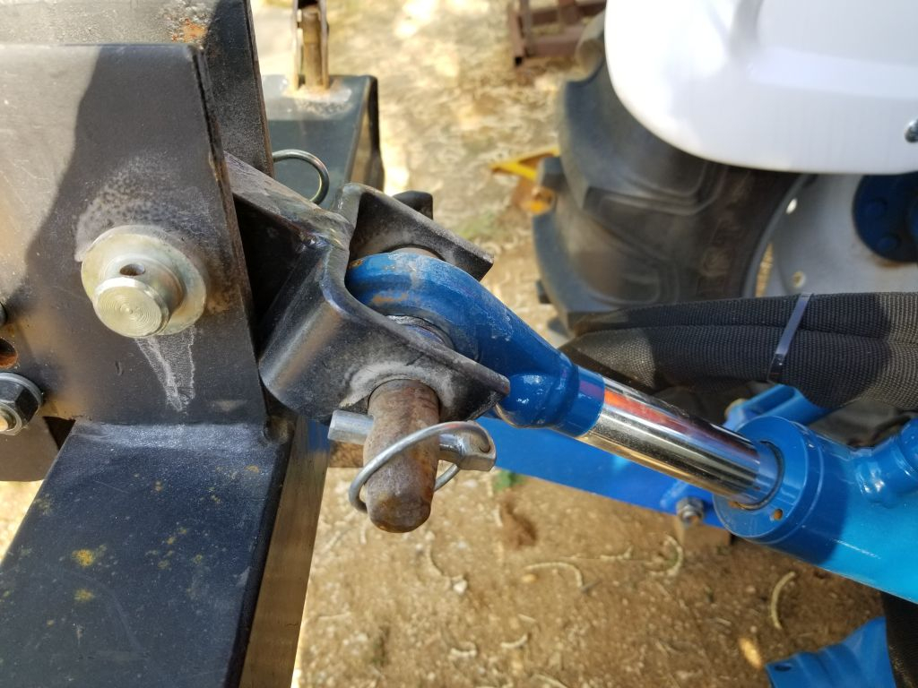

I have a quick hitch and a stirrup as well as top and tilt cylinders. I put the stirrup on the top cylinder side (right behind the QH) so the "float" is available for all my implements. I'm putting pedal shaft seals on my Ford 3910 and will try to remember to snap a picture of the setup. Works great!

I'm thinking that the "stirrup" is some kind of floating link? Did you mean (right AHEAD of the QH?)
I guess it depends on which end you're standing on. :rolleyes:
Forgot to mention--The 3PH is all the way up in this photo.
Here it is:

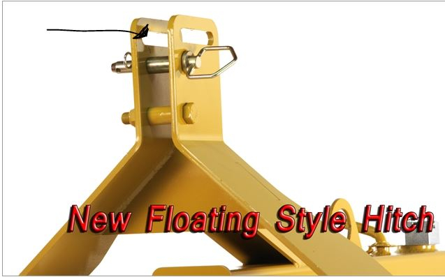

The EA landscape rake I have has the usual connection point for quick hitch l top link and an extended "slot" where you can connect the top link to allow for some floating. I'm still learning how to use it best, but combined with gauge wheels, it does a good job. I am never eager to remove the quick hitch to mount it this way, but I will if the job is large enough.
