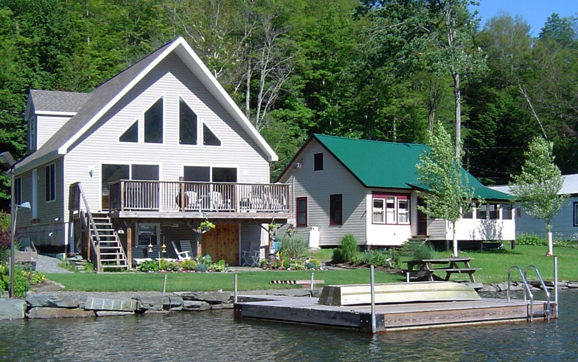

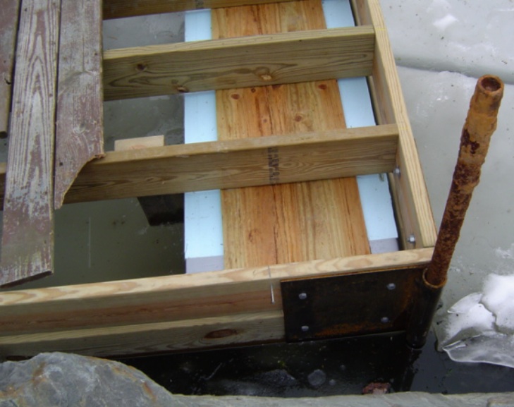

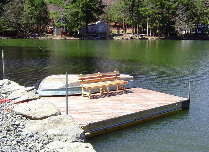

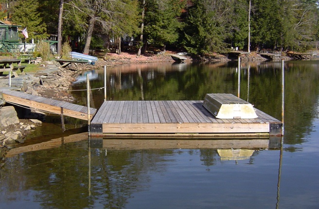

We have a vacation house on a lake and I spent months researching the best floating dock to build. All of the barrel docks were very high off of the water and very tippy. White foam floats covered with plastic were OK but the foam would absorb water( open cell ) if the plastic wrap was ripped.
The blue or pink DOW foam is the answer ( closed cell won't absorb water ).
Here are some pics of our dock and one I built for our neighbors.
It is 6 years old and never been taken out of the water. The one shot shows the foam before the 5/4 decking was put on.
The dock is 16 foot square and incredibly stable. Deck is only 10 inches above the water.
They sell dock float billets ( expensive).
I made mine from foam bought at Lowes cut to 2'x8' and glued together with Great Stuff foam ( much cheaper and size adjustable.
