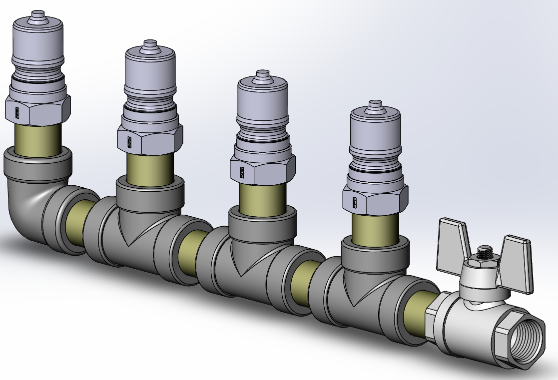

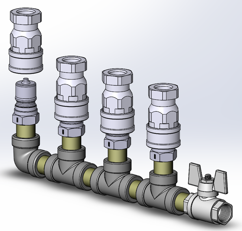

For the sake of the discussion, this is what I had in mind.
I am certainly not locked into this design, but it'd work. Maybe there is a less fitting intensive design. I've seen those air manifolds (http://ecx.images-amazon.com/images/I/51avnKHPgDL._SX342_.jpg) but it's a 3-up with a spot for a valve, not a 4-up. Plus I dunno about room for the other fitting half.
This is 3/8 fittings and nipples, probably just from Home Depot. 1" nipples appear to be plenty large and give room for the mating fittings.

aeblank, How did you make out with your Manifold idea? I've used the heck out of my Small manifold idea ( THREAD #9) and I'm happy with it. I can't imagine having to buy the Mates to that Italian connector for each implement. Although it is cool looking.
Dunno yet. Haven't used it. I finally built it though!
It wasn't too bad, cost wise. Maybe $40 or $50.
That's only a couple years to pay off, in frustration/hr. on re-assembly.

I've been fighting with these pressure bound fittings for years now. I tried the connect under pressure Flat face and Pioneer types with little improvement. I finally switched to the Pioneer 2 way style QD's which so far are working well. I used Female breakaways on my tractors which can be pulled apart even when not completely depressurized. The male fittings on the implement hose ends can be depressurized by rapping the ball valve end on the side of the implement frame. For my frequently used implements, I made up a few of these:
Although more expensive, the same idea can be used for flat faced QD's as well.

I made something very similar but used a 4-way cross tee instead of a Tee and just left it open on the sides. I stuff a paper towel in there. Sounds like you have the exact same issues I have and tried all the same things...
/ Flat face hyd. coupling "pressure release" tool #58
I did that at first but found I was losing more oil. I still do this with frequently used implements though. For long term storage, Letting the hoses "breathe" allows air and moisture to enter which is never a good thing.
/ Flat face hyd. coupling "pressure release" tool #59
Oh - I don't leave mine in place. I just use it to release pressure on the tractor or implement side when i am trying to connect. I plug it in then pop it back off. The most that comes out is a tiny squirt.
