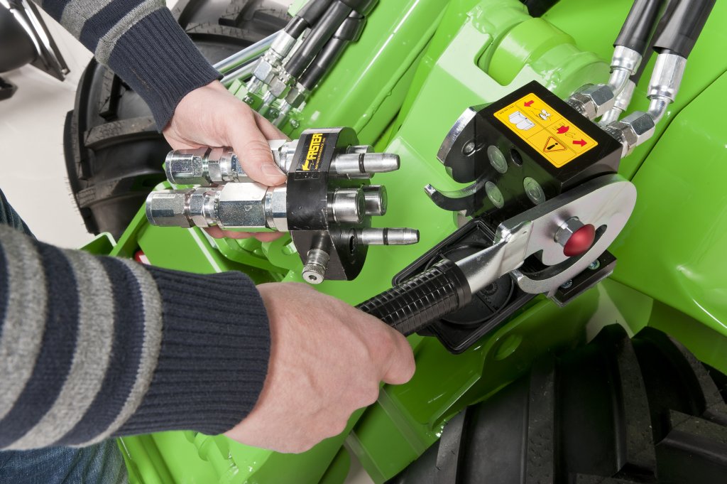

Flat face hyd. coupling "pressure release" tool

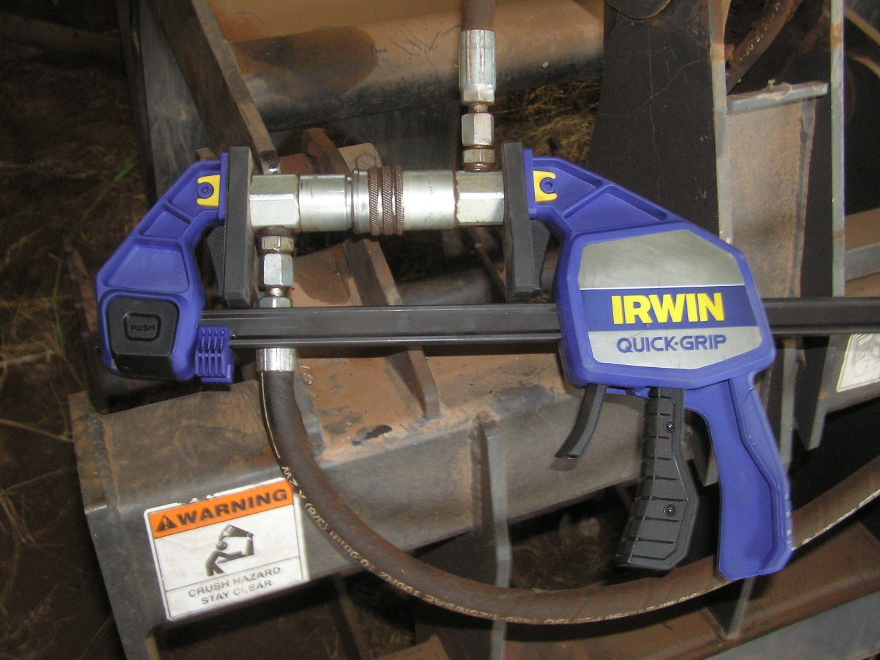

The Monster Grapple has right angle flat face connectors that are difficult to push together after I remove the grapple for storage.
So I bought a heavy duty Quick-Grip to leave in the V417:
Lined up straight:
Squeezed together:
Easier and cleaner than a brass punch and a hammer.
