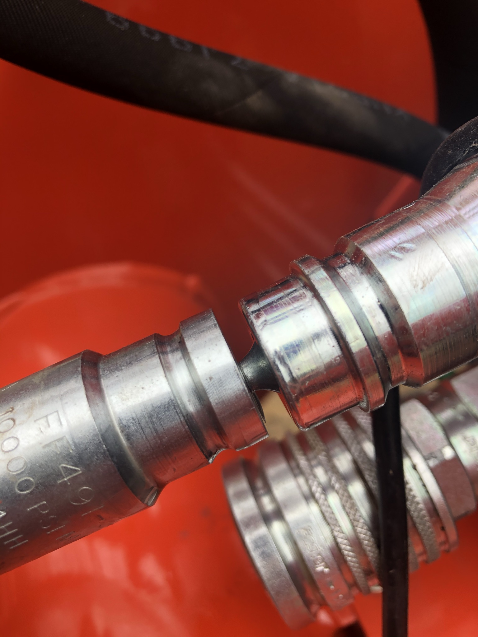

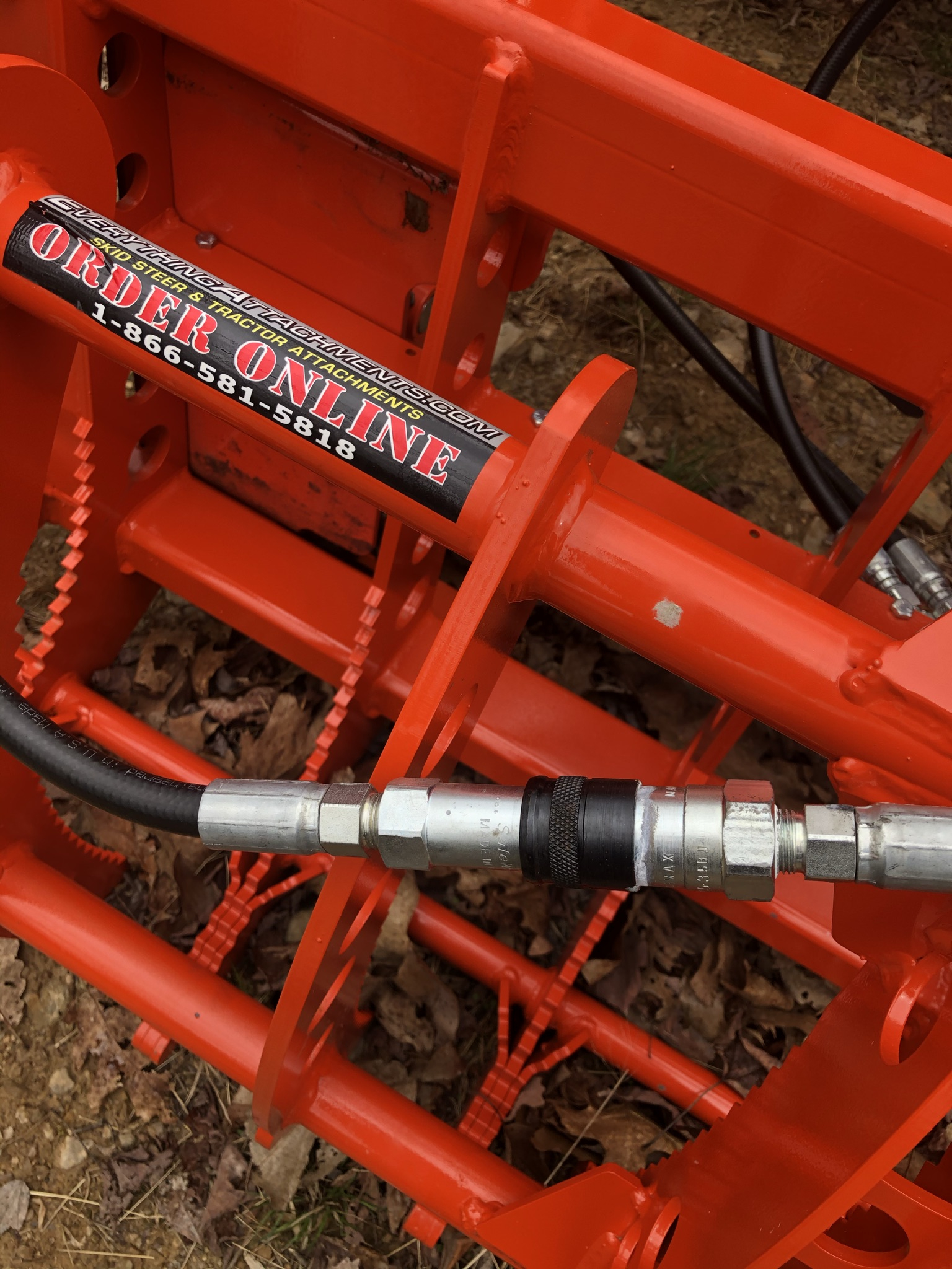

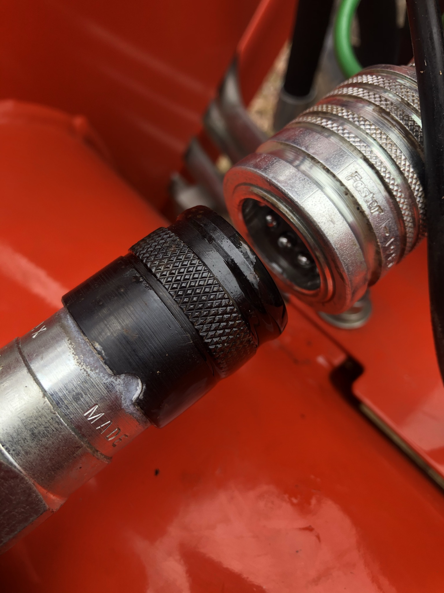

Last year I got a Kubota MX6000 and a grapple from Everything Attachments. Kubota said the remote kit used 3/8” connectors so EA installed 3/8”. I didn’t get a chance to install the grapple until recently however cannot get the flat face connectors connected. I first released pressure from hydraulics but still cannot get the connectors to connect no matter how hard I push the male into female. Looking at the male connectors it seems they are different and that may explain it. On the tractor, the male has a raised ring where the EA hose has a groove. The EA female connector is smaller in size than the tractor connector. Do I just replace the EA ends?

Your EA grapple has flat face connectors, the tractor has Ag style connectors, they are not interchangeable.
You need to switch either the tractor or grapple over to a matching style. I would switch the tractor personally as I prefer flat face, especially if you plan on connecting them regularly.

Right after I posted started looking at this again, it looks like the dealer didn’t install flat face connectors after all. 🤬 So do I just switch grapple end to ag style? Strike 2 for my dealer.
