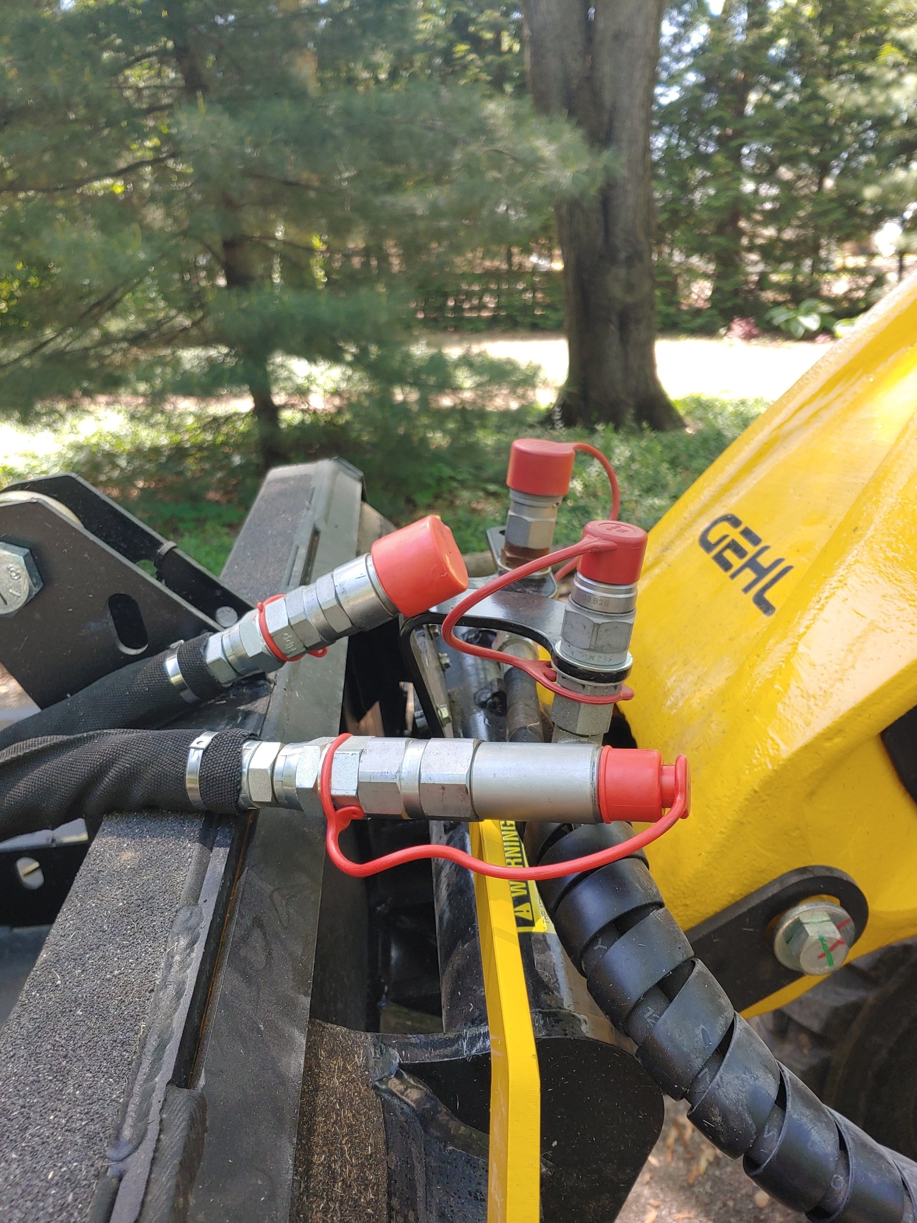

The hoses on my brush cutter would like to connect to the machine at a 90 degree angle to the way the 1/2" flat face connectors are currently mounted:
Do they make an elbow that has a flat face quick connect on each side that I could connect to the machine and then to the brush cutter hose? I see all kinds of elbows that have one side NPT and the other flat face, but I don't see any with a flat face on both ends of the elbow. Or should I just bite the bullet and change the fitting on the machine. There are attachments that are happier with the vertically oriented fittings, but I don't have any of them. Both of my attachments would be happier connecting horizontally.
/ Adapter for flat face hydraulic connector #2
Build your own adapters.
/ Adapter for flat face hydraulic connector #3

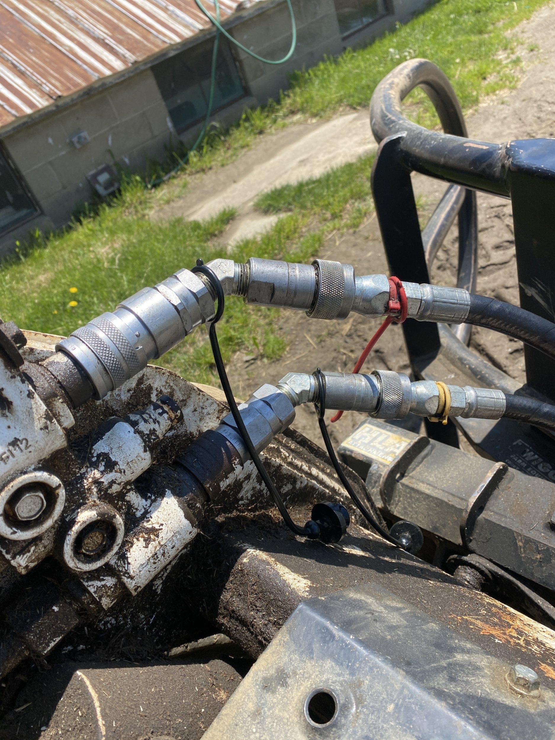

Get the angle you want then get the couplers you need. Probably cheaper than buying already made ones if they exist. I made the ones I have
Thanks, that helps to see a picture of what you did.
