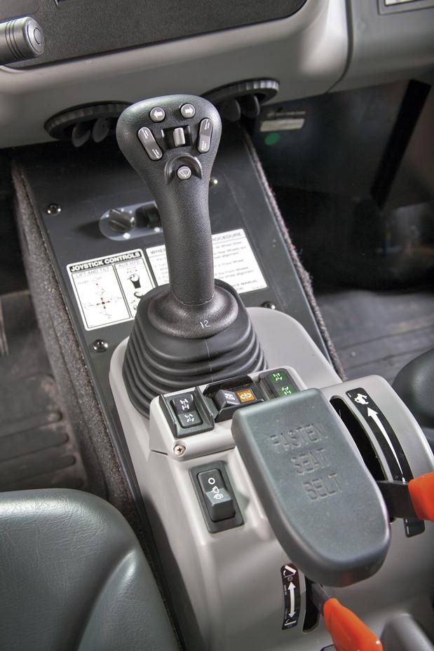

What happens if you push and hold the toggle to the left then push the trigger?
This is what my joystick looks like:
