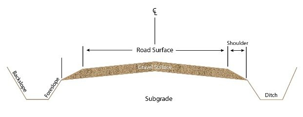

Sounds like you need to crown in the spring/summer and do the ditches. At this point in the year all you might be able to do is fill with coarse gravel to let the water run through it ... until it freezes if you are high enough up.
Hmm; crowning is the method of having the center at the highest point and sloped down towards the ditches so water does not pool and sit. It is used in areas that get a lot of rain and seasonal water movement, in case anyone wants to know.

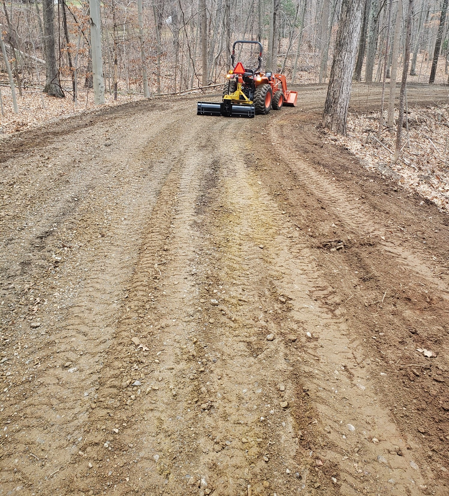

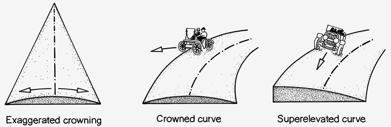

My driveway is about 500' long and has a serious elevation drop in part of it. I used the superelevated curve shown by the previous poster. It worked out great. Here we use what is called 3/4 process with dust. We had a really abnormal year of heavy rains and the driveway stayed intact with no erosion.

I also use the superelevated curve as shown on my two turns.

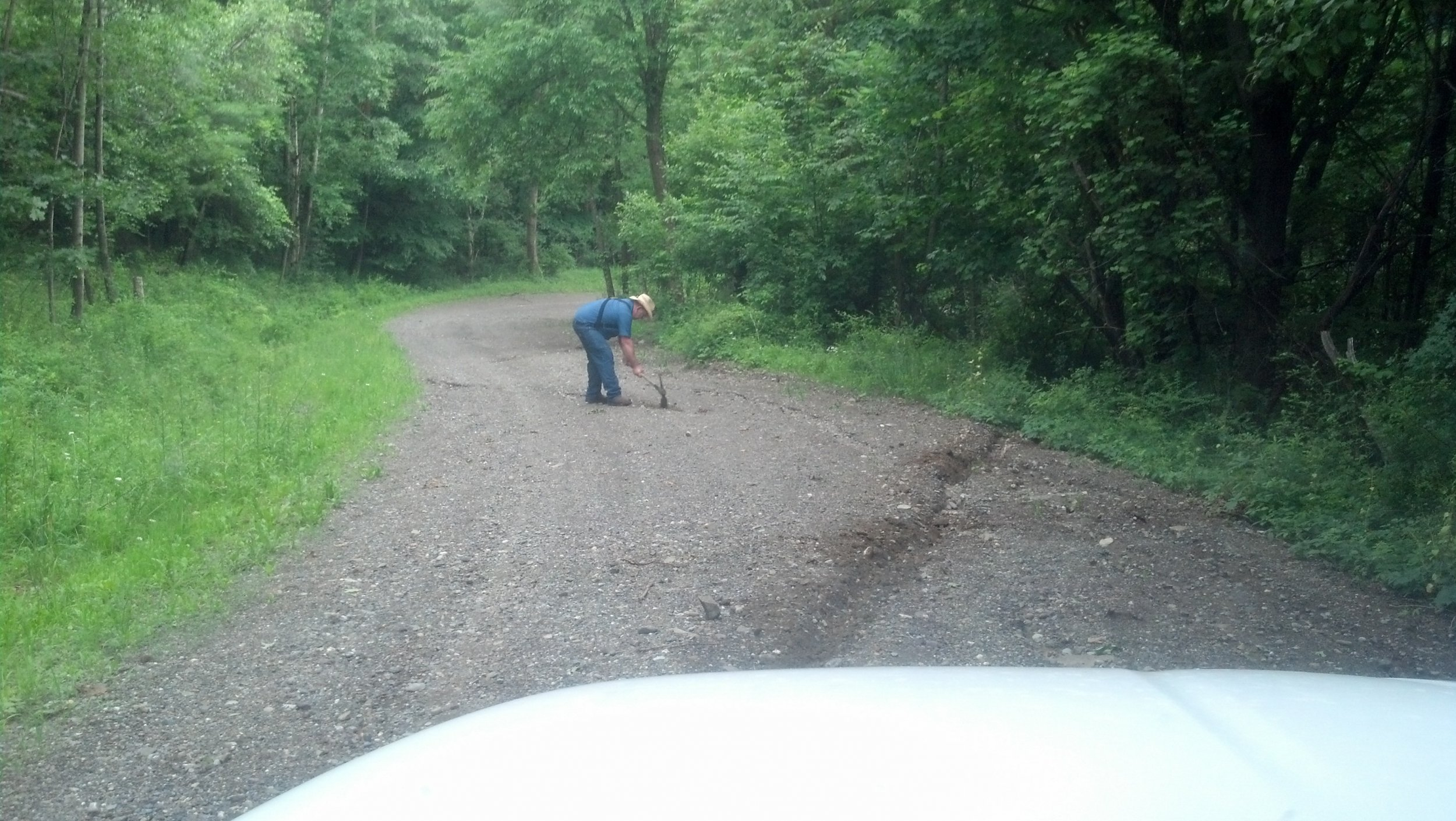

I place "water cuts" in my driveway.
Narrow trenches dug at an angle across the driveway to catch and funnel the water off to the ditch
or over the bank, they work and keep the driveway intact with much less gravel lose
then crowning could ever achieve.
Crowning a drive will work good on flat drives or minor slopes not on steep slopes.

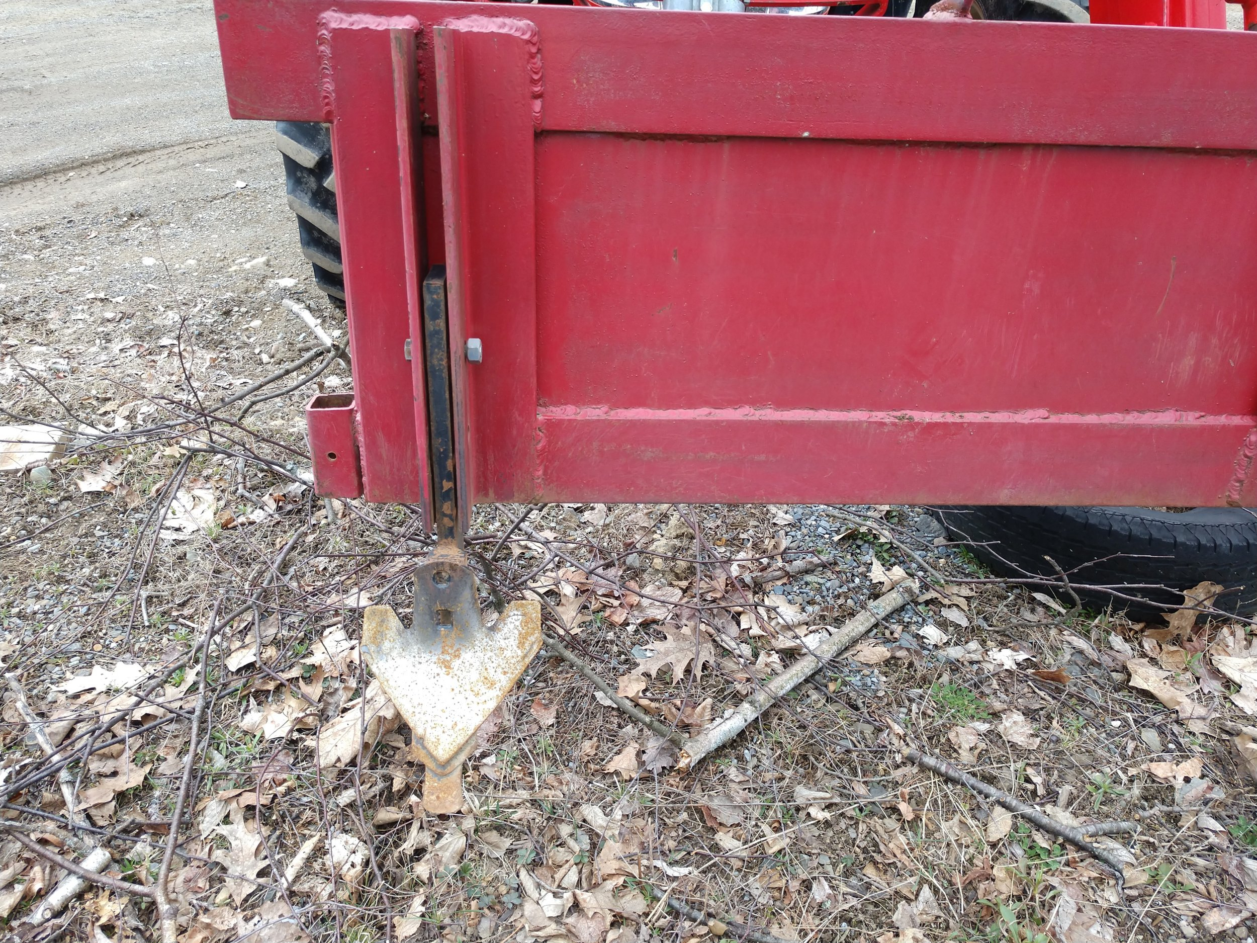

I can put a 3" wide by 3" deep trench across the driveway at a downhill angle with the tractor in nuetral
and riding the brakes to keep it slowed down.
The hard way to do them or even to just clean out existing cuts.

My gentle driveway crown and relatively shallow ditches had done a great job of shedding water for several years. But then we got over 6 inches of rain in a single day (most coming in a gnarly 3 hours of deluge). The crown couldn't shed it all (especially on my steepest hill) and the ditches didn't have nearly enough capacity. Most of my top, smaller gravel got washed right off the road, serious bummer when I woke up the next day.
Repaired and no problems since; didn't buy any more gravel. Looks pretty nice again now.

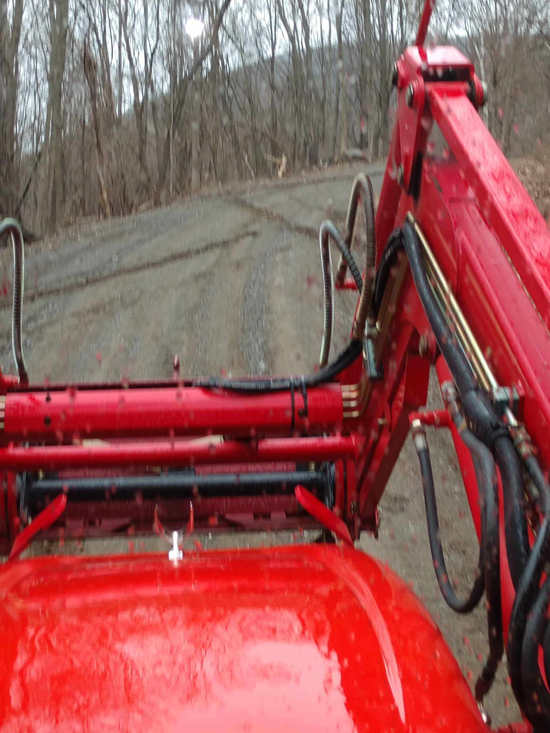

I just moved to a place that has about 2 miles of common and private roads/driveway, Some of it has no top coat, just poor quality crusher run gravel that seems to get worse rather than better when working it. The common driveway which has a proper top coat of 3/4 to dust is shared primarily by three homes is badly wash boarded in places. The tools I have are a box blade, a drag harrow, back blade and a rock rake. I worked on part of it a few weeks ago with the harrow and box blade and improved it a lot, but my neighbor worries that he won't be able to get his truck home if I work on the wash boarded hills. ( I think if I smooth the washboards his truch wiuld have a less tendency to axle hop) It is near desert country here with a maximum of 15" of rain annually plus the road is 20 feet wide in places so crowning would be difficult and not all that necessary. What do you all recommend as the best technique to renew the surface given the attachments and my old Ford 1715

I incorporated a different aspect of the "SUPERELEVATED CURVE" on my driveway back in the early 1980's,,
and it has worked all of these years,,
Rather than elevate one side, about every 200 feet, I alternate the side that is elevated,,
I initially did this to insure the water could not wash straight down the driveway unabated.
That did stop water washing,, but, it also slowed everyone WAY down,,
You gotta REALLY concentrate if you are gonna drive fast on a road that switches pitch from side to side,,
I do not think in all of these years, I have ever had one washboard develop.

The part I worked on I used the drag harrow on the worst side to loosen the top a little and a box blade set so the cutting and smoothing edges were about level. The other side I just box bladed. It's much smoother on the side I harrowed, but it seems more dusty.
