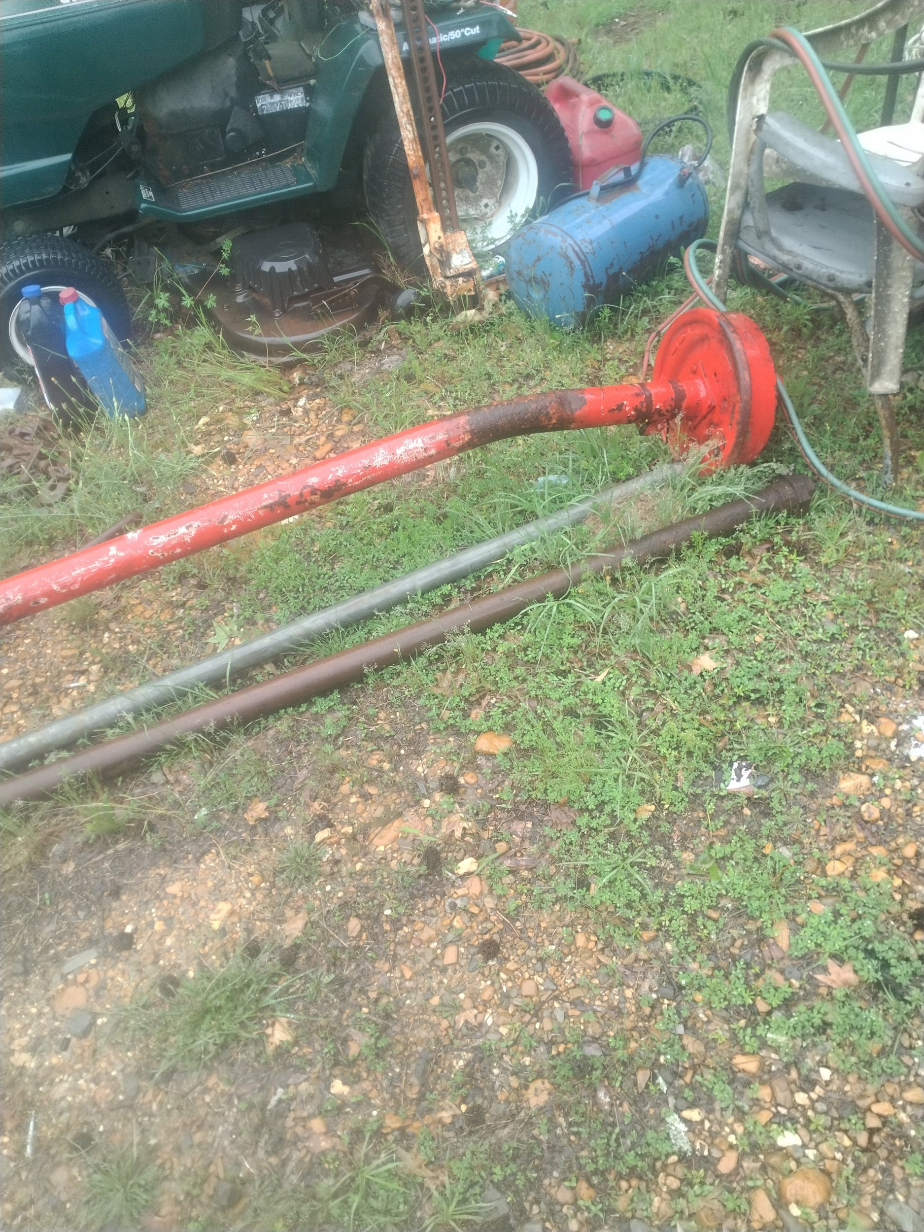

Yep, but you have to have something to bend it with. Or you could just replace the axle tube. Or look around for some used heavier axles and replace them. You can sell your original axles too. I plan on using this red axle.
