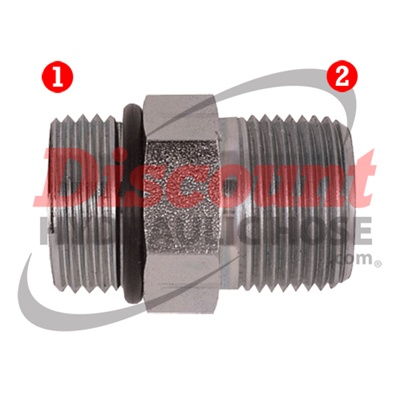

I purchased a BARE-co cylinder on Ebay and I'm not real sure on the size of the ports. I think it is an Australian company.
These are the specs:4"Bore x 18" Stroke
Shaft Diameter 2"
Closed Length 28 1/4"
Pin Diameter 1"
Ports 3/4" UN O-Ring
Working Pressure 3,000 lbs
Is this the same as an SAE 8 fitting?
I got the cylinder brand new for $97.00 including $40.00 for shipping, hopefully I can find the right fittings. I plan on using it to add a boom pole to my 3pt trailer mover.
Thanks, Matt

Perhaps this. Straight thread ORB to NPT.

I found BARE-Co's website. They have an office in Sacramento but do not sell directly to customers. They have an adapter PN B3440 which isA 3/4 UNO toB 1/2 NP. I have to fill out a parts request and then they forward it to a dealer. Maybe one of the hydraulics guys on TBN handles BARE-Co? Here is a pic of the adapter.

That's a common-as-dirt fitting that you shouln't have to jump through hoops to find. Baum, Surplus Center or any local hydraulics shop or reasonably well-stocked equipment dealership likely has in stock at a nominal cost.
/ Fitting size #6
In your private message, I thought you were looking for female thread on the NPTF side. If you actually want a male thread, then the photo JJ posted is of the fitting you want. 6401-08-08 on our web site. It is a pretty common fitting. You can order it here O-Ring Boss (ORB) x Male Pipe NPTF) Adapter or you can probably find it a local hydraulic repair shop.

Neither had I. Until yesterday, UNO was just a card game to me. :)
Seems people make up their own names for things all of the time. I did some sleuthing on the Bareco web site, and determined that "UNO" was some kind of shorthand for UNF thread with an O-Ring. I already knew that SAE.ORB fittings all use UNF thread, so it was an easy leap to figure out what they were talking about.

My cylinder arrived yesterday. I picked up a fitting @ TSC for a test fit. The fitting says 1/2 male o-ring to 1/2 JIC male. The threads are 3/4-16. It fits. I am assuming that the "male o-ring" side is an SAE 8 going by my surplus center catalog. The JIC also threads in but I know it does not have the correct seal type. If I am correct in calling it an SAE 8 all I have to do now is get my list of goodies ready and figure out my lift pole attachment for my trailer mover. Thanks for all the replies, Matt

Here is the chart I use: Fluid Port Size Charts > Discount Hydraulic Hose.com
