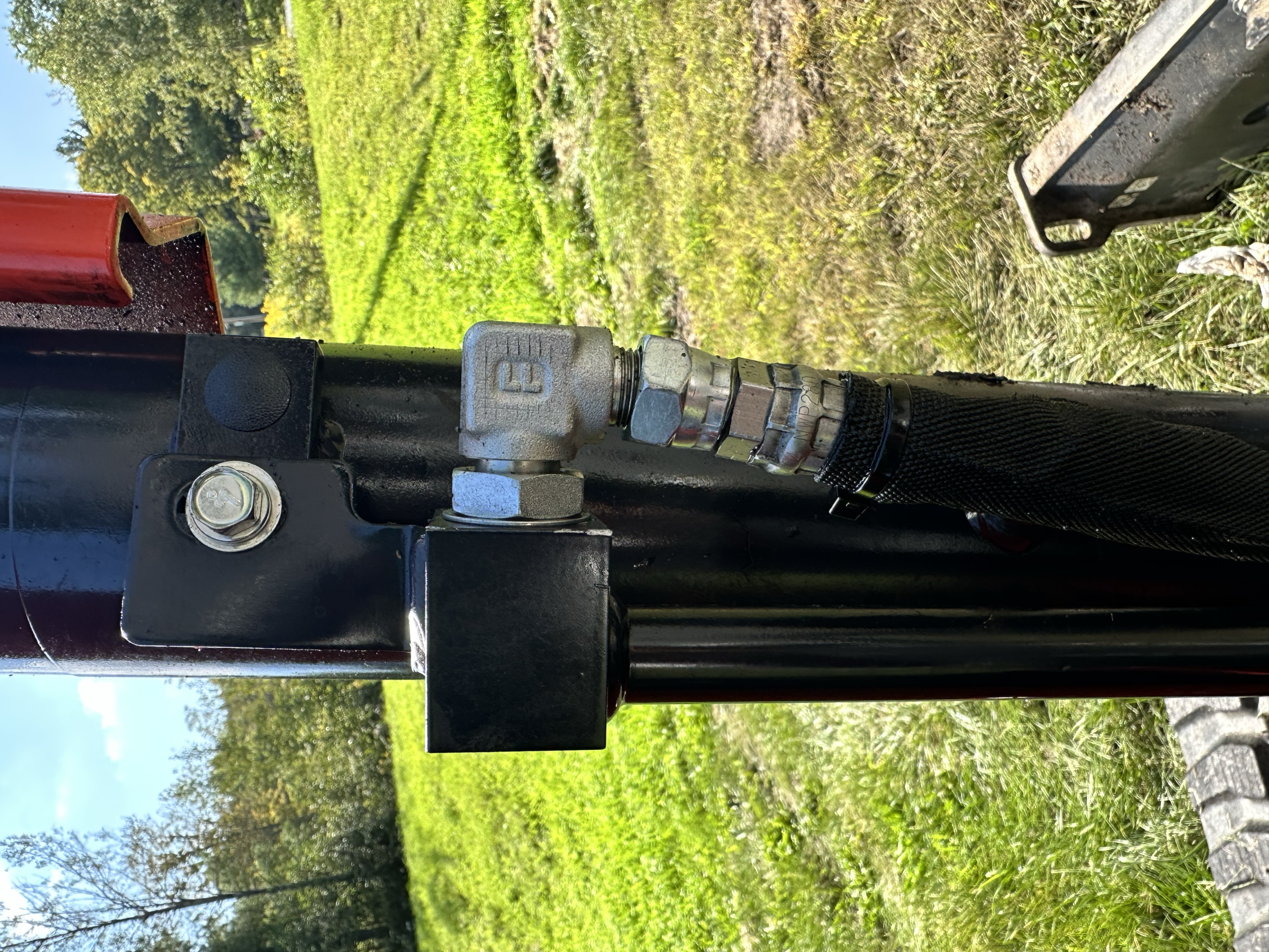

This elbow fitting is on the boom cylinder of a Kubota KX040-4. At first glance one might think it's -10 ORB to -6 JIC...But it's not.
The hose fitting looks very similar to a NPTF, but the thread diameter is not the same. Most of the hose ends look like they attach to strait thread pipe.
Similarly, the threads on the O-ring side measure .88".
I can't match it up with any standard adapter on Hydraulics Direct (or other).
Does anyone know what standard Kubota uses? JIS? BSPP?
The part from Kubota is $87!! An equivalent ORB to JIC is about $6. Does Kubota do this intentionally?
Thanks in advance.

Looks like BSPP to me. If you pull the hose, you should see a female and male 60º taper. If it's BSPP, the female taper will be on the elbow and the male taper will be on the hose side of it.
As far as pricing goes, well the rest of the world pretty much adopted metric and BSPP fittings. They're are common and cheap there. Well, not the Kubota part exactly, that's expensive everywhere.

Would it make sense that the side with the O-ring is an ISO Metric M22x1.5 and on the other end a -6 BSPP? M22 male threads are .87 (I measured .88. It's definitely a straight thread, and the "cone" is female inside the elbow and Male on the hose, similar to a standard US "pipe" hose fitting.
/ Can anyone identify this hydraulic fitting? #4
.880" is too high for a M22 thread though. Also, on that style of fitting (90º adjustable as they call it) I don't think they make it BSPP to Metric or vice versa. Only BSPP- BSPP or Metric- Metric.
We don't really use "-06" but rather 1/8, 3/8, 1/2, etc for hoses and fittings sizes.
Here is a good chart for the thread dimensions of BSPP thread. May help figuring out the exact sizes. BSPP Whitworth Pipe Thread DIN ISO 228 (DIN 259)

Ya, but the closest is 5/8, which has a major thread diameter of .902. Argh. I can't imagine Kubota makes up their own standard.
/ Can anyone identify this hydraulic fitting? #6
I don't think so either.
Then again, could be an entire different thread too.
Checking dimensions for the ORB fittings and the .880" you measured matched the -10 (5/8) fitting.
This guide may be more helpful as it includes all the other threads so it's easier to compare: https://cdn.shopify.com/s/files/1/0068/3235/7429/files/Thread_Identification_Guide_Trimantec.pdf

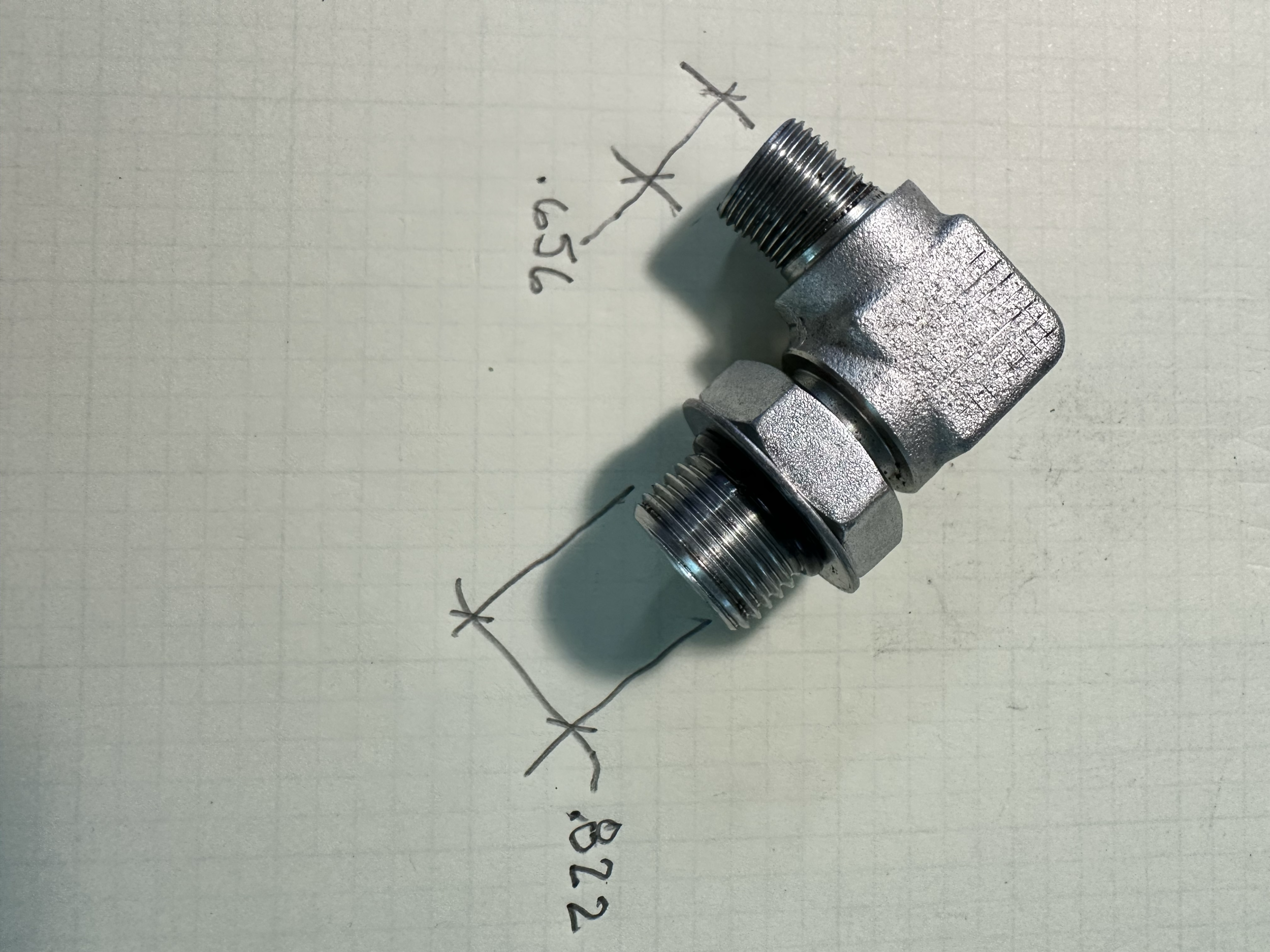

The plot thickens. See photo. The O-ring side does screw into SAE -10 O-Ring port...but it's loose in the threads.
The other side is straight thread. I screwed on a -6 FPS female pipe connector and it goes on and tightens against the taper/chamfer. The threads/inch is identical with a NPTF and NPSM. I'm still not finding anything that matches this.
If anyone who is familiar with what standard Kubota excavators use, it might shed light on the dilemma.
Going by diameter of the threads alone, the small end matches BSPP -6, while the large O-ring end matches BSPP -10.
But I can't find a BSPP -10 with an O-ring flange/washer.

That picture really helped. What you have is a 3/8" BSPP to 1/2" BSPP 90 degree fitting.
Before, you mentioned the bigger thread was 0.880" which was too small for 1/2" BSPP but now in the picture you have 0.882" which is exactly 1/" BSPP and explains why the SAE-10 feels loose in there.
This should be it: 9052-06-08 | 3/8" BSPP Male x 1/2" BSPP Male Adj. 90°

Thanks very much! The only question I have is that the photos of that fitting show a strange washer holding the O ring. My fitting has just the washer backing up the oring. Think that matters?
/ Can anyone identify this hydraulic fitting? #16
You may need to take one of the washers on the new fitting to fit the style of port Kubota went with. I imagine the port on the cylinder has a small chamfer where the o-ring sits and seals.
Many of the ports where BSPP fittings are used, won't have that chamfer, so it needs the extra washer to seal properly.

Thanks for all the help. Price for that fitting is half of what Kubota wants for it. If I can just take the o-ring off the old fitting and put it against that washer, I think I'm good to go.
